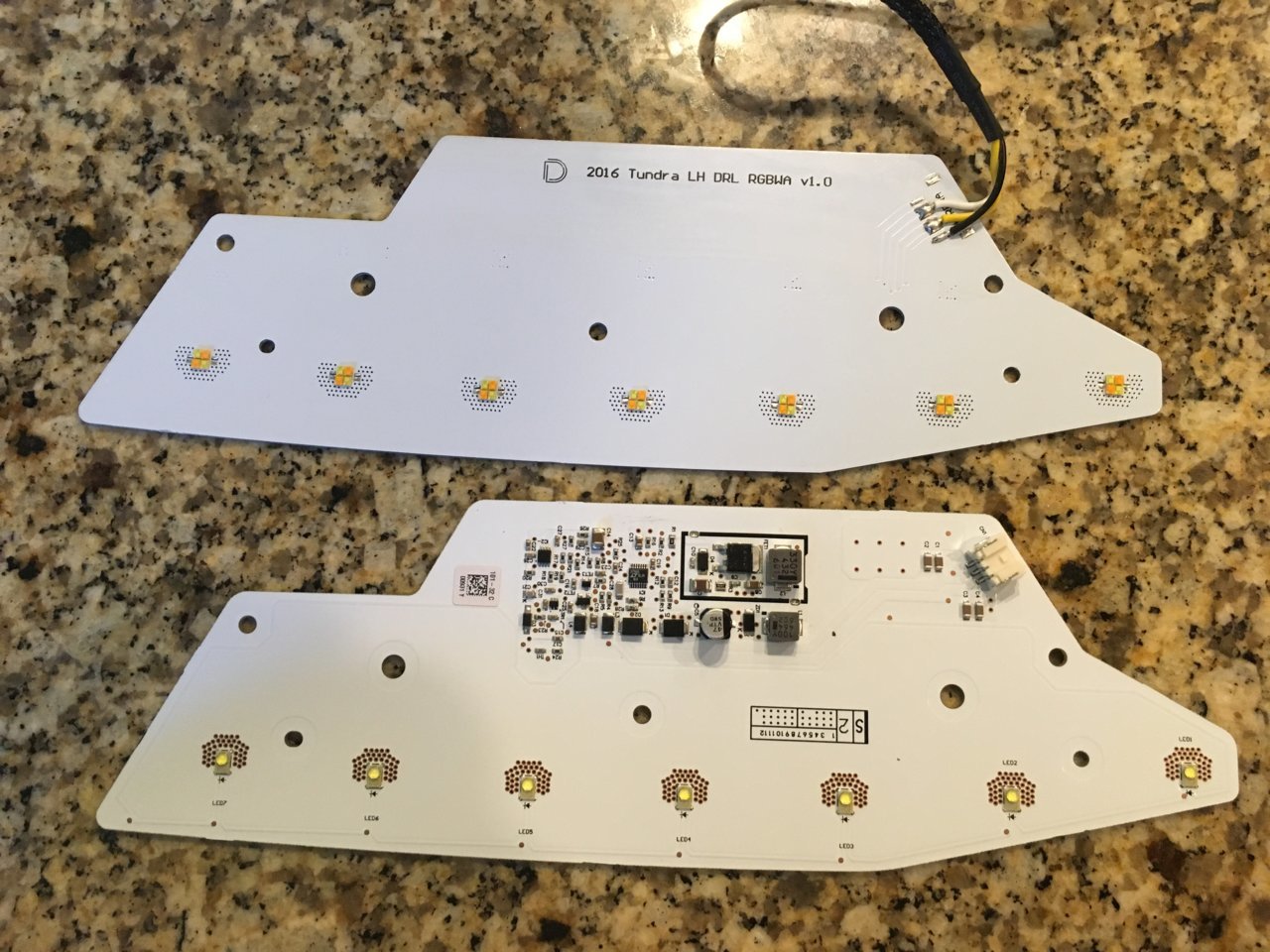

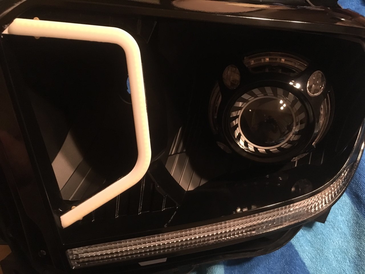

    The switchbacks are by diode dynamics and they run $300 for the hardware before shipping. I did my own retrofit install. They are not an easy install by any means. The turn signal itself doesn't have any 3M so you have to glue, tie wire or both for mounting it. Plus the backside of the turnsignal mount has the wires on it. So you have to drill and notch the stock reflector to make access for the wires and get the LED to lay flat. The switchback drl is only made for Platinum or 1794 headlights. There is another switchback drl option for non Platinum or 1794 headlights though.
    On the very top corner of turnsignal switchback LED there are three soldiered wires. You have to drill access holes through the plastic. You will also need to remove the plug to get the wires through without making a large hole.
    The top drl board is the diode dynamic. You can see four leds per location versus one on the diode dynamics versus the stocks one per location.

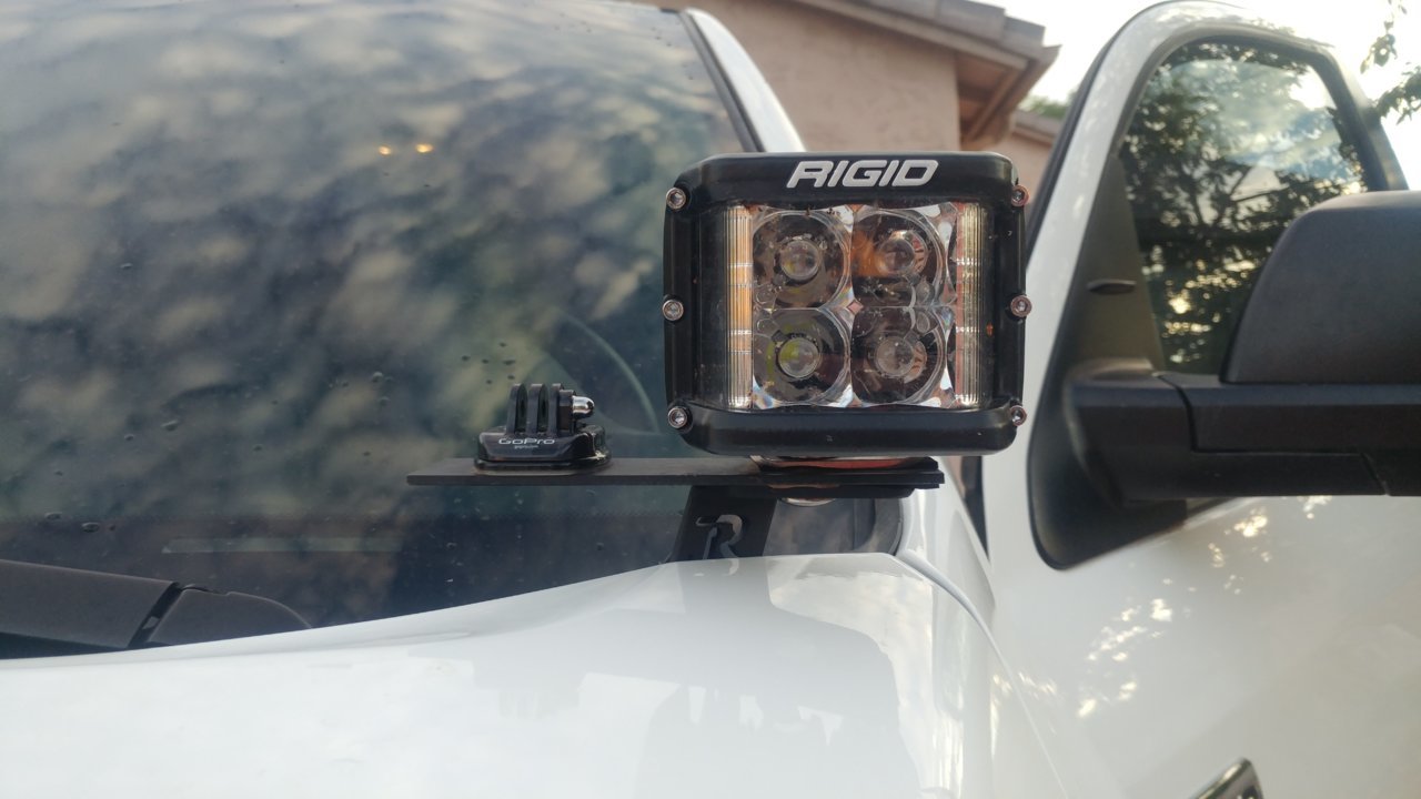

    Added a go pro mount to my Rago a-pillar mounts,

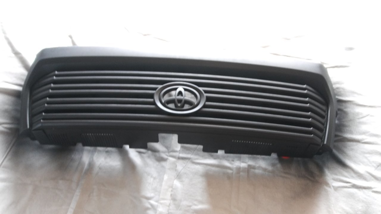

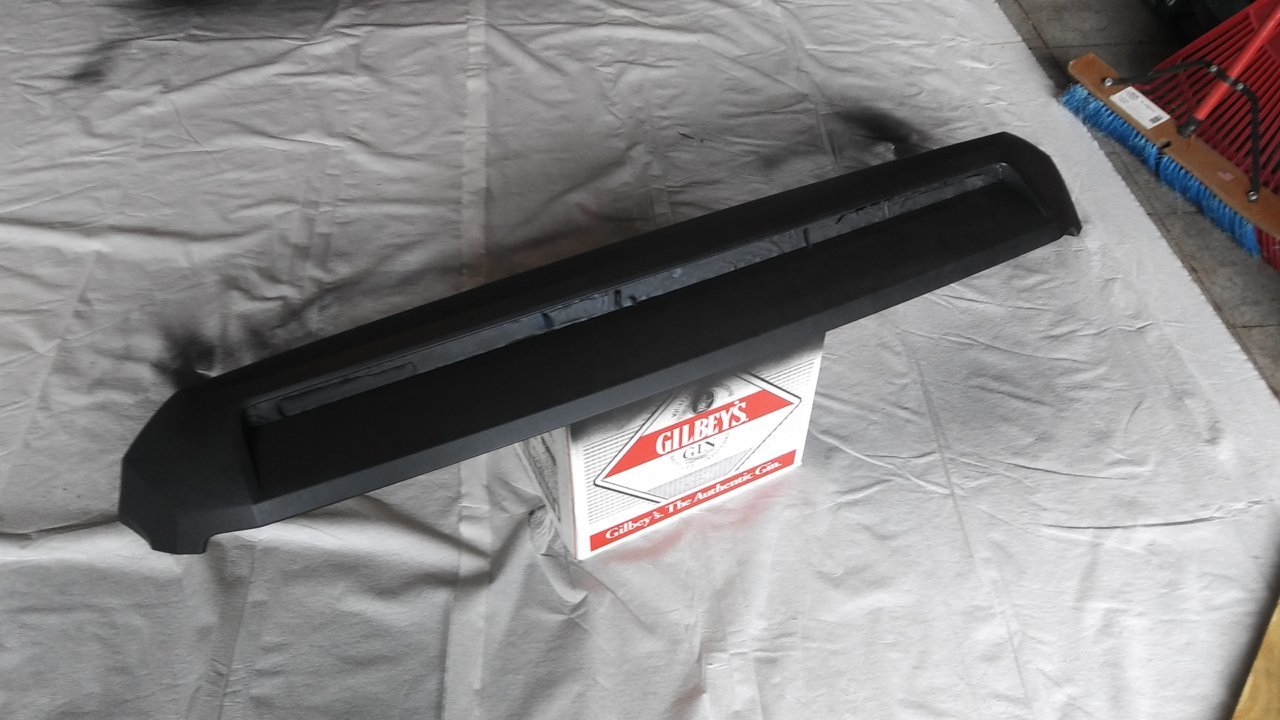

    The chrome delete battle rages on.20170718_133139.jpg 20170718_133145.jpg 20170718_133129.jpg

    That's pretty clever.

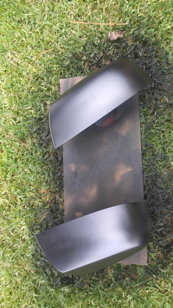

    Just waiting on the mirror caps. 6 coats blk 2 coats glossifier. Not as good as color match surrounds and trd grill but it'll do for now. Badges on port and starboard side left to blk out then all chrome will be gone. Plan on color match handles mirrors grill next year. Baby steps.20170718_181604.jpg 20170718_181525.jpg

    Where did you get the smoked lenses for your mirrors?

    Looking good. Don't use a power washer on it. I just learned that. :(

    Good advice. At least it isn't terribly difficult to redo.
