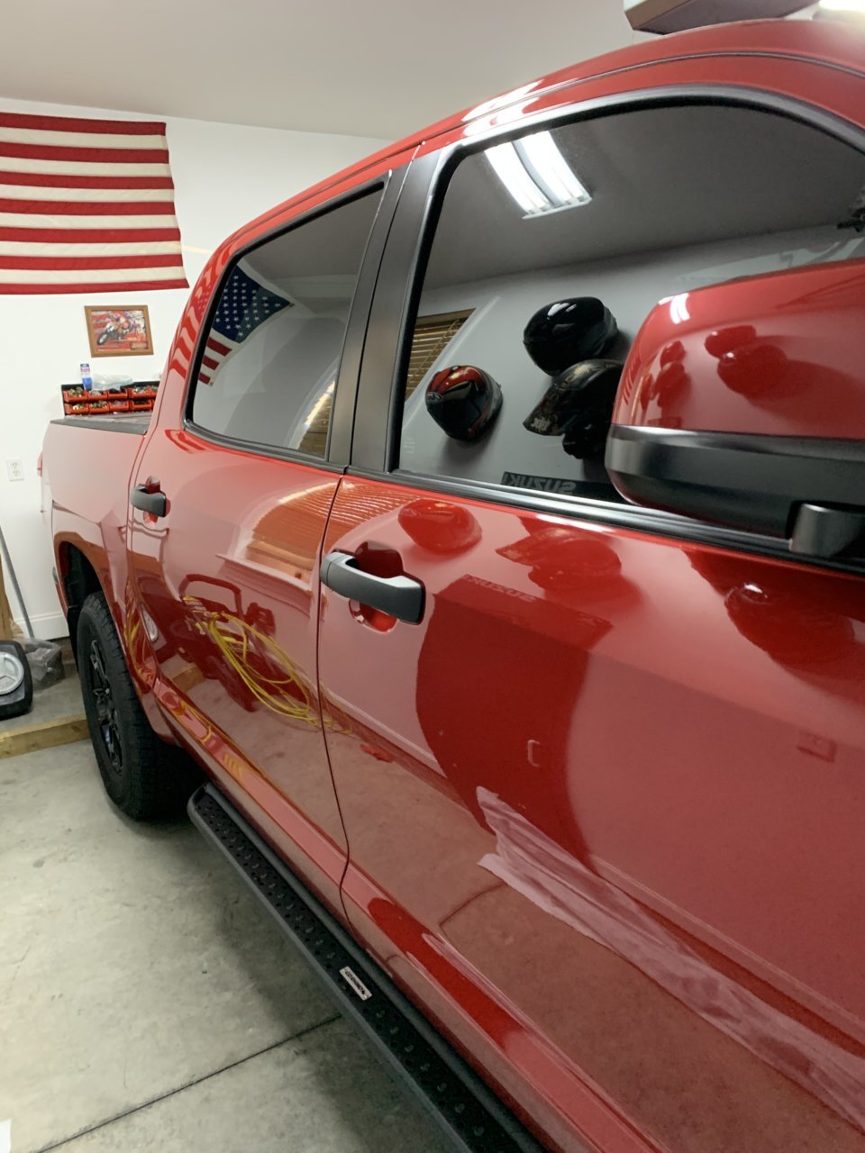

    You have a 2019 with ZERO door dings?!?!? Looks amazing!

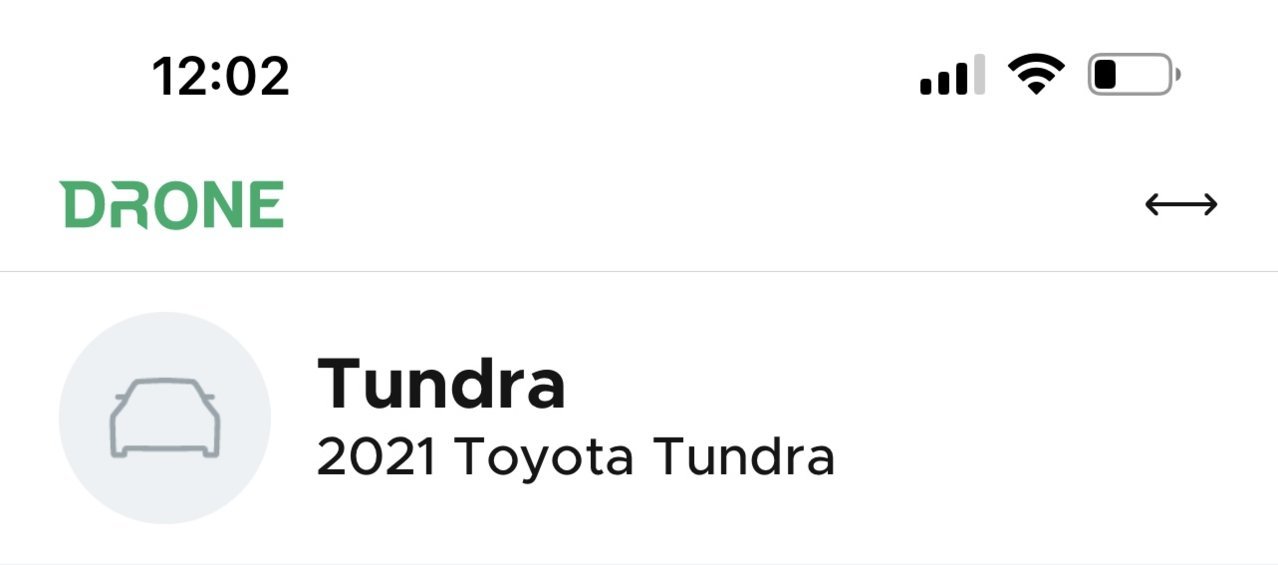

    Had DroneMobile installed today to ditch the shitty Toyota remote start.

    Thanks! Nope, no door dings yet!

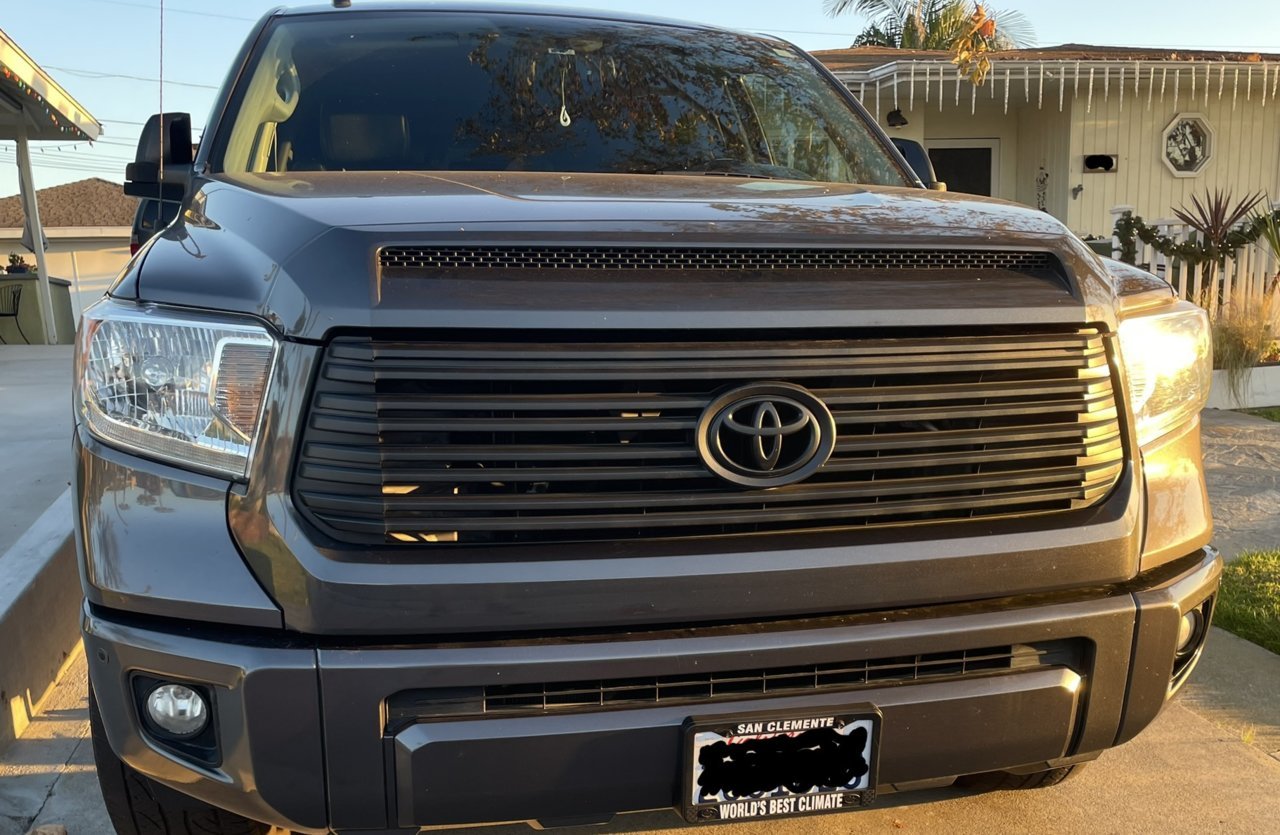

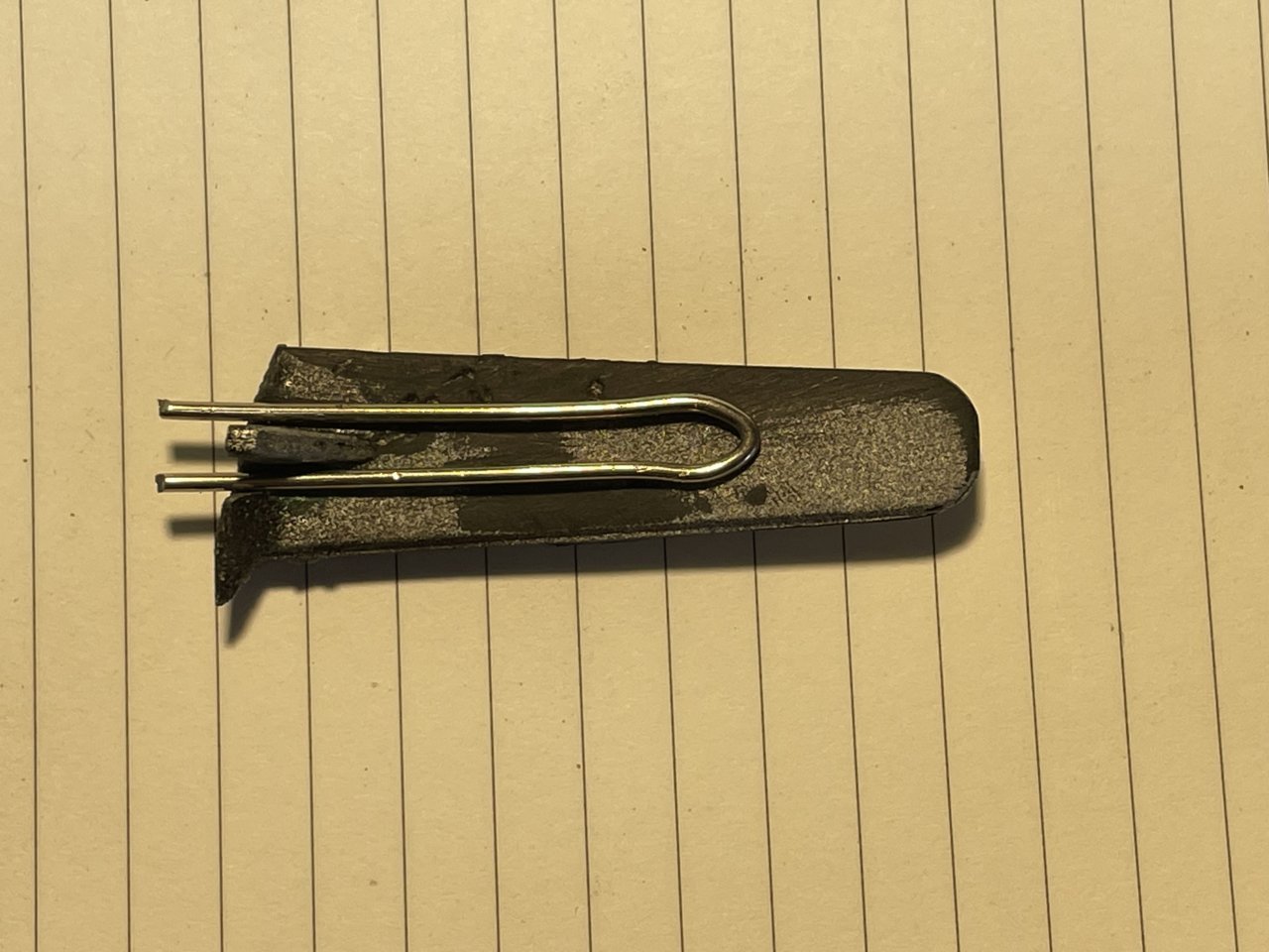

    Plastidipped my grill insert. 2015 Platinum. See other post about that.

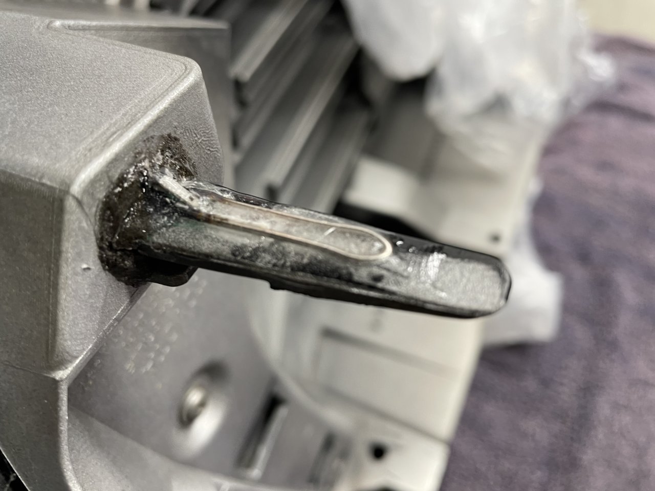

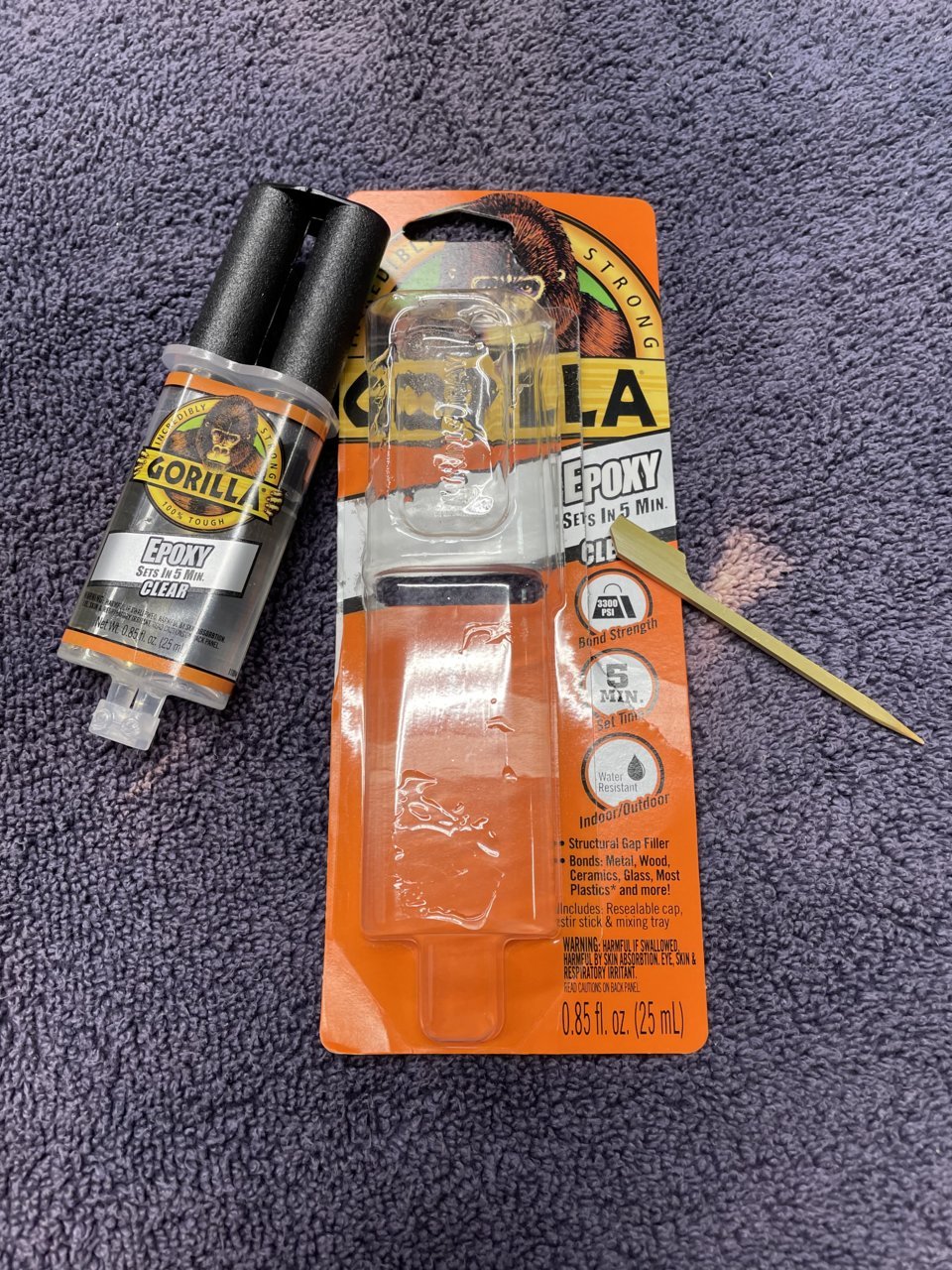

    Broke one of the large clips when removing the grill. Found fix on YT.
    Fix broken grill clip:
    Cut paper clip to size. Heat it up with lighter. Push in to the plastic a bit and it burns holes then hardens in place. Superglued clip to original location When dry, applied Gorilla Glue Epoxy to make into one unit. Worked great. Don’t plan on taking off the grill again, but holding well.
    DE0A6603-8FEE-40E9-AC7B-AD3D2353D9C9.jpg AD9B834C-F6D2-4C06-A529-EC2BF589FD17.jpg AEB3640B-FAFF-473F-9697-3D4ED53BCF1E.jpg DBC5E03C-8953-4F5C-8E09-B3CC86EC8FAE.jpg 8E1F3EE9-86C0-4DD5-BE16-8587A6C83CB7.jpg 1D1CA456-E94B-4F83-9C0A-495D75AC9CDB.jpg

    Yes, it's a good method, the paper clip, along with "plastic welding". Looks good.

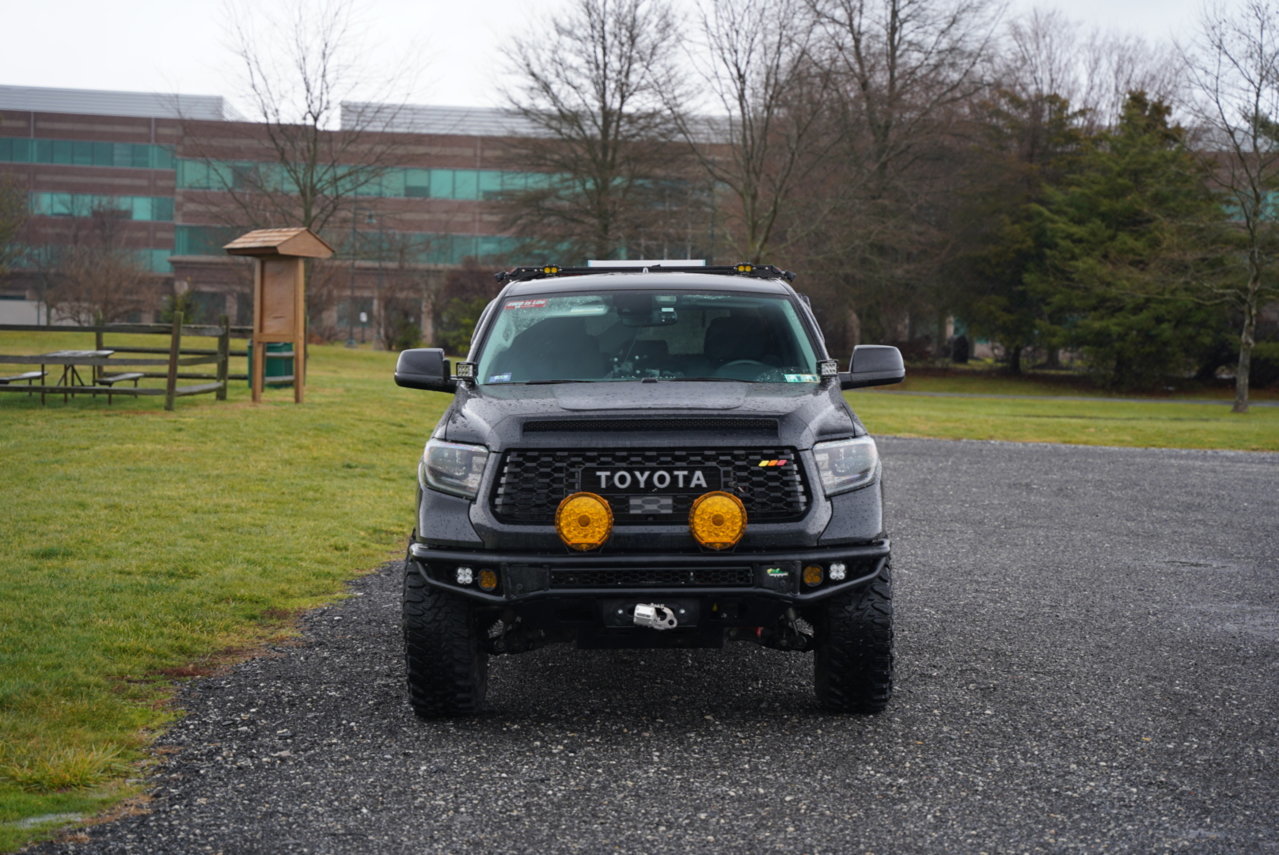

    Love the overall build! Have the same front bumper now too, and curious which fogs you're running and how you have them wired up?

    I tried to find the place where you can reach in and push down on these large tabs and gave up and pulled real hard and broke it. (I have a 2015, brittle I assume).
    For the next tab, I found a way to get my hand in to push down. Came out nicely.
    Try to locate the tabs and you can get your arm in there, at least on the 2015 Platinum Crew Cab.
    Also, for some posts I have seen that tab is just a guide so no issue pulling out. Mine has a step in it to lock it in place. Not sure what years or models are different.

    As with anything plastic, if you can do it in warm weather or in a warm garage, it's best. Plastic's more brittle in the cold.
