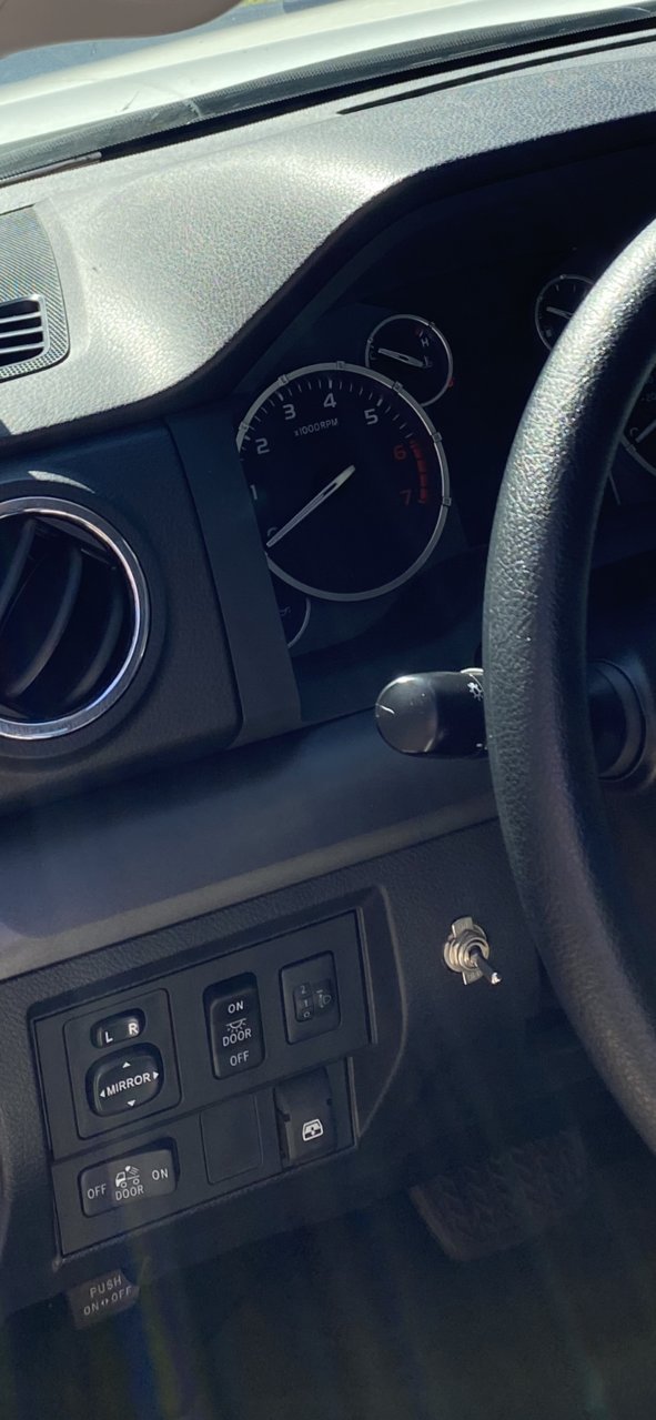

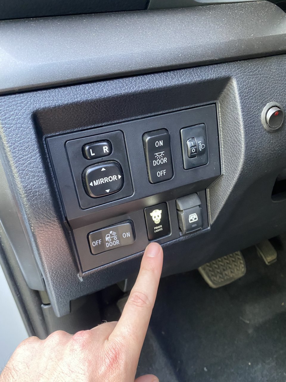

    Redid my 30” caliraised light bar
    my dad Installed it years ago after i put one on my Tacoma and said it hasn’t it worked in a while when I bought it from him.
    decided to look at it this morning. He used this toggles switch and the connections came loose.
    I wired it to an OEM style switch and plugged the old hole with a dummy switch I had laying around and fit perfect.
    38445351-9ADE-48ED-8D57-25344109A588.jpg 6FEBA585-9AEE-41B9-9741-6E29BD4523FB.jpg 621B63D9-230E-4C0F-A81B-23A694CB0EC9.jpg
    also got a spot ready for my BD S1 amber pods I’ve had sitting around

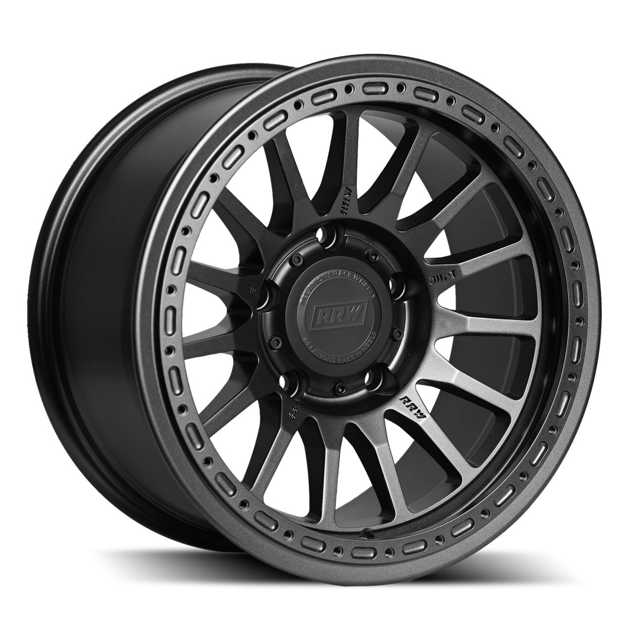

    Pulled the trigger on a set of matte gun metal RR7’s with black rings. I don’t know much about offsets but they were only available in a 0 offset so I hope that works well with my TRD sport. Still trying to figure out what tires and a leveling kit to go with.

    Zero offset means they'll poke out a fair bit. Varies by application but some wind up needing to do a BMC, but I would bet at the very least you'll be needing to trim/remove mud flaps and splashguards/air deflectors. Tire size at that offset will play a big role.

    shit… probably should have done my homework first. I’m looking to go with a 285/70/17 I think…

    Don't panic. I'm far from an expert. I just followed the general guidance that the "sweet spot" on these trucks for wheels is at about +25 offset, BUT that's only about an inch more tuck than what you're 0s are going to be. On 275/70R18 Falkens (run slightly larger than things like Nittos even if marked the same size) I had to remove the little splashguards under the front bumper and I have some very minor rub at full lock in reverse. You will probably have a little more molding/trimming to do, but these trucks are so individual that it might not be bad. I played it really conservative because I refused to do a BMC.
    A bigger concern would be whether or not those wheels are hub centric or lug centric. You want hub for the Tundras.

    And with 17s you have to make sure you'll have room for the brake calipers. Some 17s fit, some don't, and all of them require the balance weights to be placed where the calipers won't knock them off.
    Edit: I just saw the group buy on the forum here. I would assume that the organizer of the buy did their research and you should be fine on these and the hub centric concerns. Still, doesn't hurt to ask.

    their website says they are hub centric for the tundra.
    I’ve also heard that +25 is the sweet spot, which is what attracted me to the SCS wheels but the availability is so limited and I really like the multi spoke look and removable rings on the RR7’s. Also they are really light weight Fingers crossed they don’t stick out a unsightly amount… maybe I’ll have to get some fender flares.

    Honestly, with +25s I'm wishing I had gotten some low profile flares because of the rocks and such that have been kicked up. I have multiple self-inflicted dings because of the poke. I'd start looking for flares you like the look of now, just so that you know what you want if you decide to go that route.

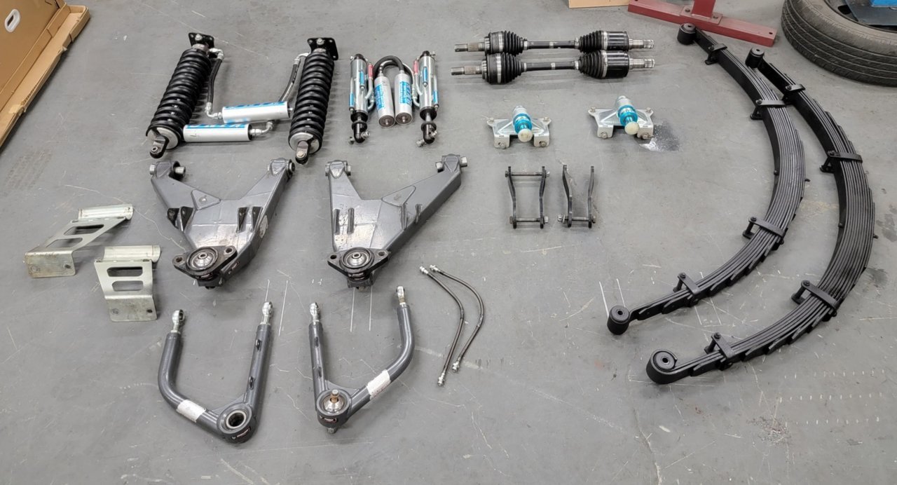

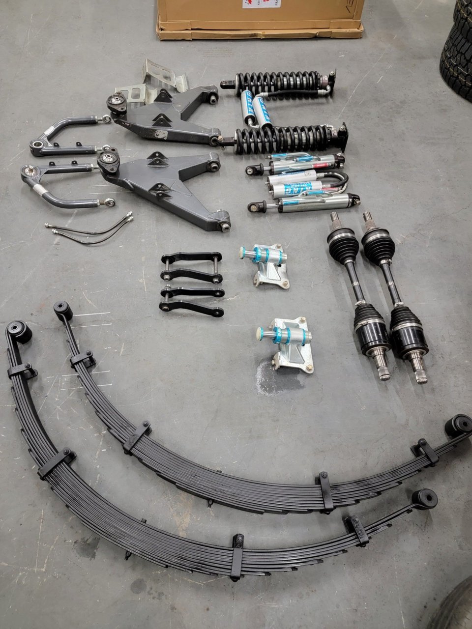

    Well I came across a deal that of course I couldn’t pass up. Hopefully get this installed second or third week of June if the timing works out. This means my 2.5 adjustable mid travel kings and total chaos upper control arms are for sale. I'll post a for sale feeler here shortly.
    Kit includes-
    Front-
    Camburg race series LT kit (Heim)
    Upper and lower LT arms
    King race series 2.5 black 8" LT coilovers
    King race series 2.5 black 8" Triple bypasses
    Lower uniball spindle adapters
    Steering extenders
    Extended Brake lines
    Limit straps
    Upper coilover shock mounts
    extended axle shafts already put together
    Total Chaos gusseted spindles
    Camburg dual bypass shock hoops, brand new in box.
    Rear-
    Deaver I96 spring under leaf packs
    King 3.0 16" triple bypasses
    King rear 2.0 compact bump stop kit (pair)
    Total Chaos rear LT spring under shackles
    Brand new Camburg spring under axle perches
    Custom bedcage

    DAMN! Look at those leaf springs!!!

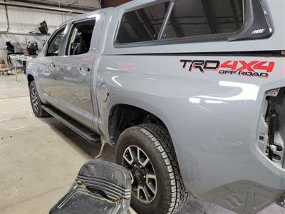

    Someone else is working on my baby. I want to be excited it’s getting fixed, but makes me cringe a little anyway

    Damn nice LT setup
