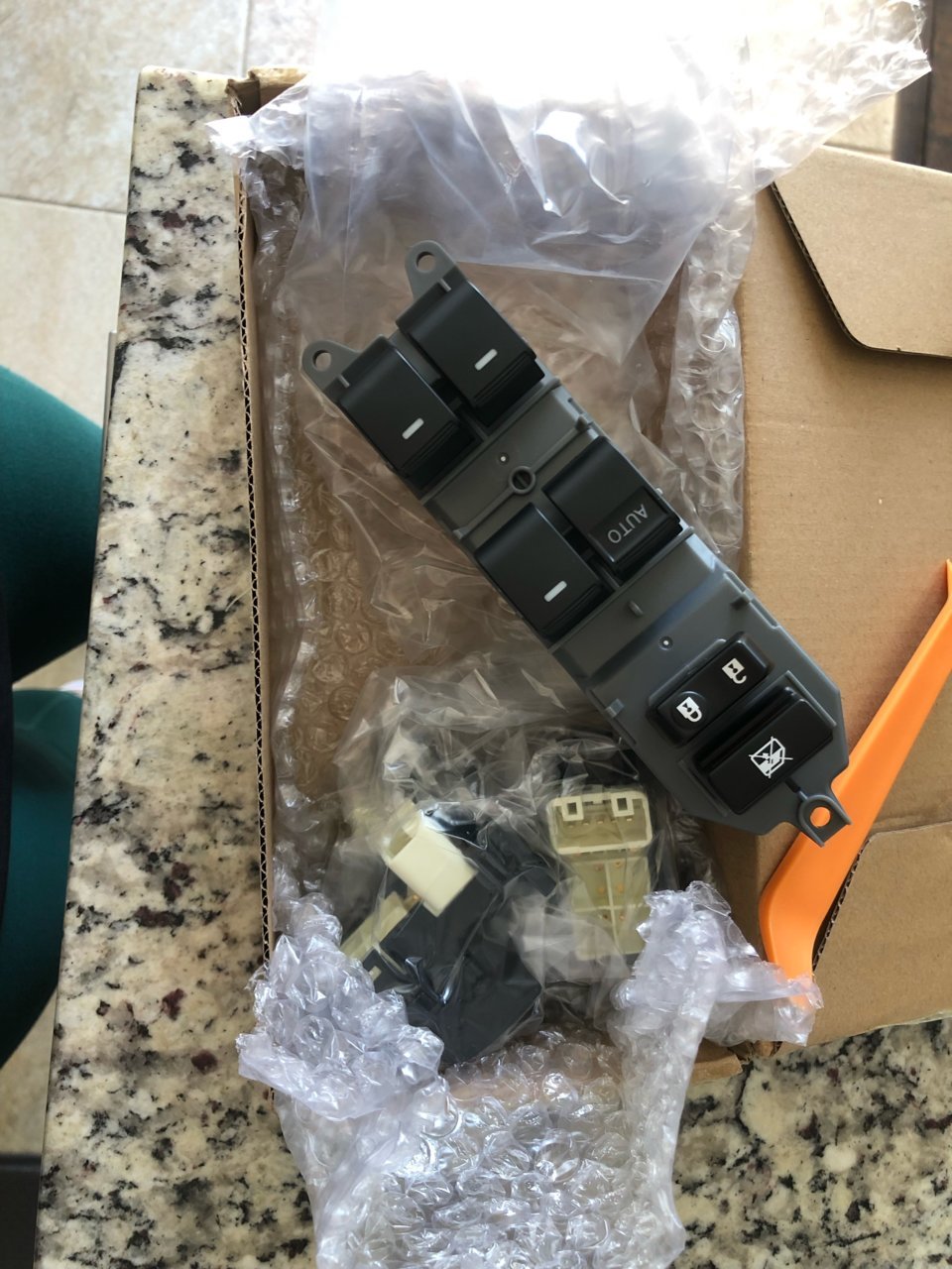

    Yes. They light up. They have a few different color options.
    https://cartrimhome.com/LED-Power-Single-Window-Switch-for-Toyota-TUNDRA
    note: you have to buy both driver and (3) passenger door switches
    Edit: I see now they have a drop down for all of them. Last week they didn’t
    @TundraTXTSS
    Just saw your post
    no instructions but I just pulled up the switch panel with my fingers. Disconnect the wiring harness and swap.
    the driver side has three screws to swap. Also 4 clips 2 per side
    the 3 passenger has two clips each. One at the top and one at the bottom

    So do all 4 door switches light up or just the drivers side?
  10. Apr 2, 2022 at 3:33 PM
    Taco-Spike
    Apr 25, 2021
    #62293
    4,666
    512
    Two Trucks
    All four

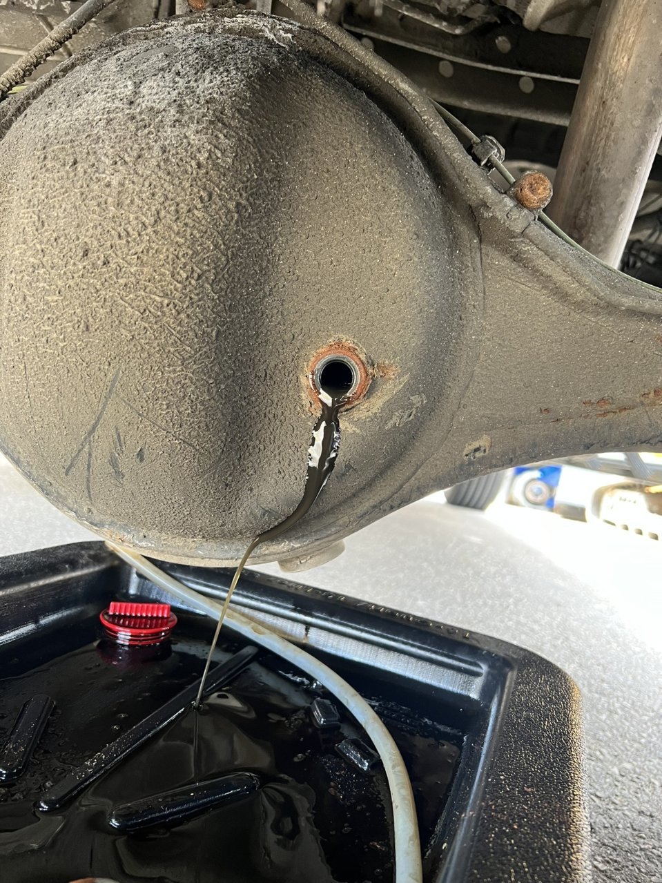

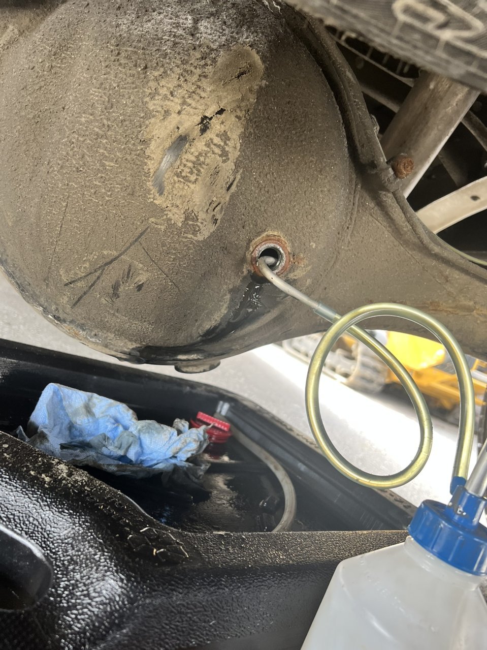

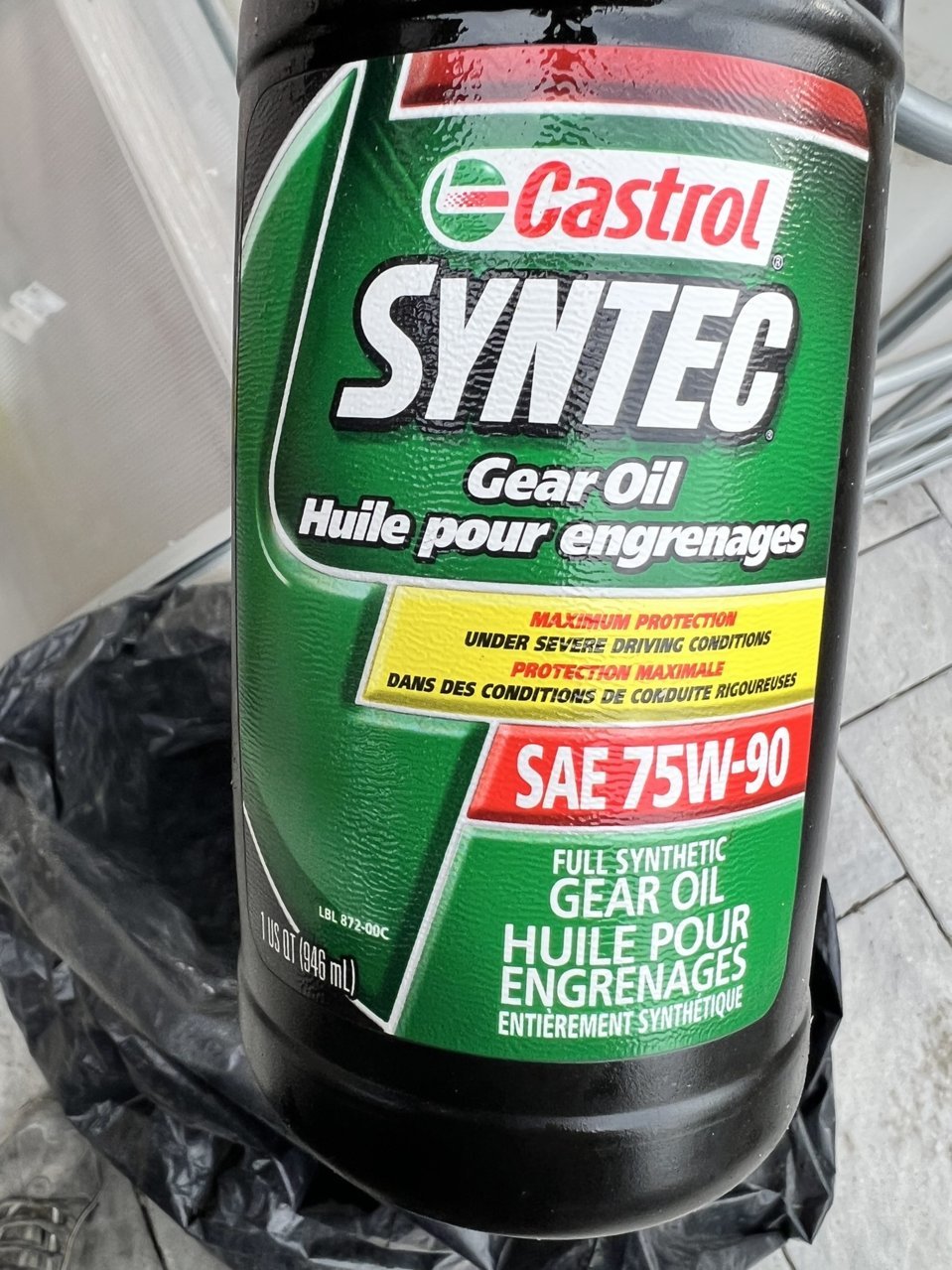

    32000 miles and first differential fluid change. Man, this Canadian road salting sucks. Washed the truck yesterday and there is still salt all over
    . The truck was undercoated hence the grimy looks all over. Gotta work on the dozen rusty bolts down there underneath in summer.IMG_0950.jpg67062222776__7CDCC97F-06A0-40C5-9246-F47A51364F15.jpgIMG_0954.jpg

    No fun at all. Gear oil smells horrible.

    So all 4 are plug and play? Any pictures of the other doors?
    TIA.

    Plug and play.
    waiting for the darkness :spy: for pics

    @zasdds just installed these and was having problems with the doors locking with the FOB.

    I saw that. I did test everything and fob. I’ll see how it goes. I also think they had it installed for a while before that issue if this was the culprit. Time will tell

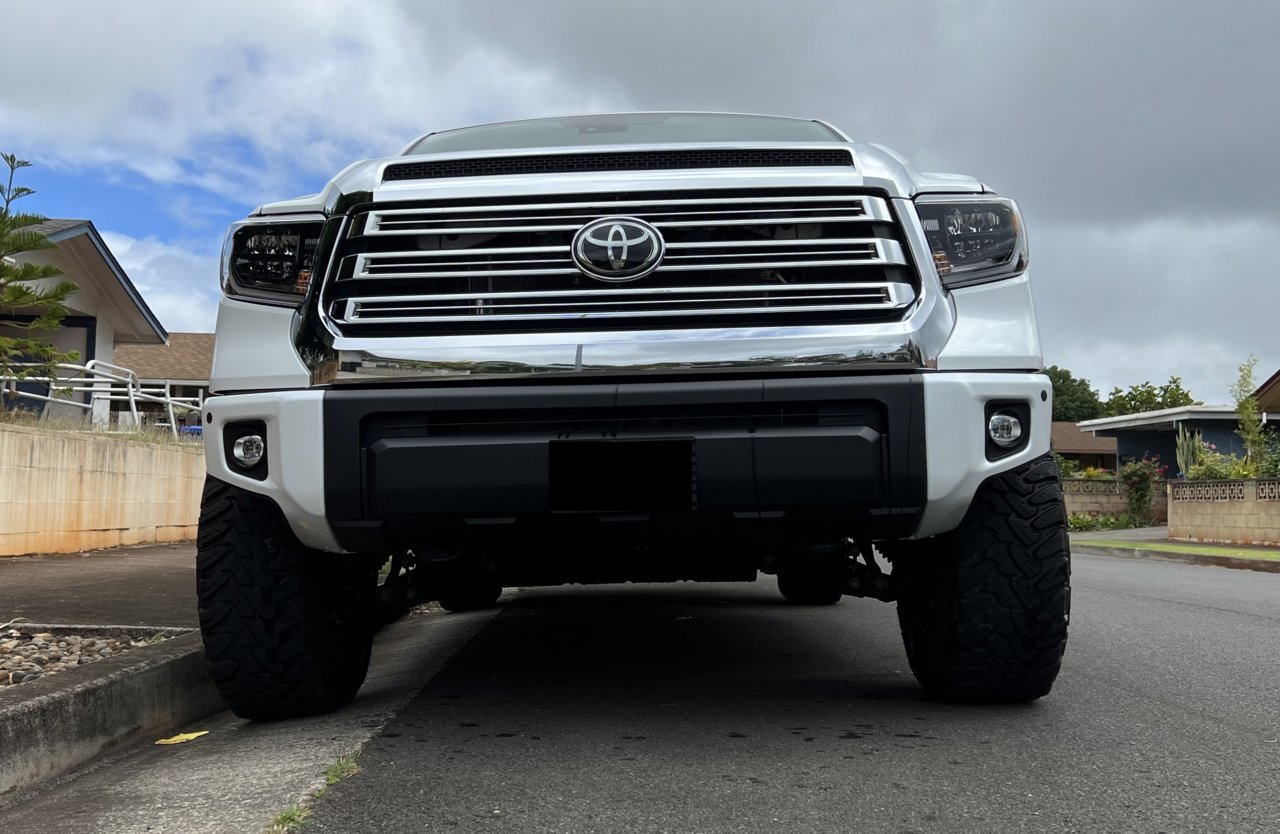

    I put my RC grill in today. It wasn’t hard. Just a little time consuming. I seen on one of the threads I was looking at a guy put a Toyota emblem on his aftermarket grill. My wife and I liked that look. I like a little bling on my truck. But not to much. I do want get amp research steps. EEF3A347-8A10-4178-B195-B207DF12DDFC.jpg

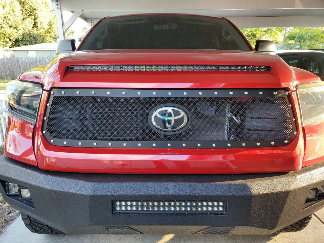

    I hope your grill works better than mine. I took it back out. I had alignment issues and it was breaking the mounts on the surround. Right now it's in a box in the back of the truck. It looks descent in this pic but it wasn't fully installed yet. It was off at the bulge and the headlight trim panels. I tried everything to fix it.

    Dude, you nailed this mod. Well done!

    Yes, the gaps aren’t perfect. But you gotta look to see them. I would like the gap between the grill and hood be a little closer.

    Mine was obvious that it was off. Total waste of $800

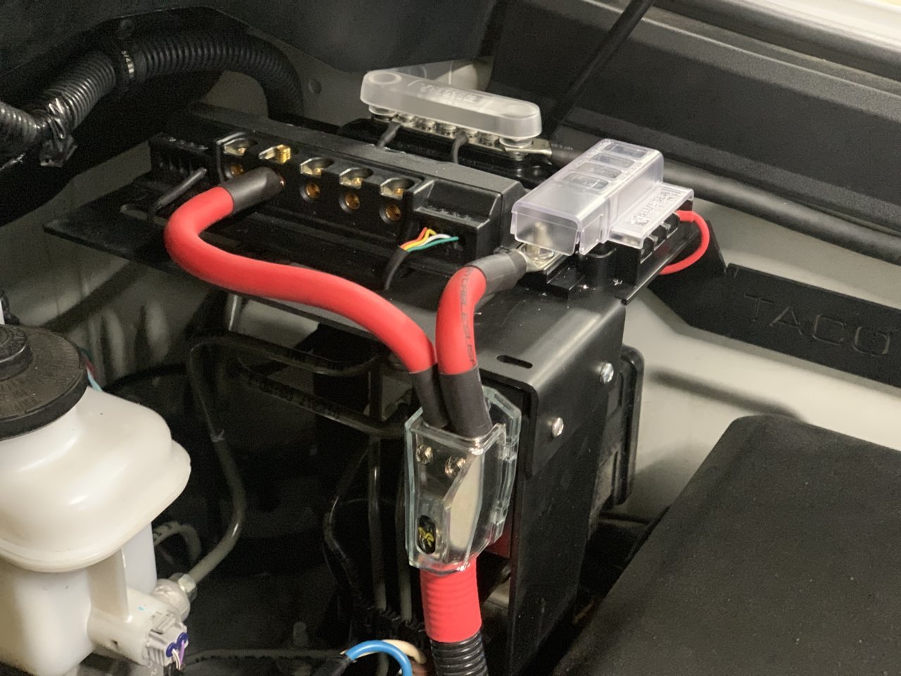

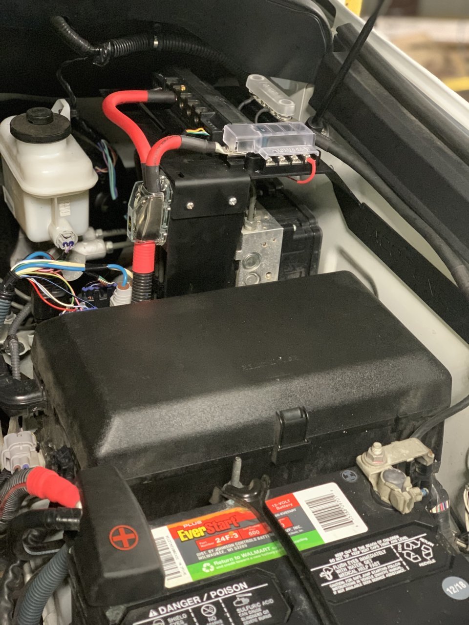

    Got a little wiring done today. Stinger switch hub will handle four channels of switching and protection, blue sea fuse block and ground buss for odds and ends, all mounted to the taco tunes plate. 100% soldered and hear shrunk. My wire is oversized as always, but there is 200 amps of possibilities there, so why not be prepared. Now if my bumper will come in, I can mount my 20” light bar and start buying more stuff. I went ahead and ran a 6 conductor in the cab, 12v, ground, and four to be used as signal wires, tucked in the kick panel for later use.

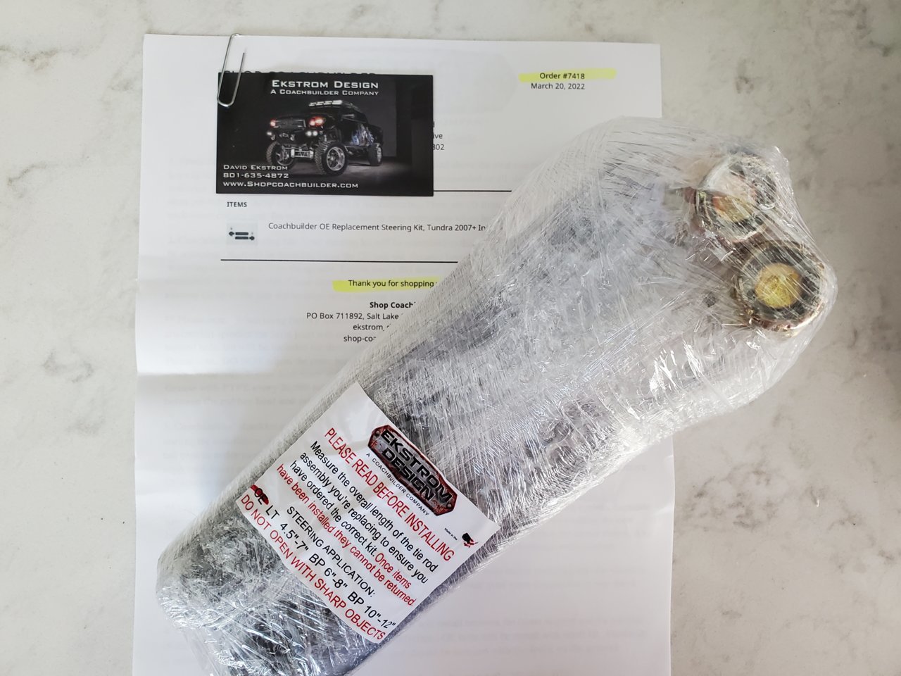

    Received Coachbuilder tie rod ends this afternoon. Hopefully I can get them installed and an alignment done on Tuesday.
