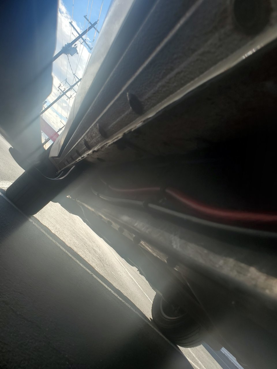

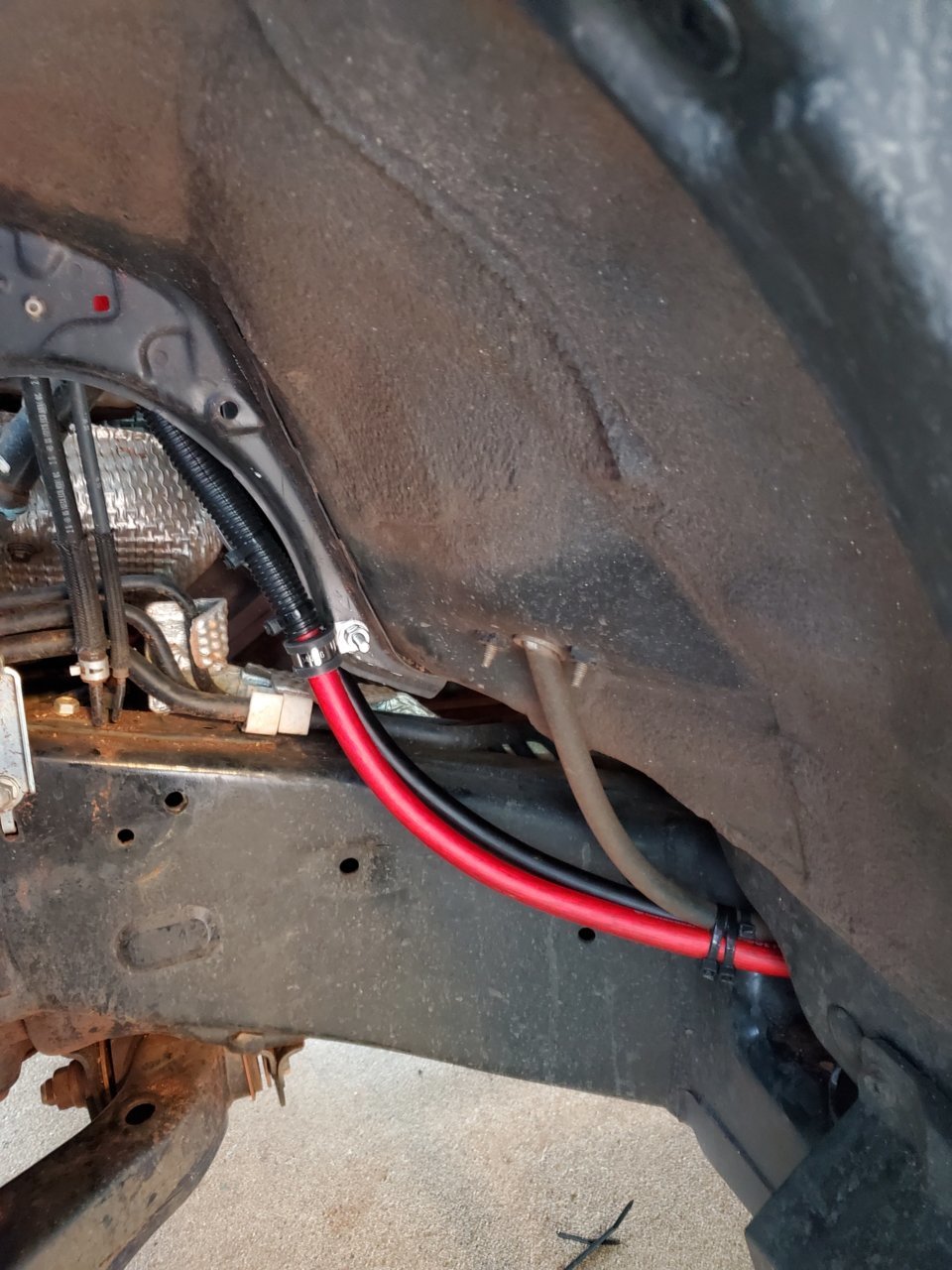

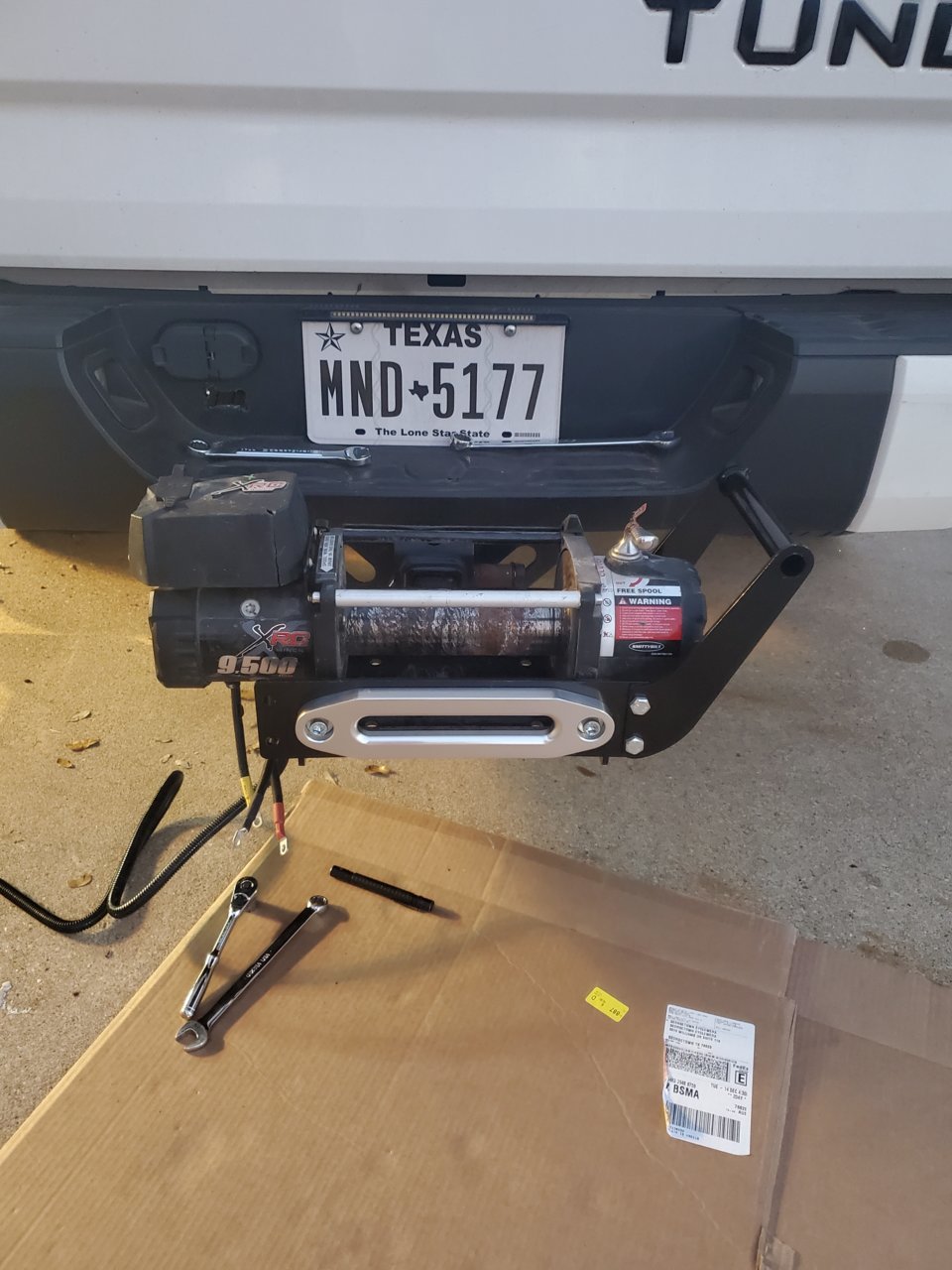

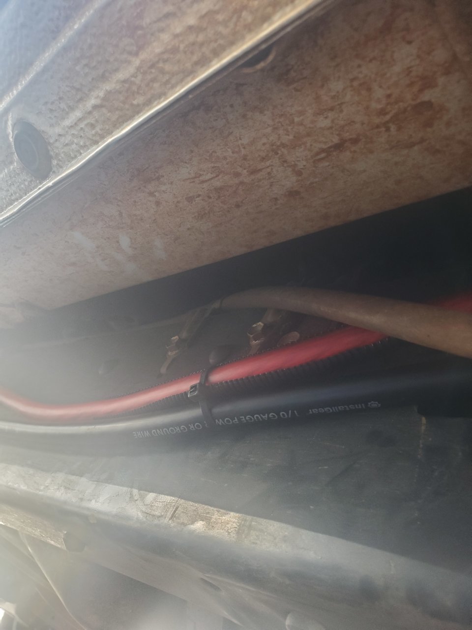

    So what started with a free winch assy, ended up with this type of install. Going over board should be my middle name. Of course the fiancé is asking why am I doing all this, so I explained it all to her, and she replies "So you're just playing?". Yes dear, that is correct.
    Test fitting on its new support bracket, after removing the nasty steel cable that was on it. New synthetic line on order

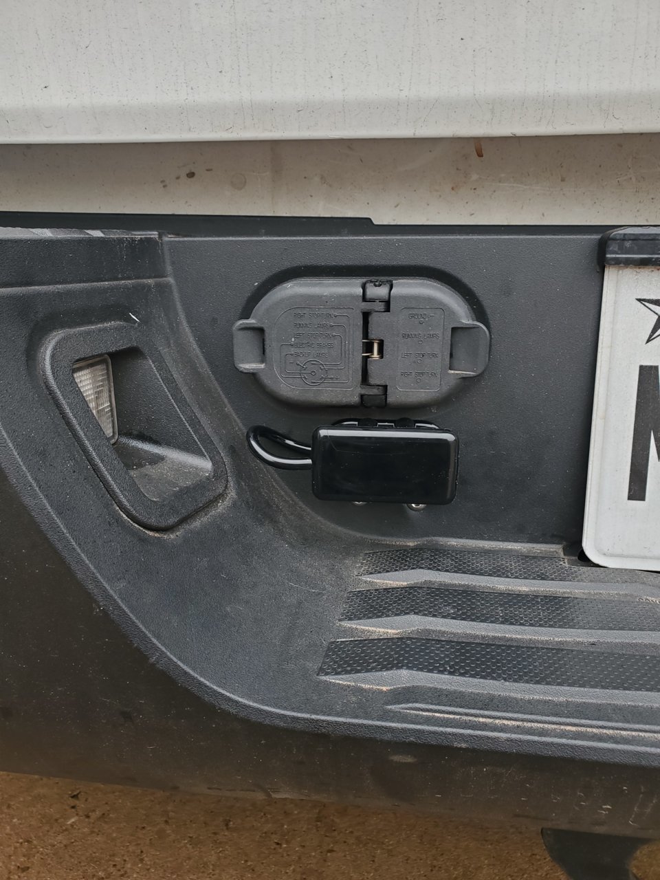

    Gonna need power back here:
    With easy quick connects, the winch will have this also, and I will add them to my jumper cables.
    Wiring coming up to the battery. My plan is to hook up the negative cable, leaving the positive one unconnected till I need it, then just bolt it on in a minute or so. This makes me feel better about something taking out the wire while I drive, or if I get rear ended.
    Wiring coming down the firewall to makes it's connection with the frame. Fender liner splash removed in this photo, was able to use that stud as amounting point for it with another flat washer and nut to hold it in place.
    Wires mounted along the frame
    The wires as they made their way to the underside of bed then onward to the rear bumper
    Yes I am using some pretty big wires to feed back there, once I started looking at the amp ratings of the winch, I decided to go big or go home. I feel pretty confidant that I can run this winch or any other one with the amount of power I can handle.
    23 feet each of red and black 1/0 wire
    20 stainless steel with rubber protectors
    12 stainless steel bolts, nuts, washers, lock washers
    2 sets of batter quick connects 1/0 terminals
    Shit ton of zip ties
    And roughly 15 hours into it so far.

    Are you mounting it to the hitch? Will it be removable? That's going to be some impressive fab work if this is the case. Looks like a great project. :thumbsup:

    No that's one of those hitch mounted winch brackets you can get anywhere. The one I got seems super stout and should work just fine for the few times it'll get used

    I bought a quick connect kit that had 4 ends in it, along with the metal connectors., then I bought 25 feet of wire in each color. And also bought cable ends to mount on the battery.
    So not really a kit. Parts and pieces. Some I bought, some I had on my xmas lists that family bought for me. Seems to be working out fine. I did think I was going to go with a 4 gauge set up, then looked up amp draws for the winch, decided that would be too small. So I did return a bunch of stuff :(
