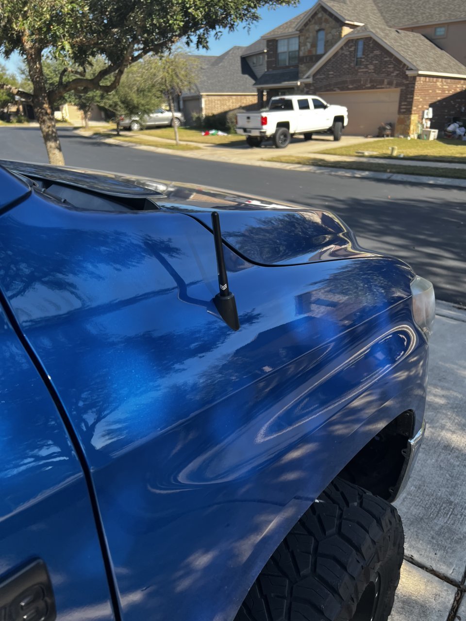

    Have a link for that antenna?

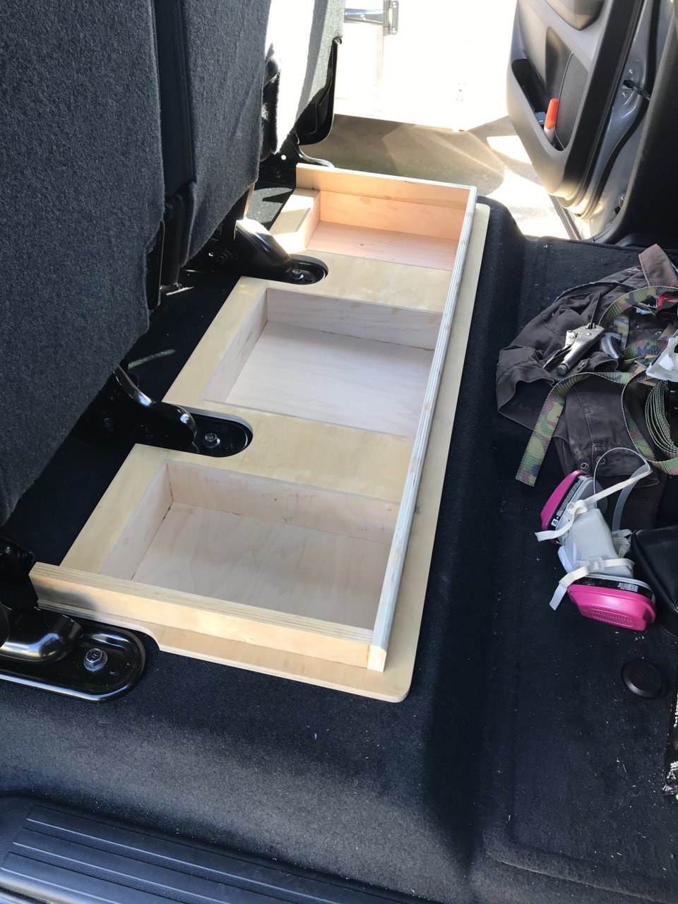

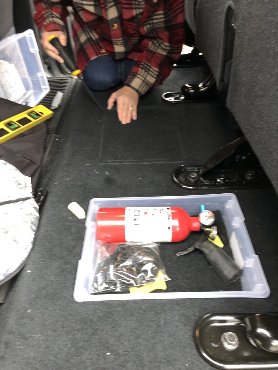

    Power steps, tonneau cover, blacked out badges, custom under rear seat storage, mirror covers, 2017 Trd pro color matched grill, plasti-dipped rims and bumpers. Trail grid pro FRAC, Start-x remote starter, Loncky leather steering wheel, leather shift knob. Painted cup holder-gear selector trim. Desert eagle off road cat shield, skid plate. Yitamotor floor mats. Calipers painted black. Kenwood amp, pioneer dash tweeters, infinity rear door speakers and tweeters. De-badged, Trd rear sway bar, ham radio antenna. Half console safe. Kenwood DMX1057XR. CDT 6x9’s. Sound deadening on doors.
    Lin-X is another option, thanks.

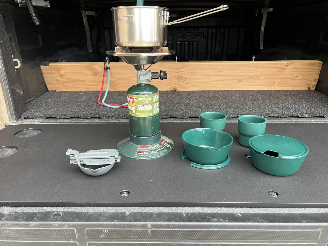

    Installed the Mountain Hatch today and it’s a beast. Ready for the next adventure!!C02679AB-182C-41AB-834E-AFCCDE0ADA4C.jpg32400159-113D-4711-9D96-EC19549A4756.jpg

    I assumed all the DC trucks had under seat storage because my truck came with it.

    CrewMax does not have the underseat storage....

    Crewmax has 4” of carpet covered foam under there instead. Super useful.

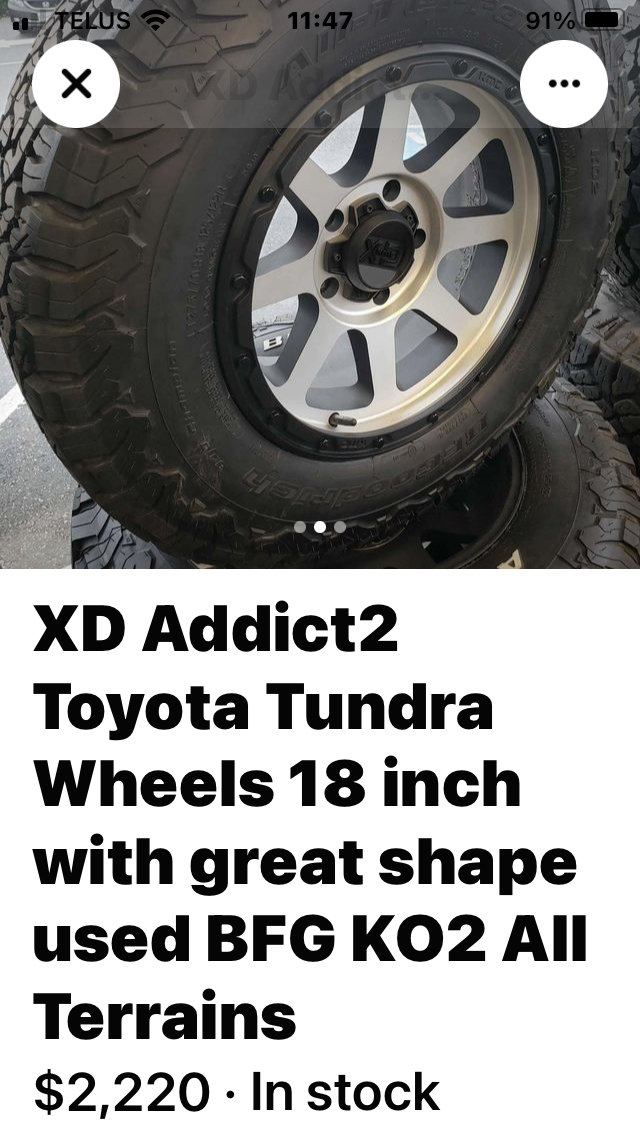

    For what it is worth, I steer away from anything BFGoodrich that is used. They wear unevenly in my experience.

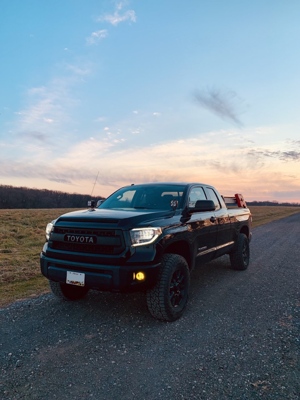

    Installed SS3 fogs and a Rotopax.

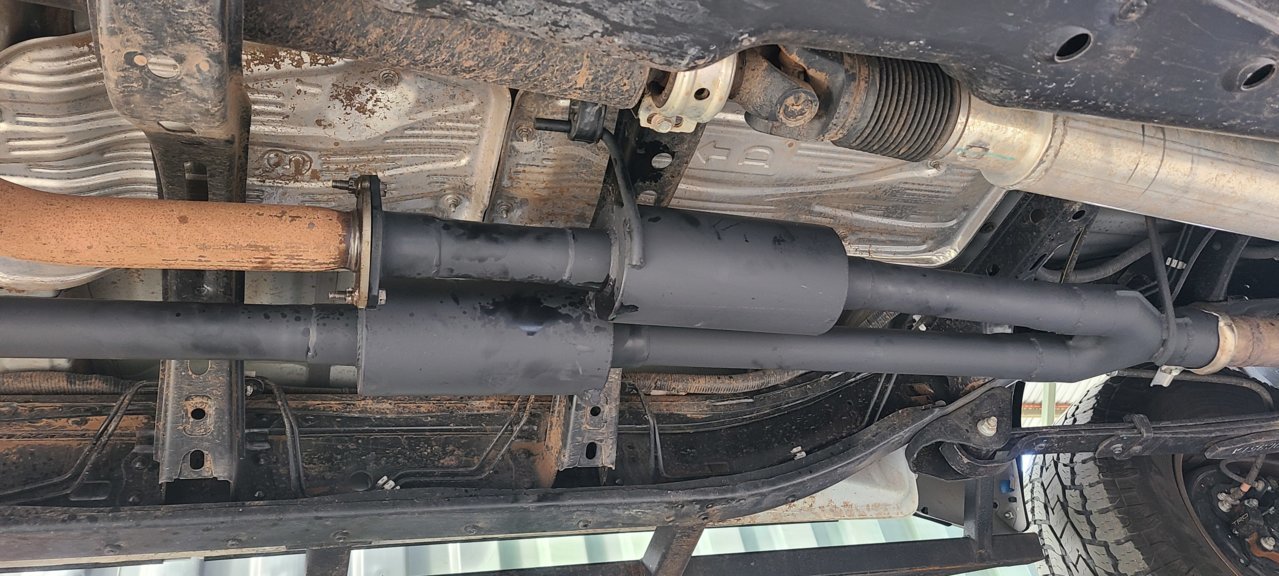

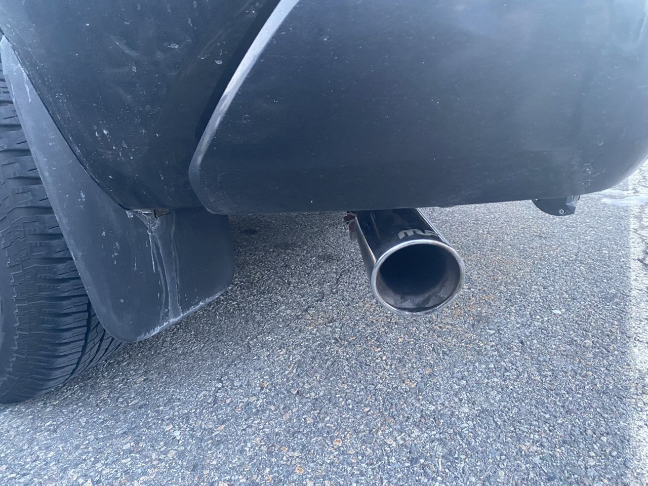

    Installed a used MagnaFlow Street Series Cat-Back Performance Exhaust System courtesy of @JeffMac

    storage sizes are inside measurements, I used 1/4 ply there. Let me know if you want any other measurements.

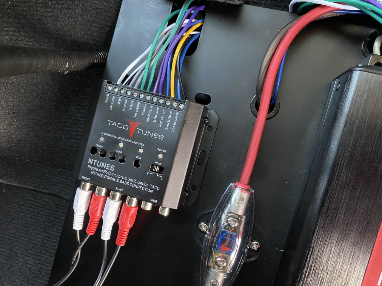

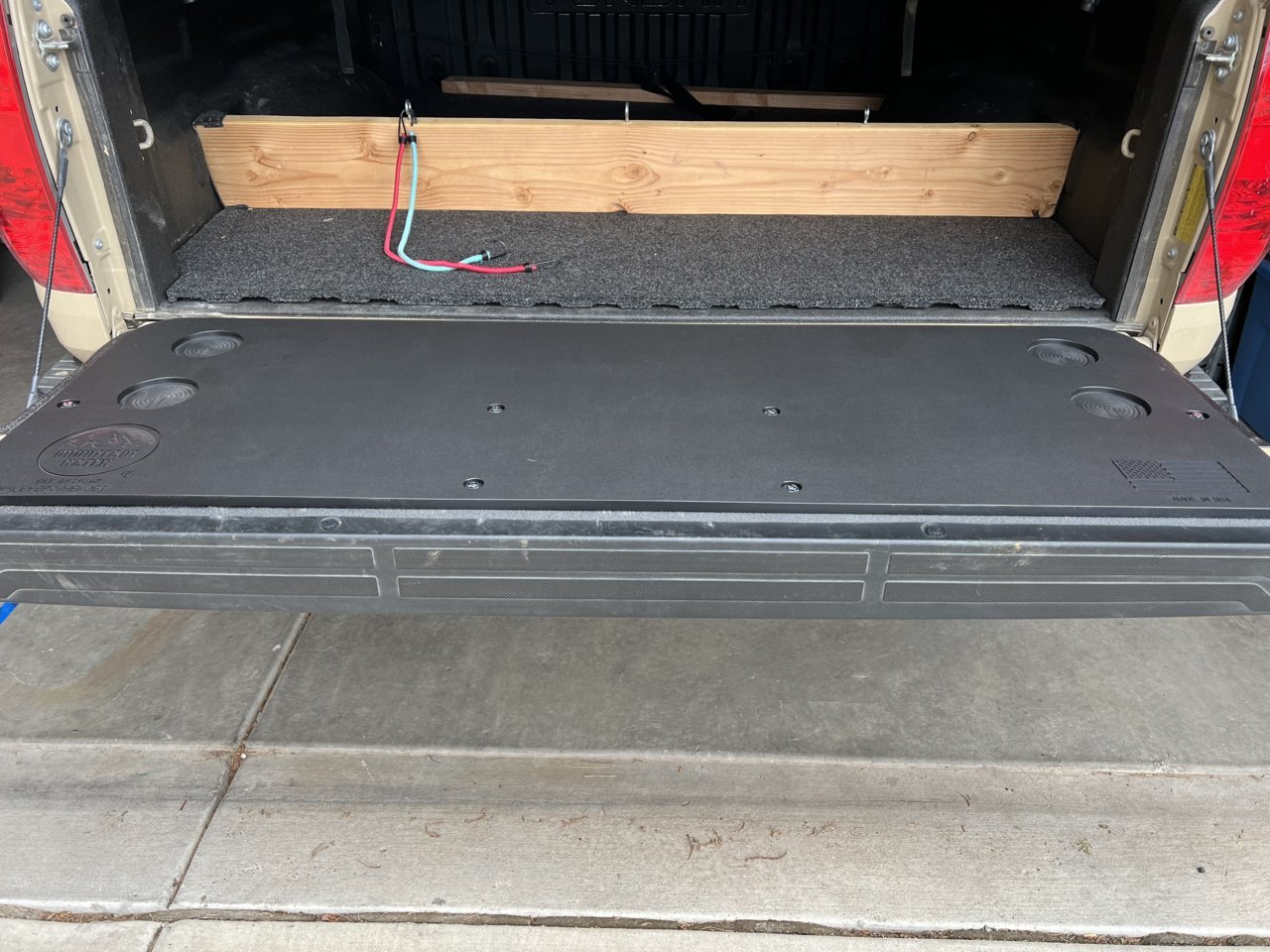

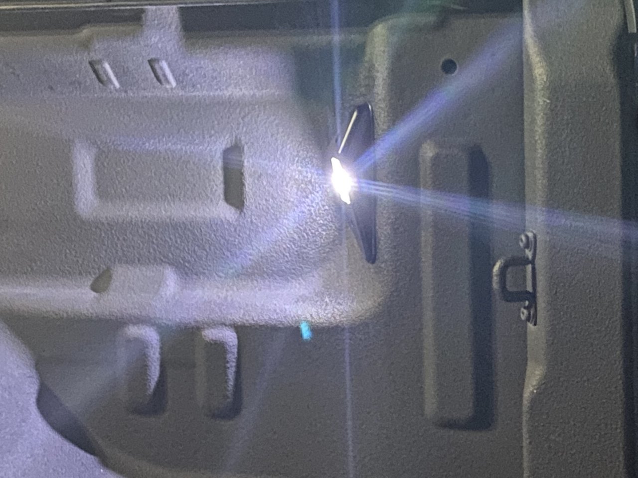

    Installed a Toyota Bed Light Kit & fixed the entune radio with an NTUNE6.

    can you elaborate on this etune fix?

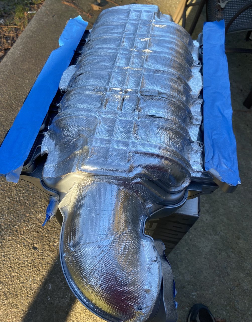

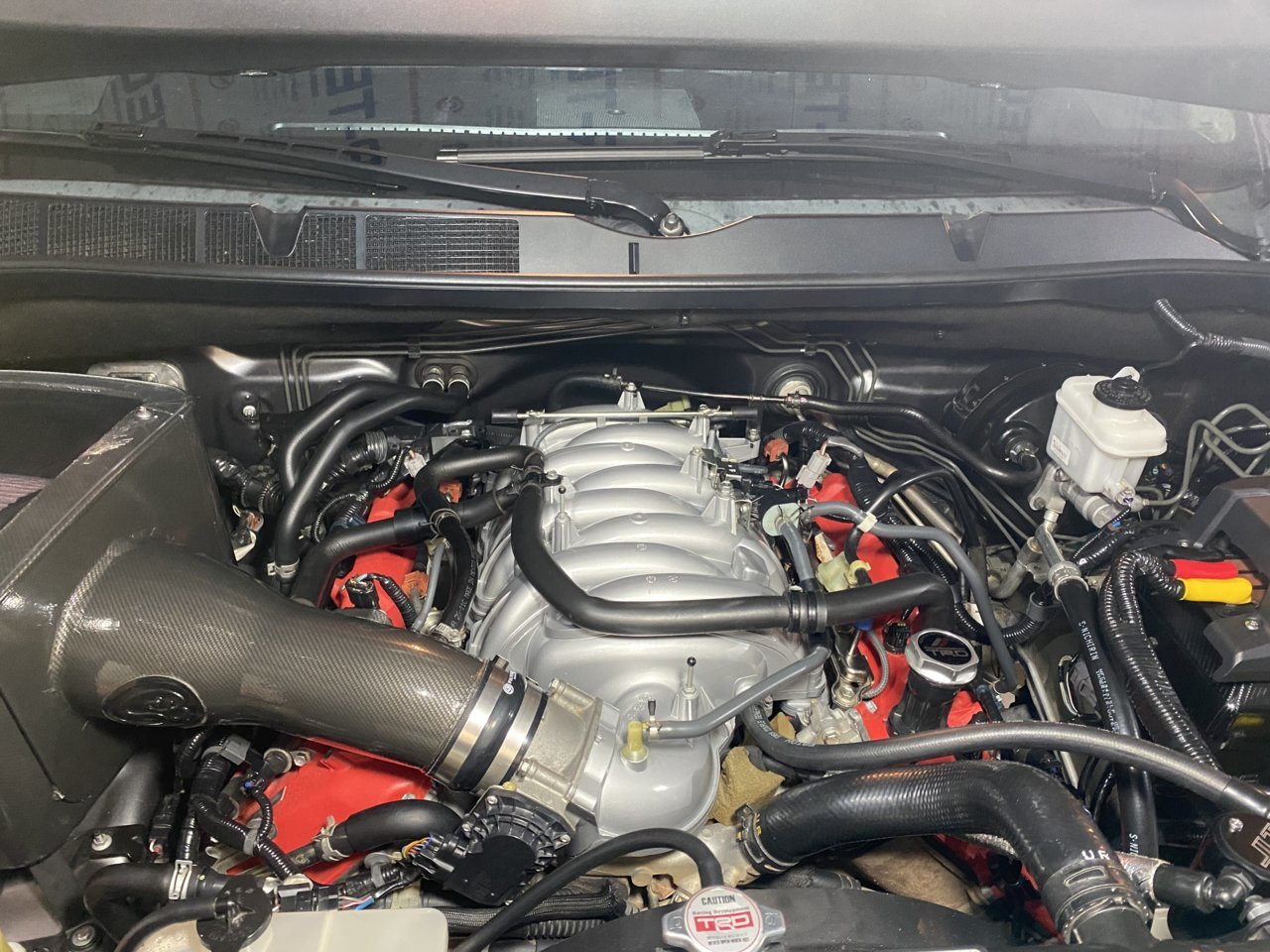

    As mentioned in last post, recently completed oil change and transmission fluid change with filter replacement.
    Part of my oil change routine always includes air filter and MAF cleaning. While disassembling the S&B filter and tubing, I noticed the tb was dirtier than I cared for.
    So it got removed and thoroughly cleaned.

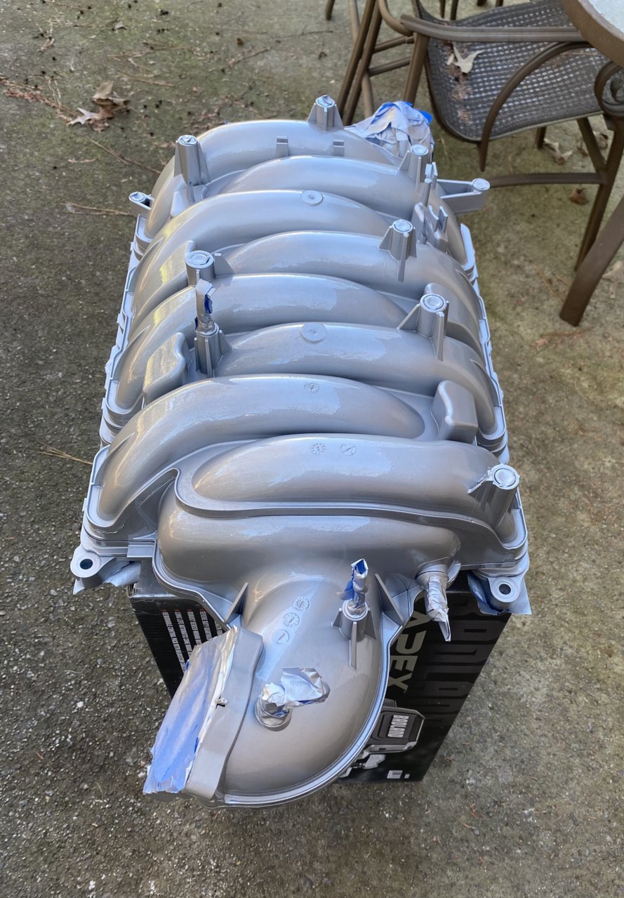

    Once tb was off, I noticed the intake was also way more dirtier than I cared for.
    So in order, I….
    Took off the intake.
    Degreased and cleaned it, inside and out with long brush. set out to dry.
    Cleaned engine (parts) on the underside of intake, including wiping out the inside of the heads.
    Painted intake with VHT high-temp plastic paint.
    Covered bottom of intake with DEI Reflect-a-cool.
    Added new intake gaskets.
    Removed and cleaned all the foam parts around/under the intake.
    Reassembled everything and added a new PCV valve, along with a JLT catch can.
    Added some of the DEI reflect-a-cool to the inlet tube on the can (from the PCV).
    WVI, 3xYOTA, TampaRD Pro and 25 others like this.

    I commend the absolute hell out of this effort. Well done! I’d do the same if there was any way possible that my engine bay would stay anywhere near clean on the daily.

    That should be good! One question - is it just sitting on top of the underwear foam or is it embedded in the foam?

    Looks fantastic.
    I thought our motors had an oil separator that allows pcv oil to drip back into the sump?
