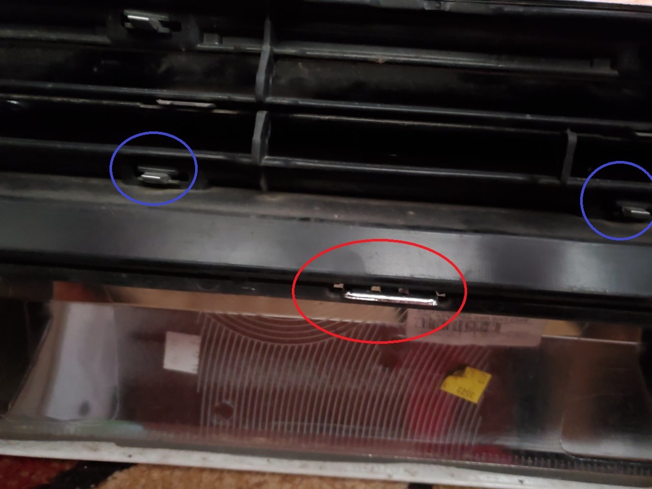

    The tab in red or the tabs in blue? or both?

    Just the red. They hold the grille into the surround with 2 Philips screws on each side.

    oh so you have to remove 2 screws on each tab? then warm/heat them up then start prying?

    2 screws on each side of the surround. Only 4 total holding the grille. Then start on one side, working the clips loose, heat encouraged.
