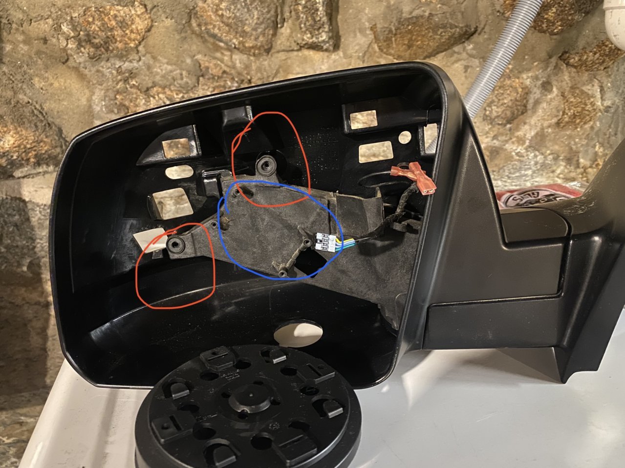

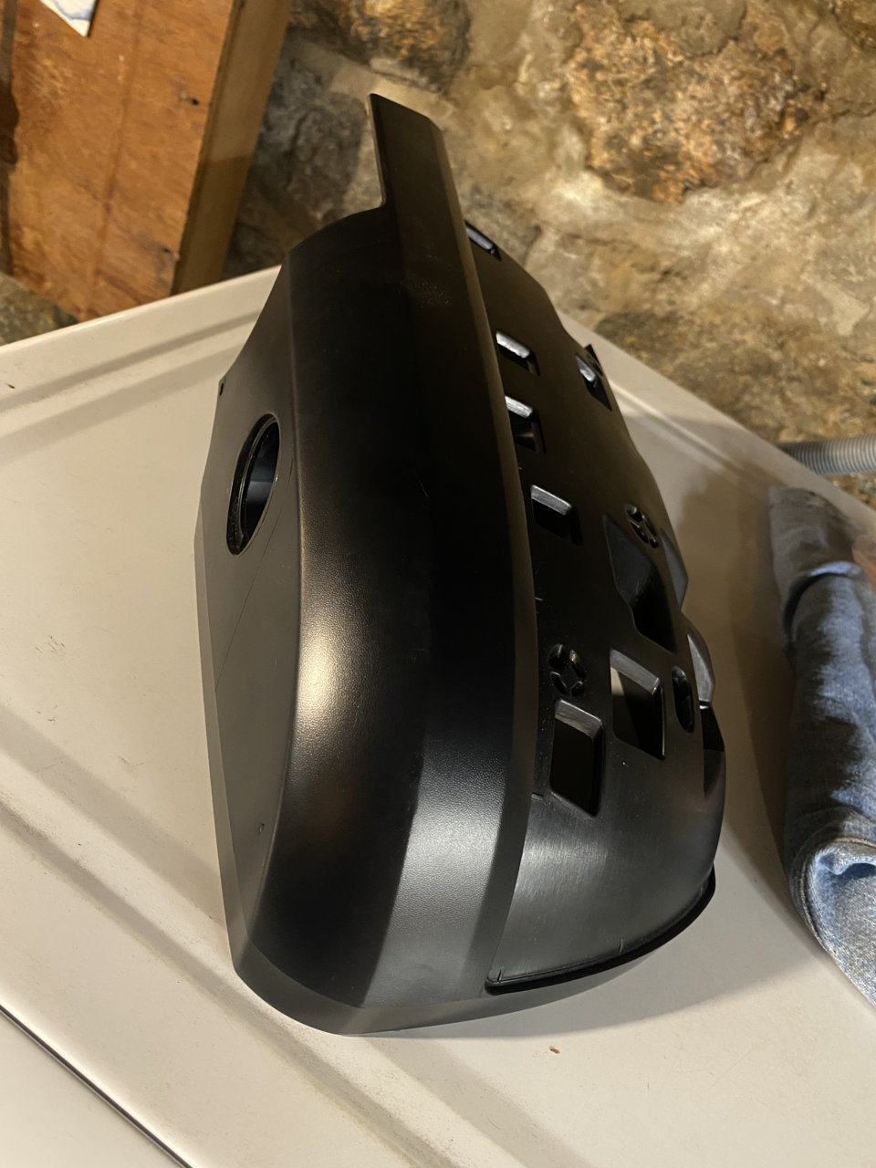

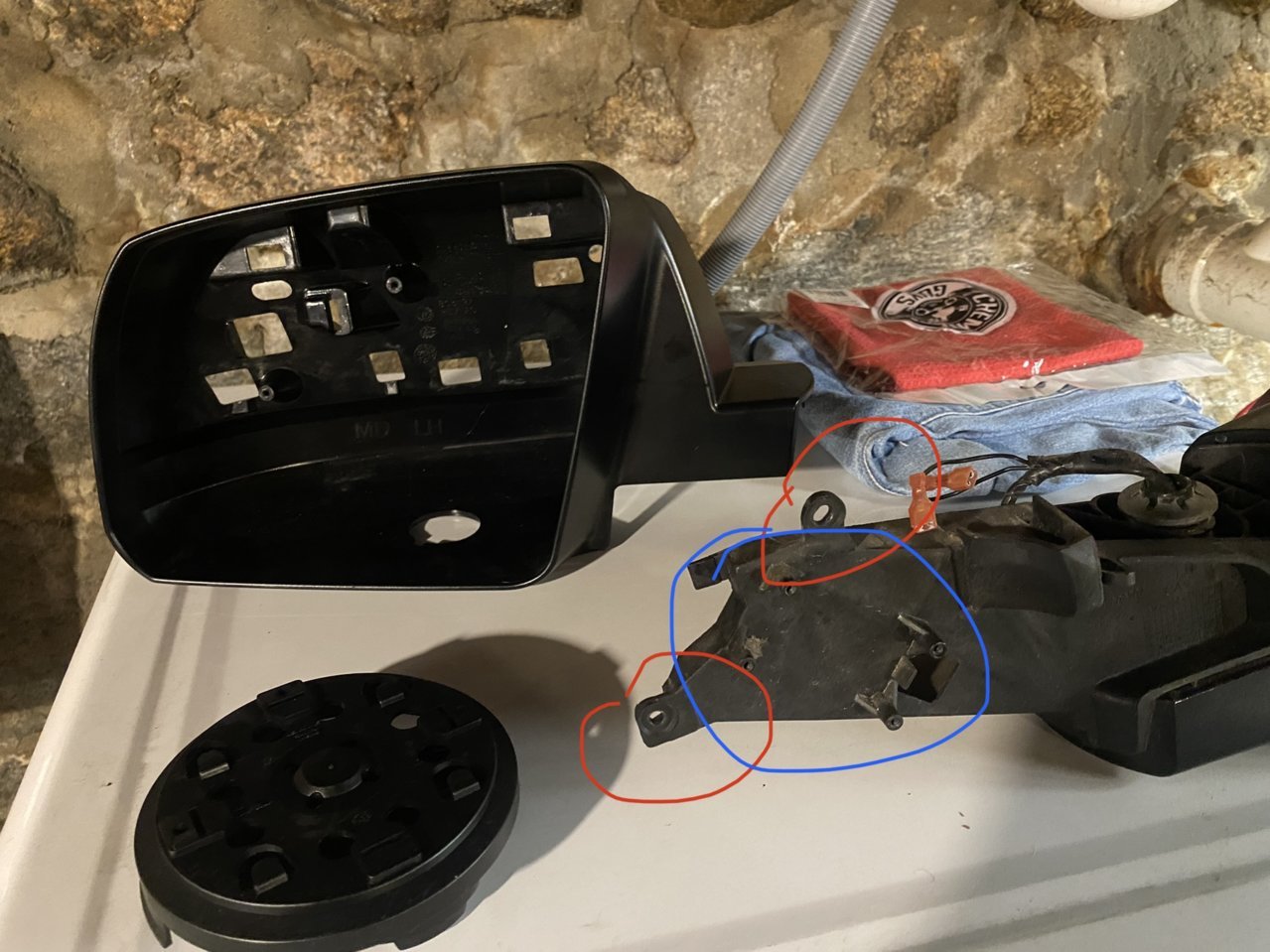

    This is totally doable. Once the round mirror motor base is removed you'll see the screws that attach the outer housing to the inner arm of the mirror assembly. The two separate easily. Someone may even have the exact plastic outer housing that he needs, sitting in storage

    Your mirror has the motor, so you can take it apart.
    The inside of the non-power-fold mirror has a spring that is captured by a plate and a toothed spring washer that I've only seen taken apart destructively.
    I'm pretty sure you're going to be stuck at least getting your hands on another motorized mirror to be able to swap parts...

    1934D5E1-49DB-4044-81D3-C34FA1611247.jpg 83E3CFF1-AFDC-4367-AEE3-850924798F46.jpg
    I’ve swapped parts between a Platinum/1794 and SR5 mirror when I did a power folding retrofit on my dad’s SR5 and again when I added the auto dim/side mirror signal modification to mine. Looking at the attached pics will give you a clearer idea. The housing and the folding base are easily separated as the housing is held to the folding arm by one snap clip and two screws circled in red. The mirror motor is attached by four screws shown in blue

    Ok - that part of the disassembly I missed when I had looked before. Got to know!

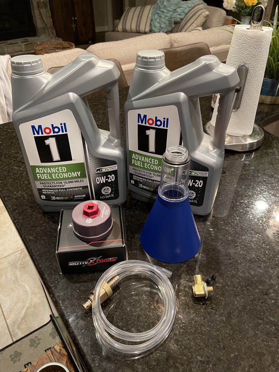

    Toyota Care ran out - Getting ready for the first DIY oil change, just waiting on the filter.
