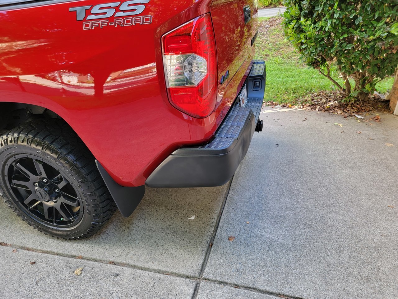

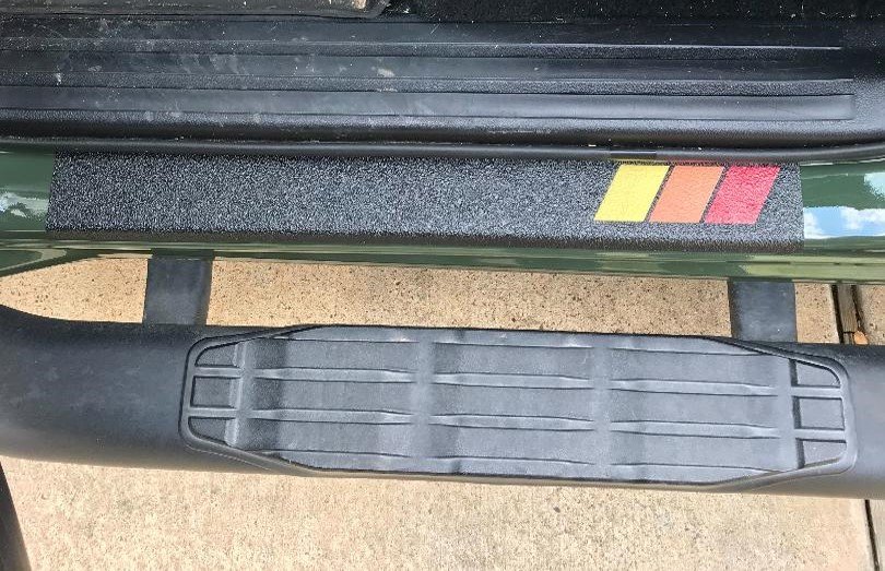

    Added the non-skid strips from TuffSkinz. Easy to install and already covered some of the knicks on that panel.

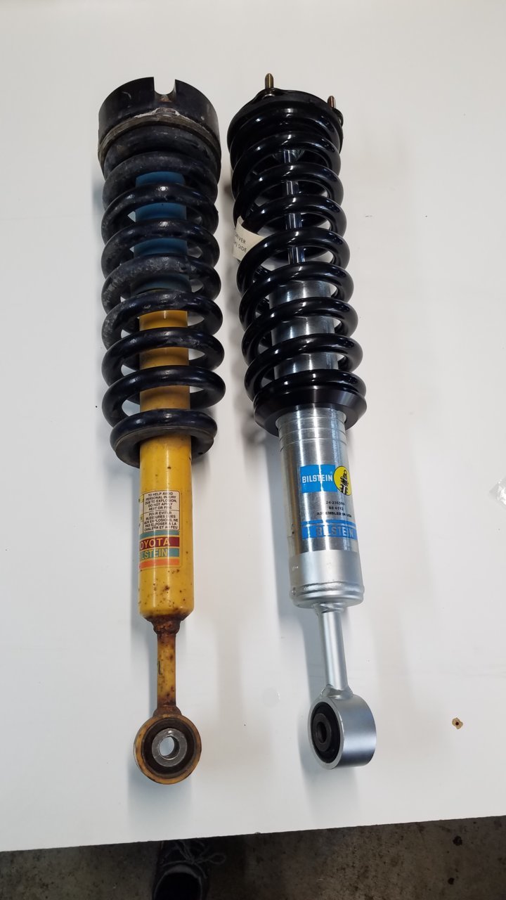

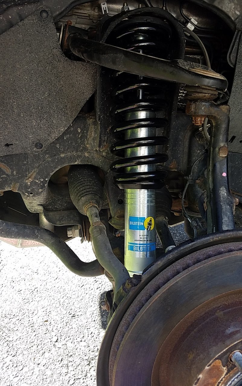

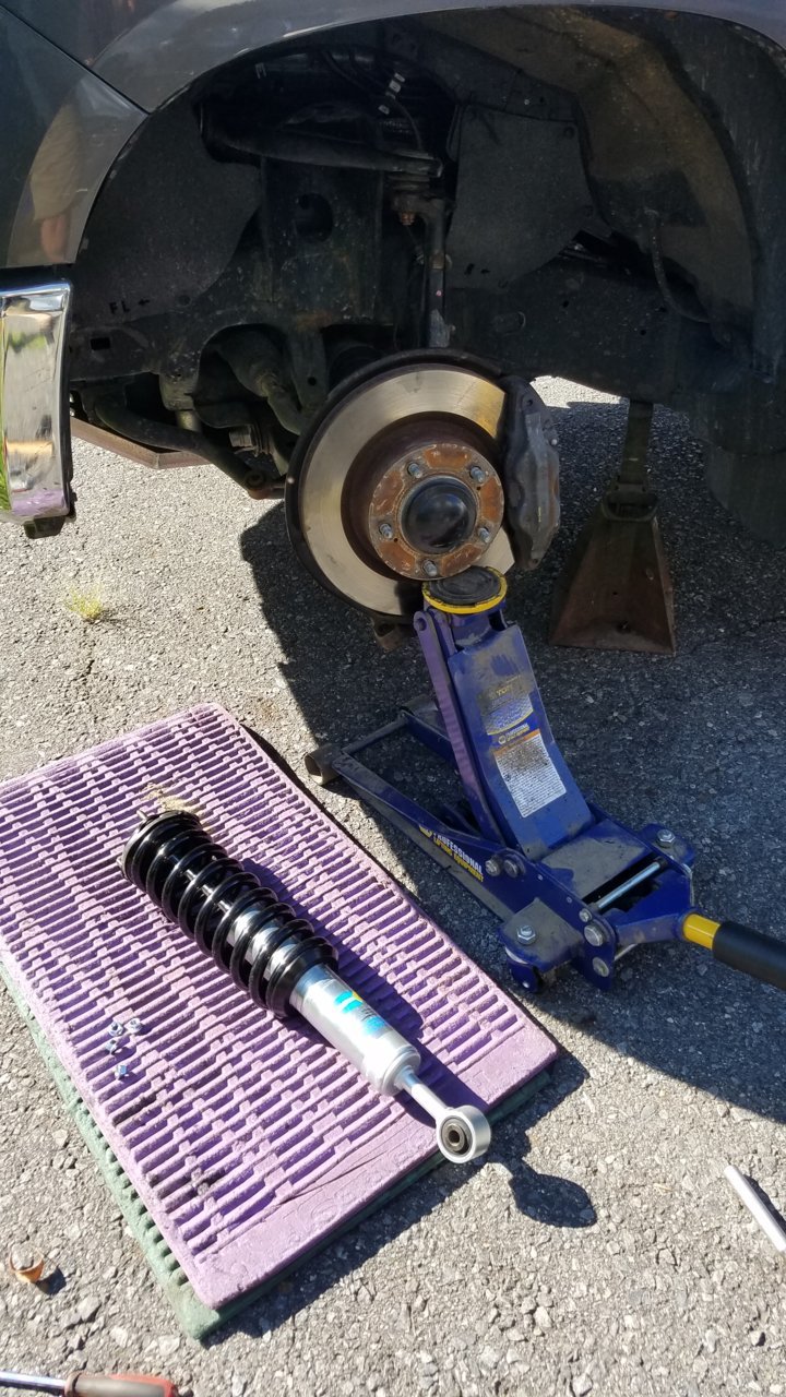

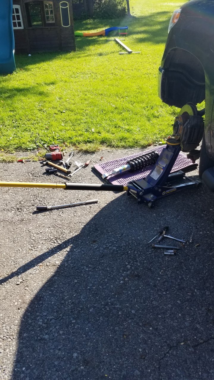

    Added bilstein 6112 shocks at the 2.5 inch setting. I put these on to replace the factory shocks that the previous owner had spacers on. I find the ride very smooth and less body roll while cornering . I have the 5160 rears and these complement them very nicely. I bought these from wheelers off road. i also added the wheelers front and rear super bump stops.

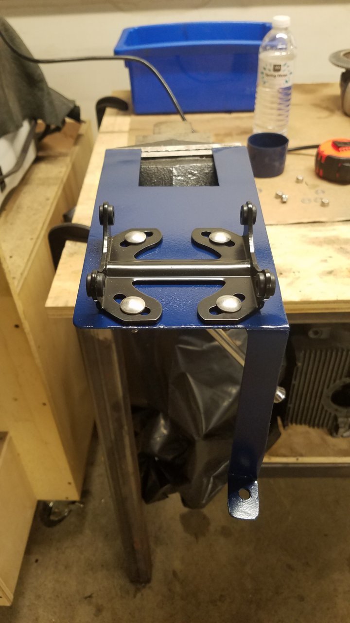

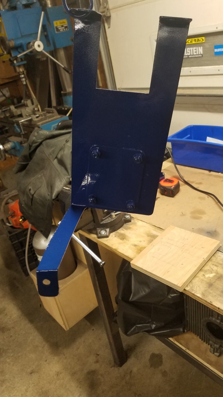

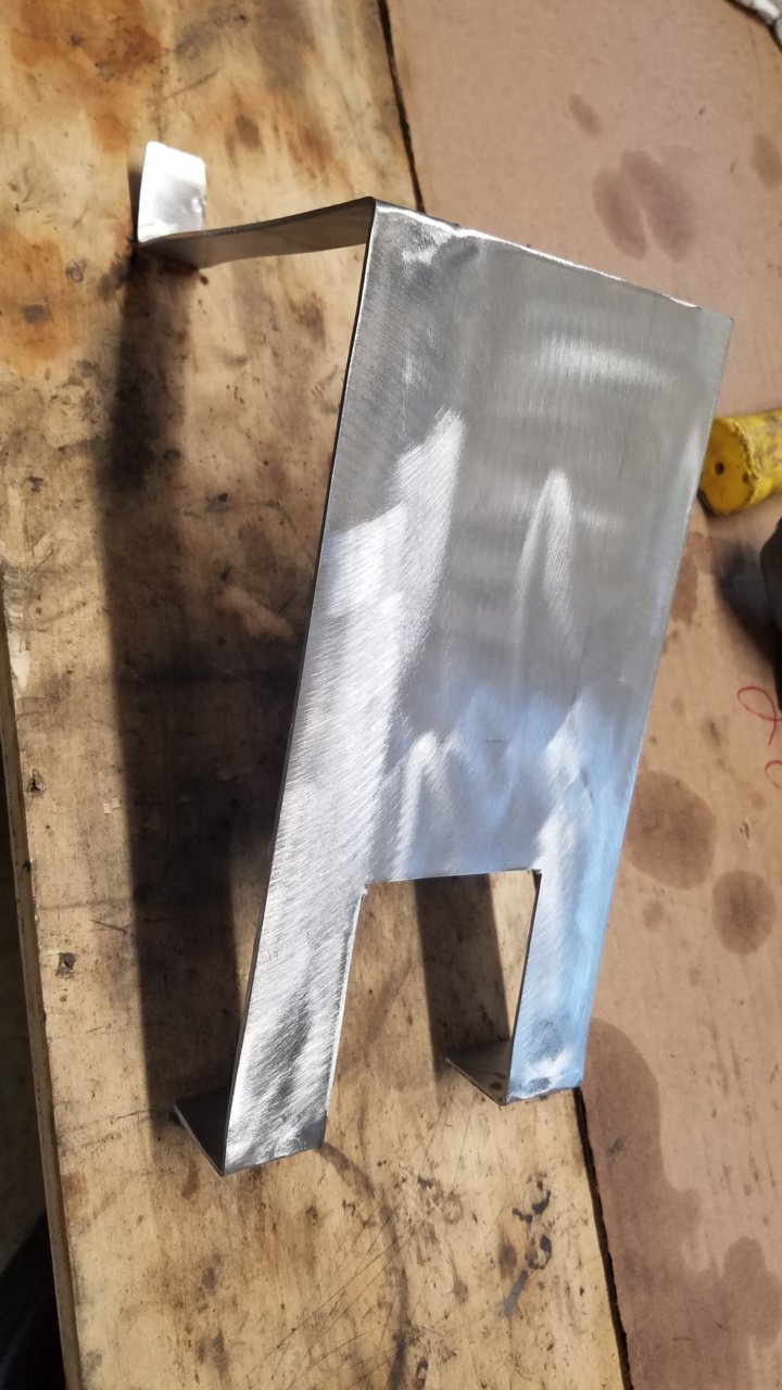

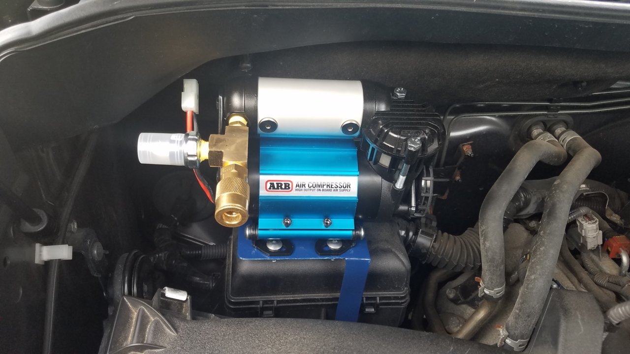

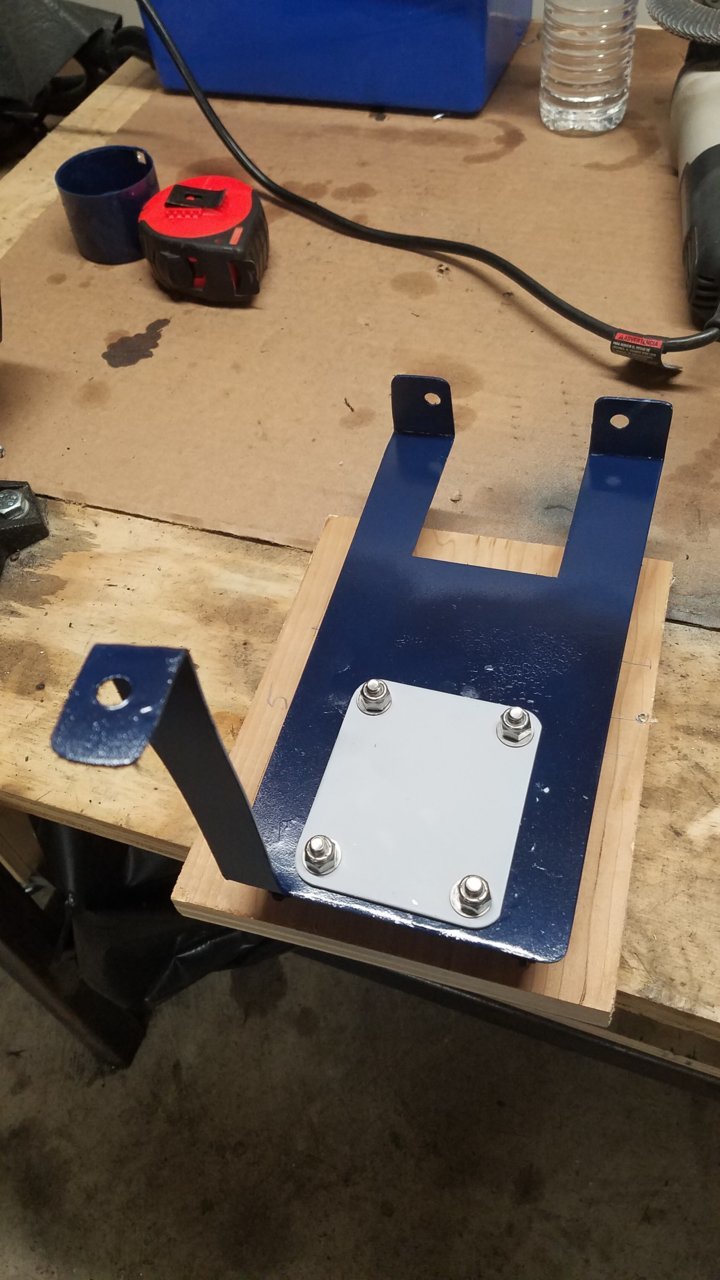

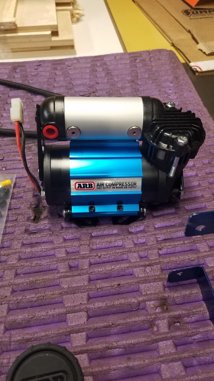

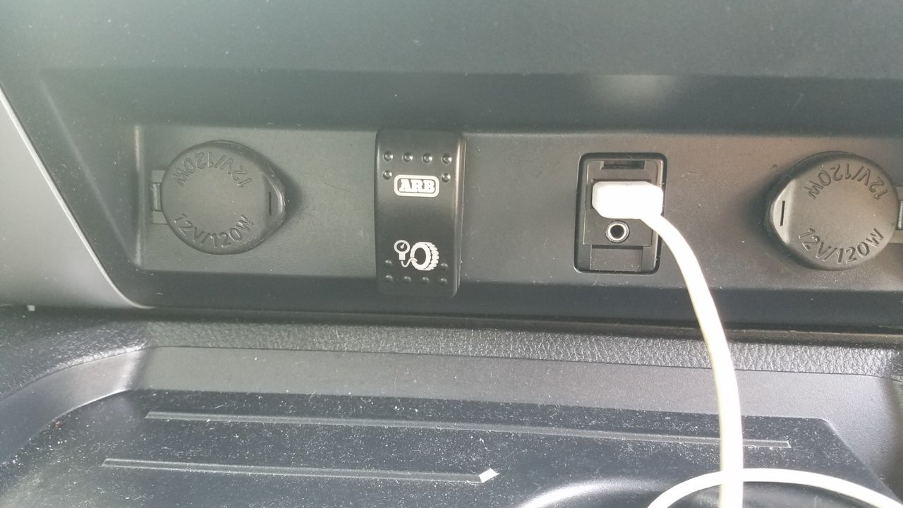

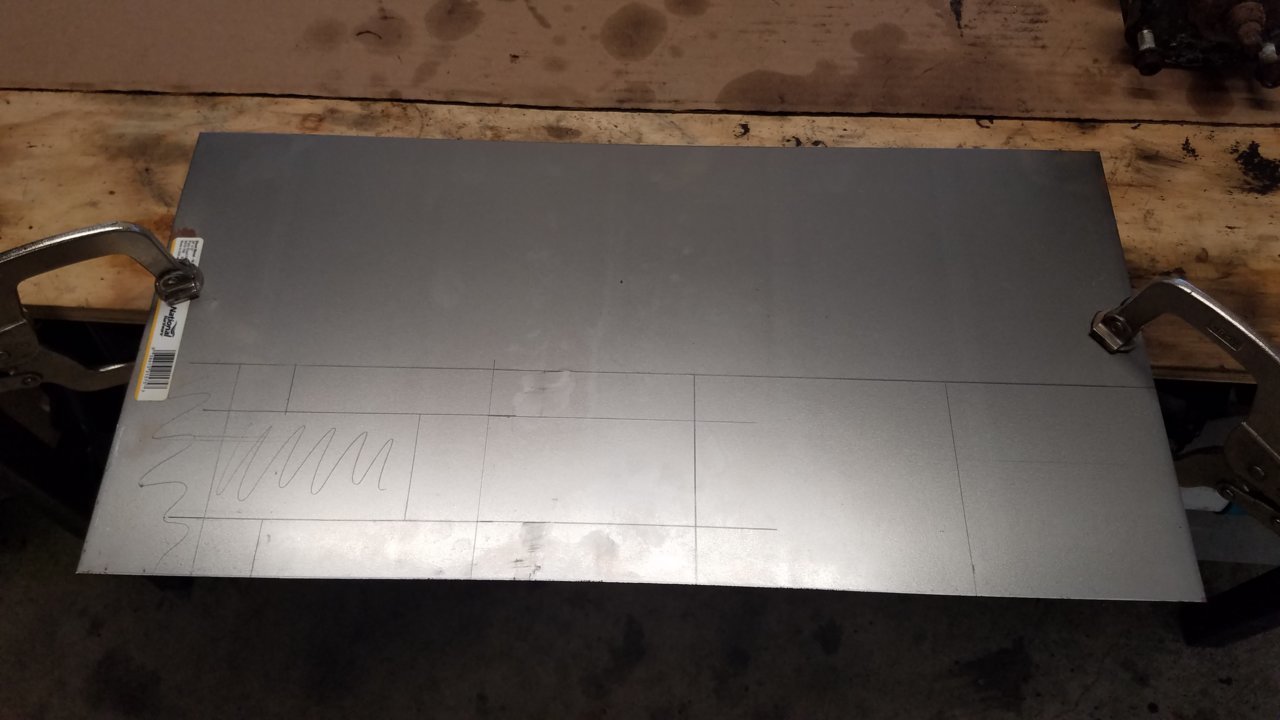

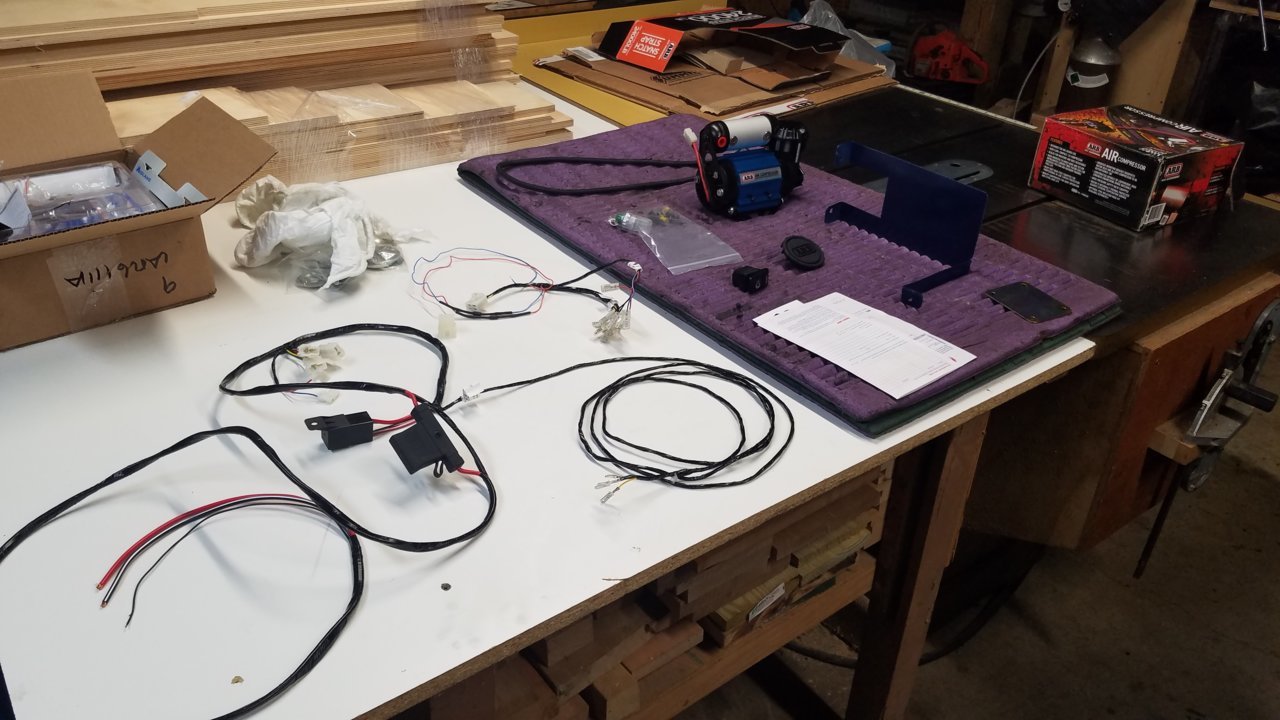

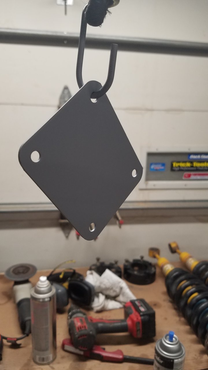

    I made a mount for a ARB single air compressor . came out nice. I ran the wires through the rubber grommet to the right of the glove box.

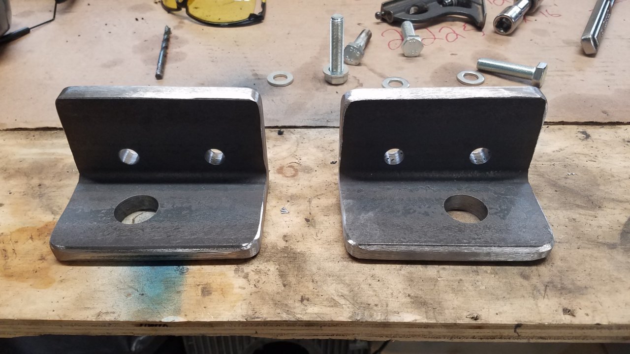

    I made some recovery points for the front using 3 x 3 x 1/2 steel angle. I plan on cleaning them up and painting them this week. aleady have 8.8 12mm x 1.25 50mm bolts

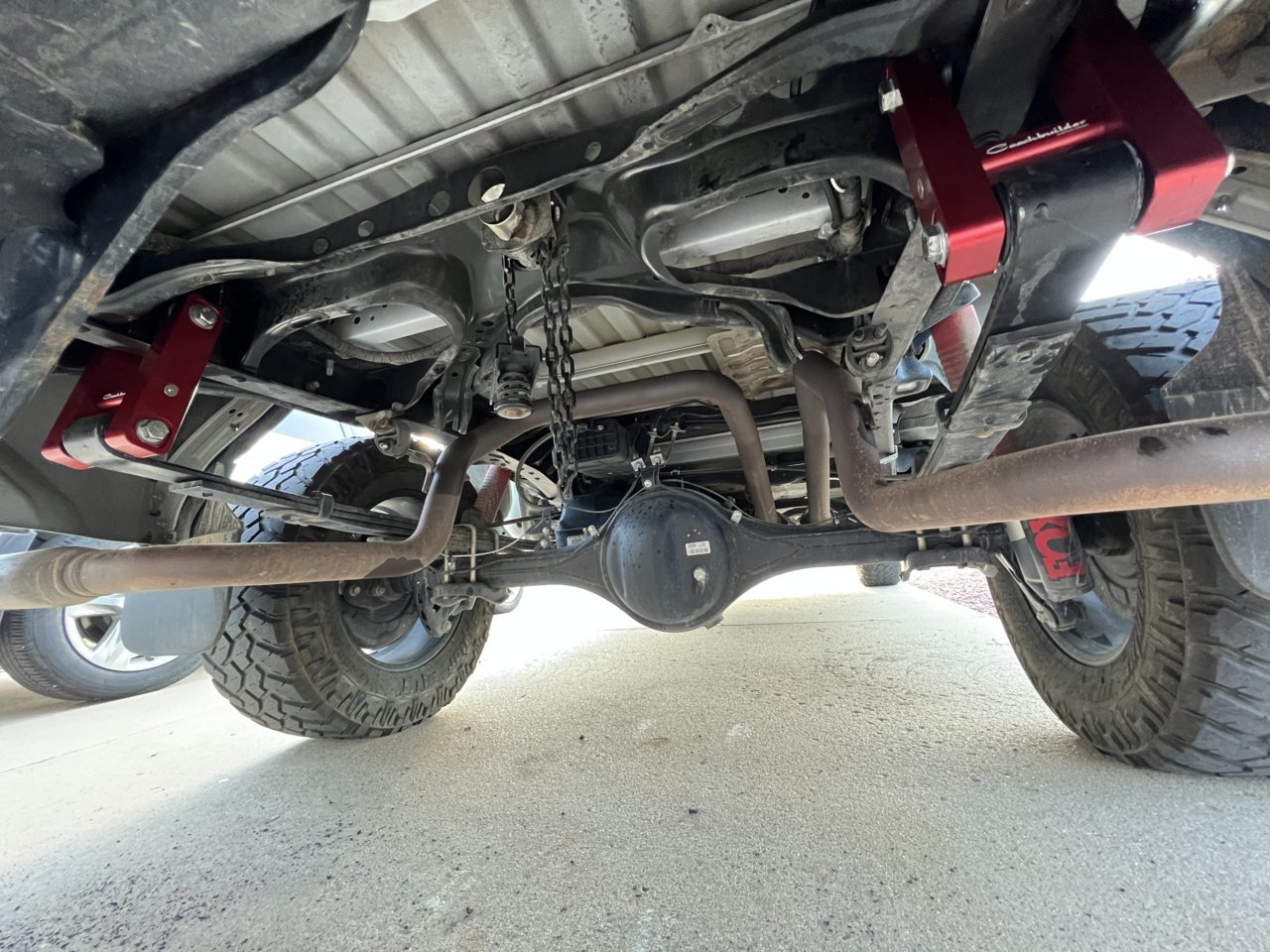

    Got the shackles installed, man those bushings in the eyelets are zero fun. But…got the rear end finished :yes:
    Before
    After

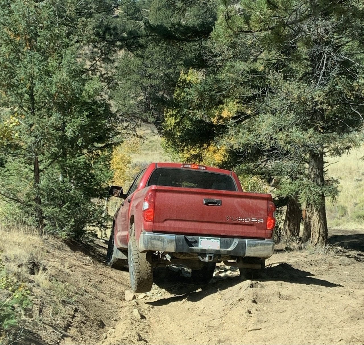

    Took her to enjoy the scenery with family.

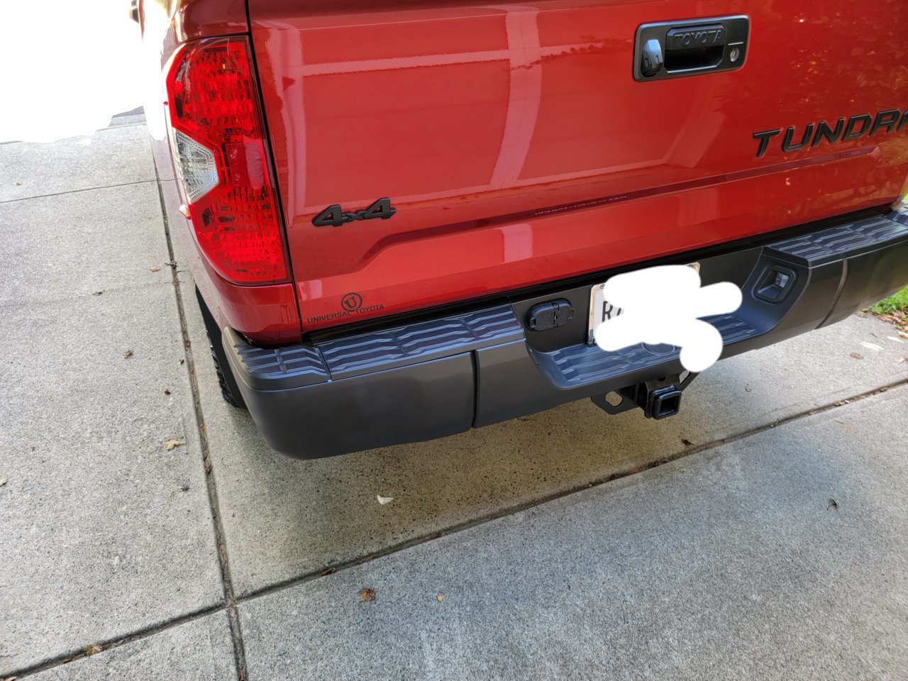

    Drove up into the mountains. Backed into a fir tree and modified my rear drivers side bumper. It’s not terrible, but I see it.
    Gonna have to fix it…eventually

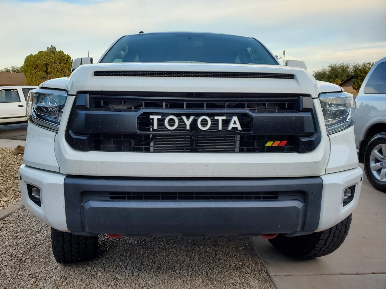

    Finally got around to installing the retro badge on the grille.

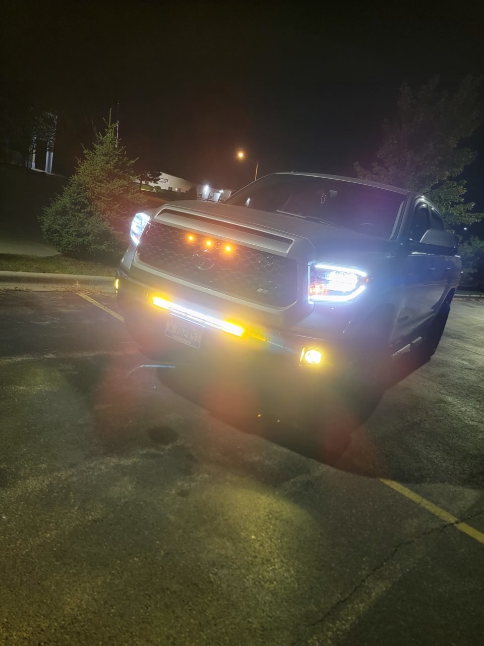

    I see people here in NY driving with similar setups with all of the lights on all of the time - daytime AND at night. Melts my retinas. I probably sounded like a dick…looks killer and I am glad to hear you’re not out melting people’s eyeballs.

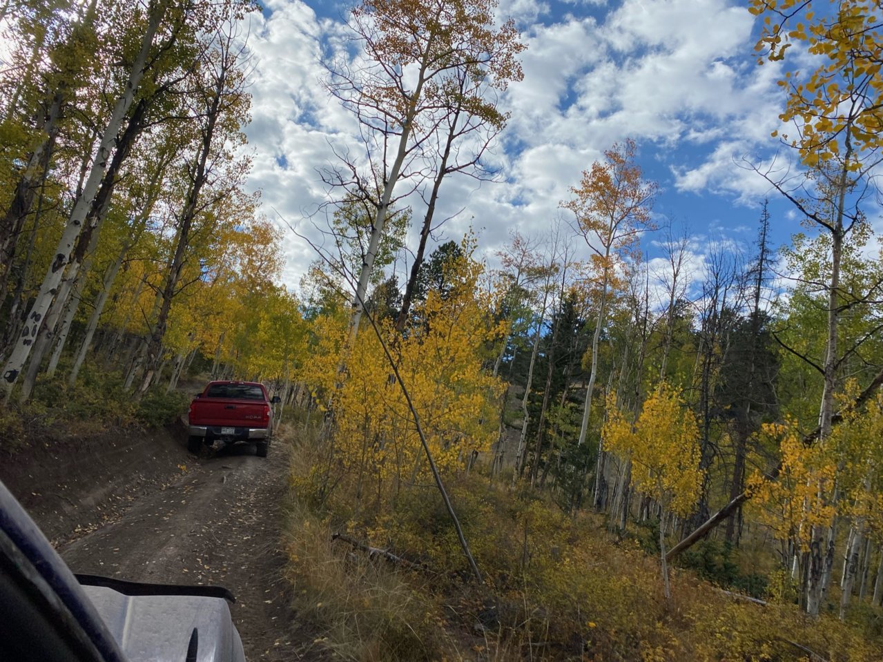

    Today, I took the ole’ girl for a road trip to explore the fall colors and stretch her legs a bit…

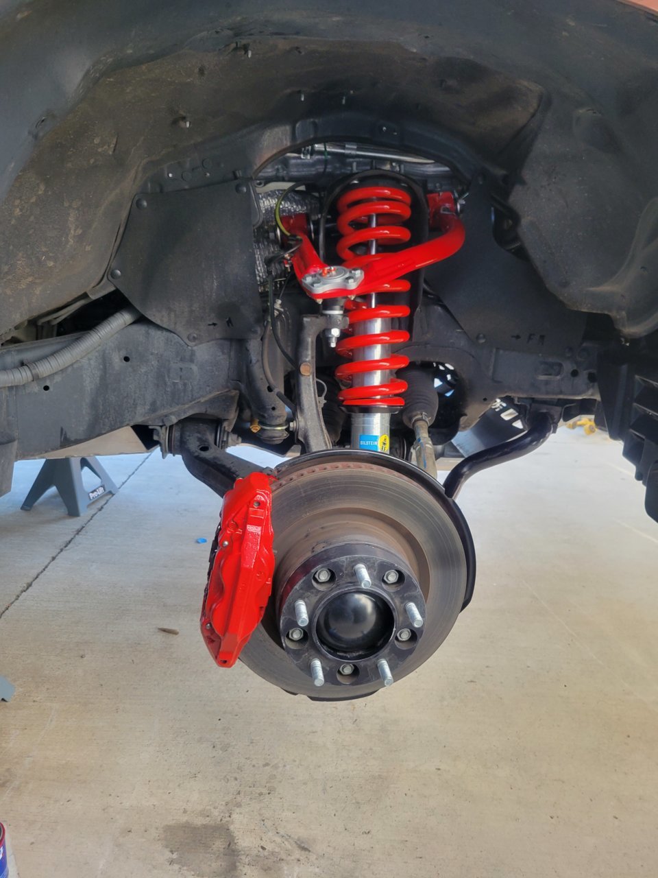

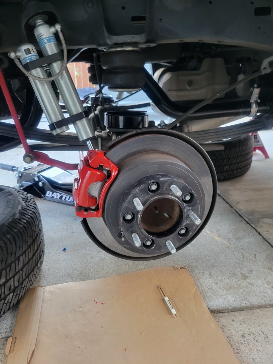

    Painted my calipers with G2 Caliper paint.
    Edit: Also installed Daystar airbag cradles and Bora 1.25" spacers

    That looks good!

    Did you remove the calipers to paint, or do them while still installed?
