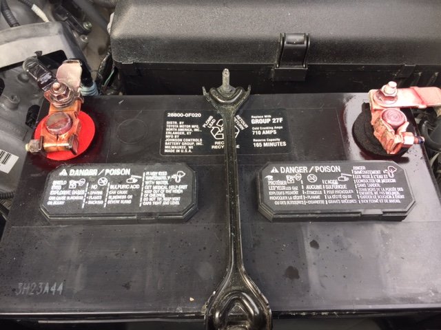

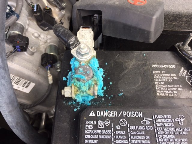

    Turned this:
    Tundra%20battery%20corrosion_zpsnknvhx0b_63e2b8dfc4af5c692df93f6bcf057d11e857873f.jpg
    Into this:
    Tundra%20battery%20corrosion%20clean_zps_ec2180b416442782034b6c39e4bb033d63189c7e.jpg
    The culprit was a small crack in the housing around the entire circumference of the positive post. Must be letting the gasses out right underneath the terminal. Sealed it up temporarily but time for a new battery.
    1UPPER, TheBeast, PaRunnerd and 8 others like this.

  10. Apr 15, 2017 at 6:21 PM
    #6130
    mdavis
    mdavis I need a beer.
    Feb 13, 2015
    #966
    3,342
    Michael
    Rock Hill, SC
    If I remember correctly, @ColoradoTJ said Toyota batteries are warranted for 7 years. Might wanna run it by the dealer and see if they'll throw a new one in.
    1UPPER, Jsena, CM-LENNY and 4 others like this.
  11. Apr 15, 2017 at 6:26 PM
    #6131
    Cat3ILS
    Cat3ILS The cheese goes on the bottom bun
    Jan 1, 2017
    #5768
    266
    2014 platinum CrewMax 4x4 5.7L - white
    2.5 level, 285 Toyo OC, Or-Fab trans/cat skid, X2 Revolver, ESP storage, Husky's, Lock'er Down safe, OCD organizer, Interior LED's (red drivers), Glove and safe motion LED's, Rhino lined
    Great info @mdavis ! thanks for the intel! Will do.
    mdavis likes this.

    Use the hot water method?

  25. Apr 15, 2017 at 7:08 PM

    Not that you'll need to do it again..but pour very hot water on the terminals/connectors and it works magically.
