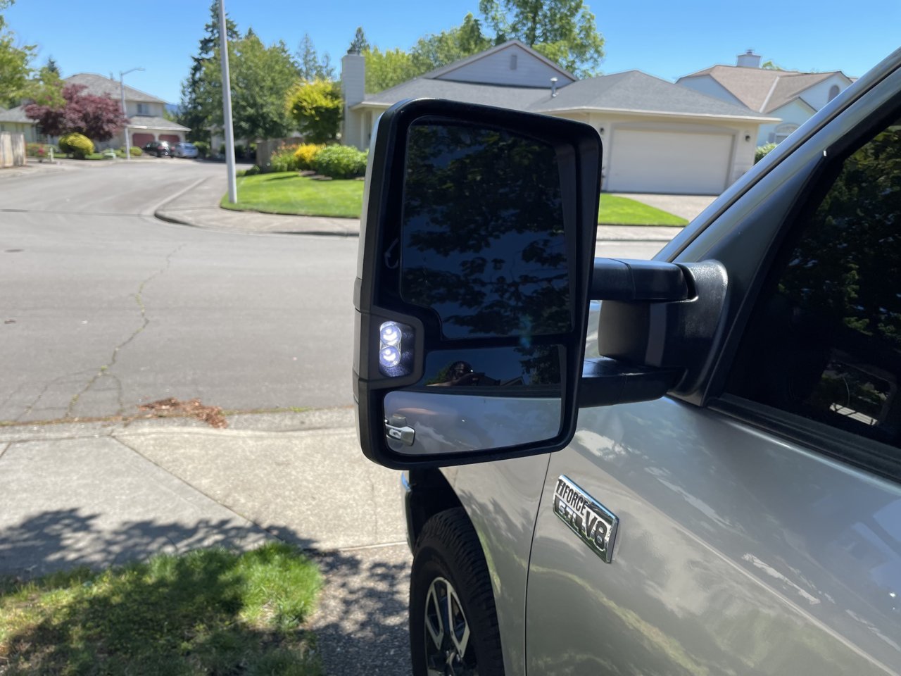

    What guide did you follow for the light set up. I have the same thing to do with my mirrors. Left it pending since I had to leave to Oklahoma for work.

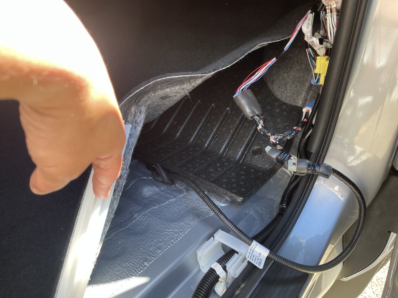

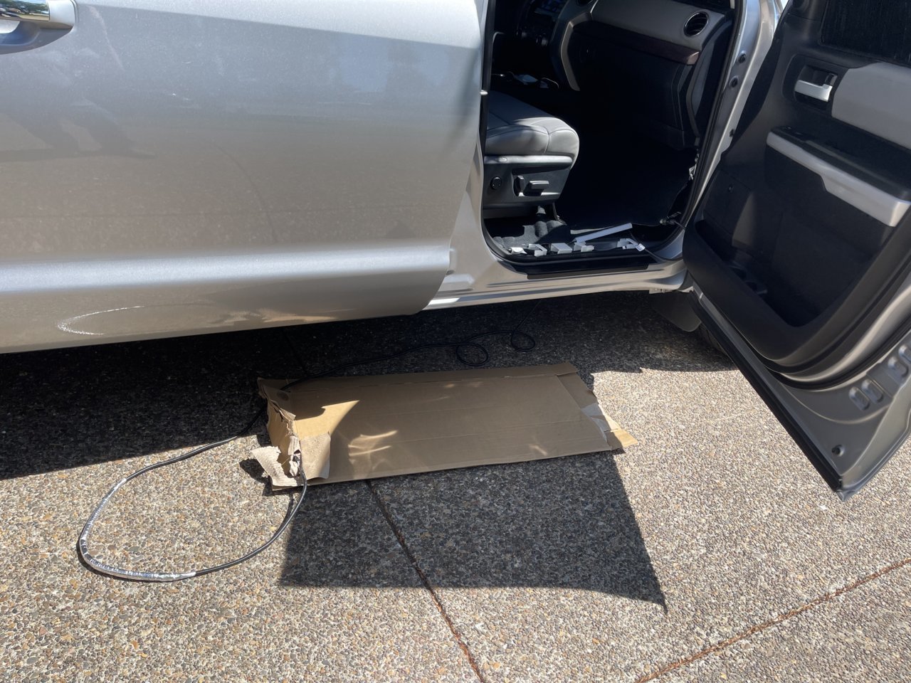

    It depends how you want them hooked up. I have seen two methods online: 1. Hooked into the reverse light circuit as detailed on the boost auto parts install video. 2. Hooked to a dedicated switch so they can be controlled when desired.
    I chose a third method and hooked mine to the circuit that powers the cargo light. This way these lights come on with the interior lights when I unlock the truck or manually by using the cargo light switch.
    First, remove both front sill trim and lower kick plates and then fish the passenger side wire to the driver side. Then disassemble the lower dash to expose the connectors into the driver side fuse panel and module. Note: I had never taken apart my dash so I watched the first part of the dash disassembly (remove kick panel, (2) 10mm bolts, lots of clips) video by @2020Platinum on his you tube channel (thanks Patrick :hattip:).
    Previously @RainMan_PNW had been kind enough to interpret his selection of wiring diagrams to point out I needed to tap into the wire coming from pin 28 on connector 3K (thanks Casey :hattip:). This is the top connector on the main fuse panel/module. I did have to remove some of the wrapping on the harness to access the wire but then made the tap, reassembled the dash, and then cleaned up the wiring running from the passenger side so it would not interfere with pedals, etc.
    Next, I reconnected the battery to test function. Everything worked so I reassembled the kick panels/sill plates and cleaned up tools before finally installing my floor mats. I did not take any photos but attaching the diagrams and photos provided to me when I was looking into this solution a month or so ago.
    I would suggest you check wiring diagrams to see if your tap location would be the same since your truck is a few years older.
    Lastly, @2020Platinum did a video on his install and @RainMan_PNW details his install on his build thread. I suggest reviewing both for some tips if you are going power fold (mine are manual). Feel free to let me know if you have additional questions.

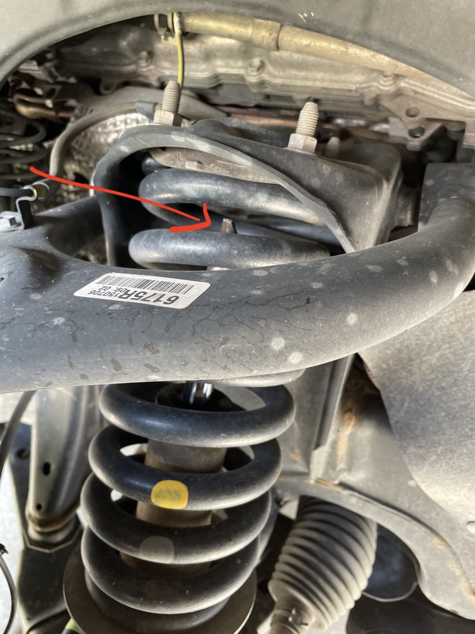

    Was that original shock ? ... curious how many miles on 'em. Just hit 70k and looking to upgrade all 4 corners.

    I got the truck used, it was 3 years old and had 30k miles on it. No idea how long those shocks had been installed. I'm approaching 70k as well and will be looking to get the rears done too.
