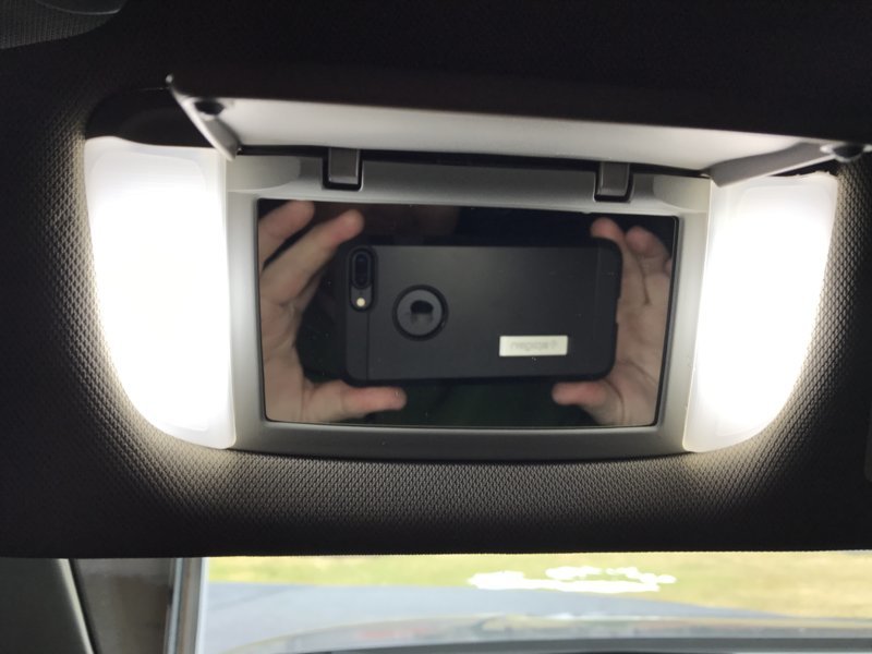

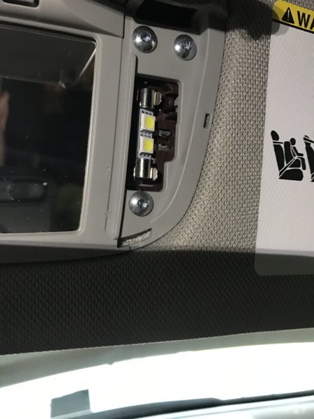

    Tried to finish my "interior LED swap" today. All that was left was the vanities and footwell. Ordered these up from VLEDS and popped my hood, pulled that 7.5a fuse and got after it. Vanities went well. Have heard horror stories of shoving metal around those contacts to pop the old bulbs. IMG_5056.jpgMr. Miyagi style.
    And "on". Good lord these things are bright.
    Ordered 2 bulbs from VLEDS (mistakenly thought there was one on the passenger side - oops). Well inserted each bulb and neither worked. Went back to the stock halo. And now that one isn't working.
    Is there a separate fuse for the footwell? They (the dome, map, and footy) used to come on all together when I opened the door - now the footy doesn't work. Stock halo nor either LED.
    I also tried switching each LED to account for polarity problems. Did I short the footy wiring? Ugh.
    Anyone have any thoughts? Thanks
    Anyone have any thoughts? Thanks[/QUOTE]
    Check the fuses on the driver side foot well kick panel. I did this on a previous vehicle and got the polarity wrong and I think I touched the two prongs together. It blew the fuse.

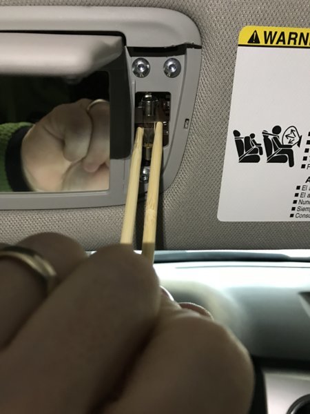

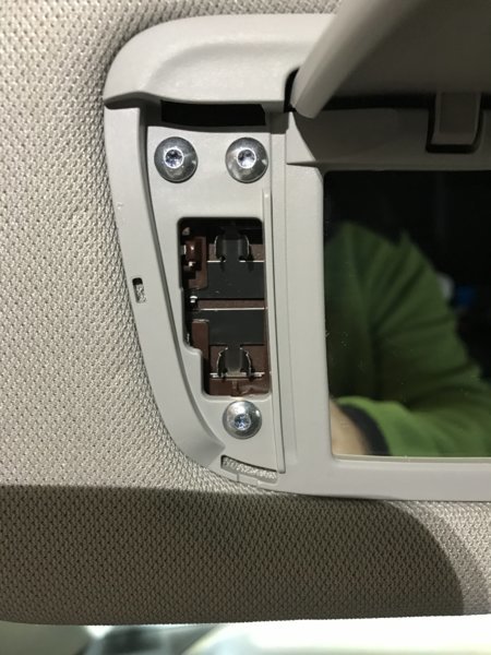

    The best way to remove the bulbs is to use tape. You make a U shape with the tape and put it around the bulb and you just pull it right out. Strong packing tape is the best. That's how I did mine. You will be surprised how well it works. For the vanities a plastic tool works best.
    PermafrostTRD, the footwell light is so small that it's hard to get the contact points perfect. I had the same problem when I did mine. I used needle nose pliers to put mine in and I finally got the contacts correct. You just need to be patient.

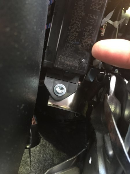

    @darkknight2014 here's the fuse:

    Holy crap. That's tough to get to. No wonder I didn't see it. The one your pointing to looks to also power the front seat. Front seat still operates.

    I wasn't necessarily pointing at any specific one. Just the fuse block itself. You'll have to pop the cover off. There is a tab closer to your knee or the rear of the vehicle just pull down and the cover comes off.

    No need to unscrew anything. If you reach up and put your palm on the cover reach up higher pointing towards the steering wheel with your pointer finger you'll feel a tab up at the top of the cover just pull it like opening a beer can

    I was referring to the knee panel with the 10mm bolt. The one that looks like it houses the "knee srs air bag"
    *edit*
    Got the fuse cover off and checked the fuses. "Beer can" analogy was the trick lol. All fuses are good. Thanks for your help!!

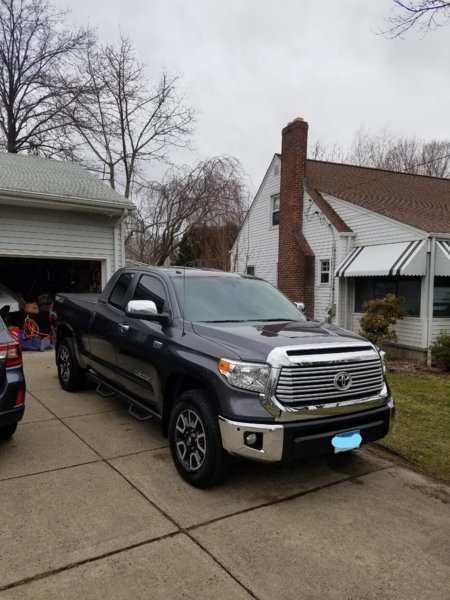

    I don't feel the need to upgrade my headlights now, goal accomplished and I'm not getting flashed by oncoming traffic too.
