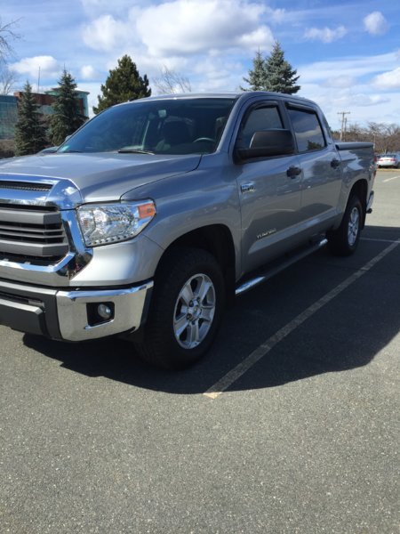

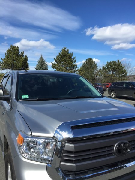

    10 days in...dipped the front emblem and smoked the front windows at the MA legal limit. Also put in some weathertec mats in the back. Still undecided if I should dip the rest of the badges.

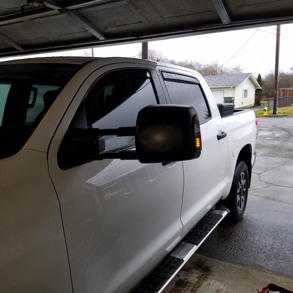

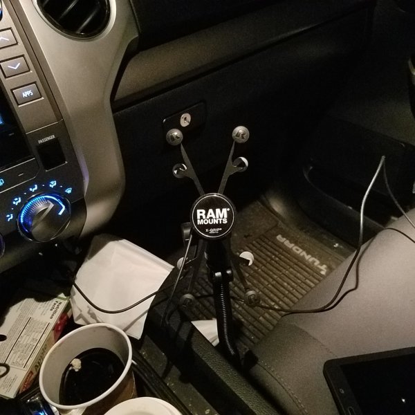

    Are those mirrors the Toyota brand or aftermarket? How hard was the install for a guy that has no idea what he is doing and is best friends with Murphy's Law

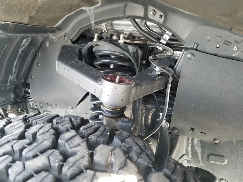

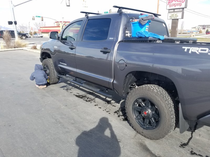

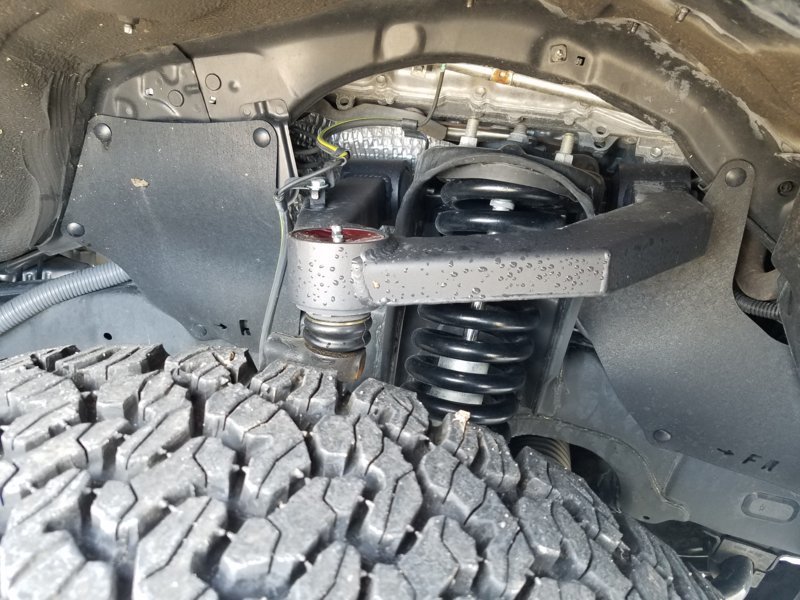

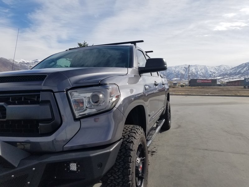

    Installed Zone Off-road UCAs last week, got an alignment and a much needed hand wash!
    20170304_102533.jpg 20170304_102524.jpg 20170304_101845.jpg 20170304_102545.jpg
    My fuel economy is vastly improved after new uppers and being able to dial the caster in within spec!

    Beautiful looking beast!!

    Not sure if they are OEM.
    I added OEM tow mirrors to my 17CM and is was very easy.
    Just take your time and all will be well. There is a video on Utube.

    Did you do the 3.5"/1" kit or just the UCA's?
    My kit will come in next week and then an install.

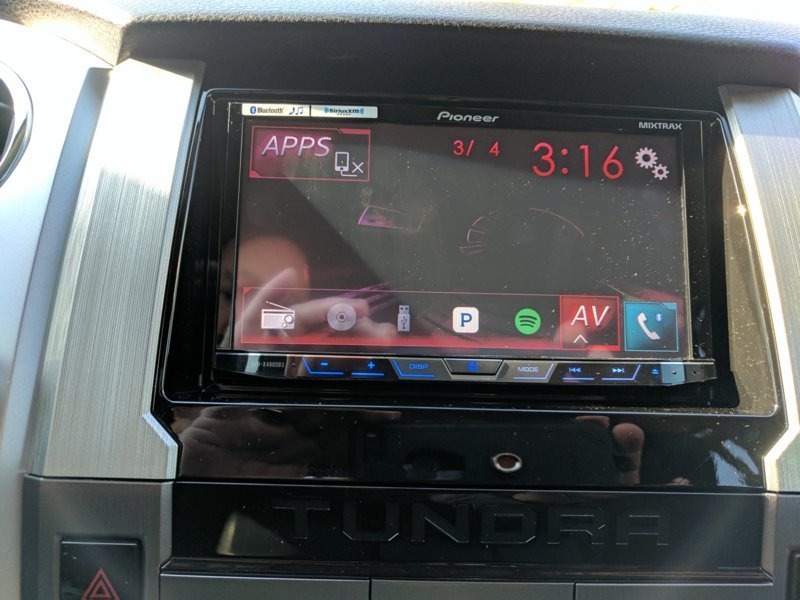

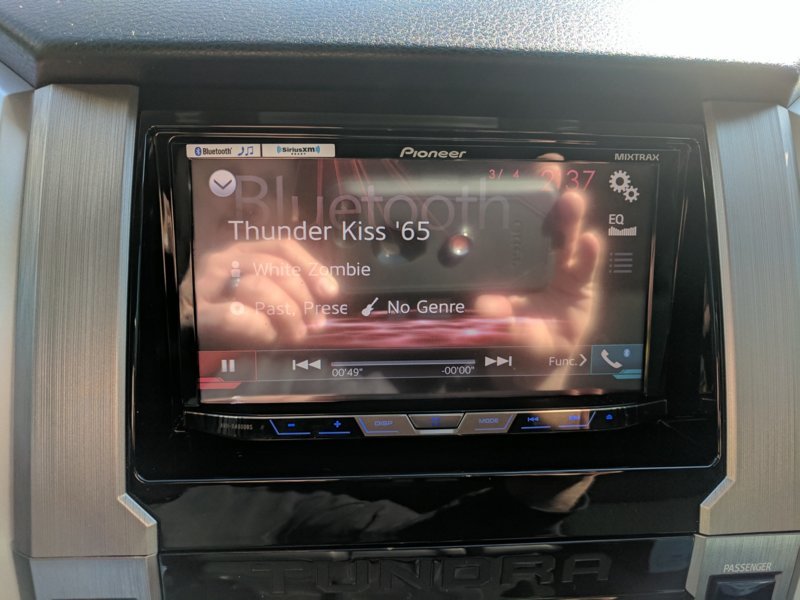

    Installed a new pioneer HU to start an audio upgrade. Wheel controls work , rearview camera works anytime now. At volume 15 , it's louder than the stock HU was at 40. Sound is fuller and much cleaner. Looks better too. :)IMG_20170304_151706.jpg IMG_20170304_143837.jpg

    Nice! I've been considering doing this too. Did you do the install yourself? If so, do you mind detailing the head unit's model # and what wiring harnesses are needed?

    The model# is AVH-X4800BS. A buddy that installs for a living put it in and got the needed hardware. I'll check the list and post it in a bit.

    How did you connect the camera?

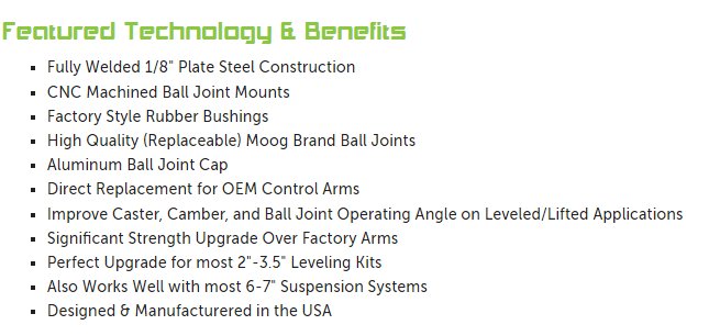

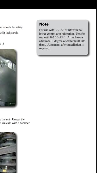

    How much lift are you running? Their site states not to use with 0-2.5" of lift, recommended for 3.0-3.5".
    Edit: another place they say it might work with other 2.0-3.5" lifts....oye

    3/1
    It actually is specifically recommended for a 2-3.5" lift when you have at least 6" backspacing on your wheels..
    Where does it say not for 2" of lift or whatever? I spoke with them on the phone before buying to confirm I wouldn't have fitment issues..

    In their install instructions,

    Ah yeah, didn't even notice that and I read those instructions.
    I spoke with them on the phone and told them my exact setup and they said I would be ok. I think that is probably a typo but I'm not sure.. For me they are working great with ~3" lift up front.
