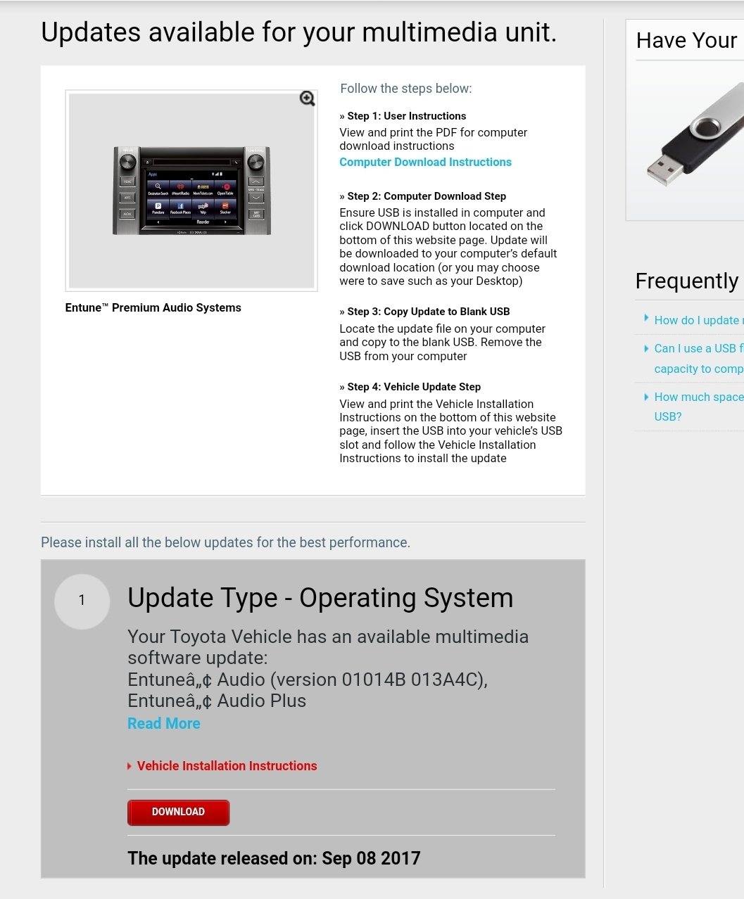

    Go to this link and select your option. Download the file and follow the directions on how to load it on your truck. The latest update was Sep 17. It made a big difference in my truck.
    https://securedp.toyota.com/download-app/downloads

  5. Sep 20, 2020 at 4:51 PM
    29,990
    I just checked for my 2018. It says there is an available update. Look at the date, 09-17-2017. Mine was made in March of 2018.:notsure:

    Yeah, the update I used was the same.

    I got a 16 pro and just tried, no luck here. I was able to follow the directions to get to a software update but it wouldn't allow from downloading directly from my phone plugged into USB. I got a message on my phone I don't have a program to open the download?

    You tried to use your phone as a USB drive? You’ll definitely have to use USB drive that has Fat32 on it.

    I followed that link and downloaded it on a flash drive. It’s letting me install now in my 16 pro
