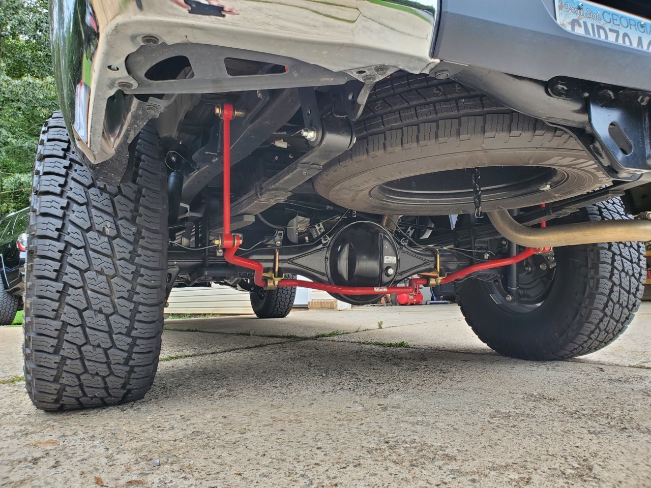

    I prefer the factory forward rake over dead-level... so my 3/2 Readylift became a 3/3 lift yesterday. Extended/raised the brake lines and added shock extensions while I was under there too.

    Have you considered rotating your sway bar mounts 90 degree so they are on the backside of the axle instead of the bottom? This would move it up and restore the angle between the drop links and the bar, you generally want this as close to perpendicular as you can. Side benefit would also be clearance.

    Yeah ive considered it... just havent done anything with it because its working fine as is for now. Thought about going on top or rear of axle... or making longer links.
    Looking again at the pic... reminded me I need a rear diff breather kit too.

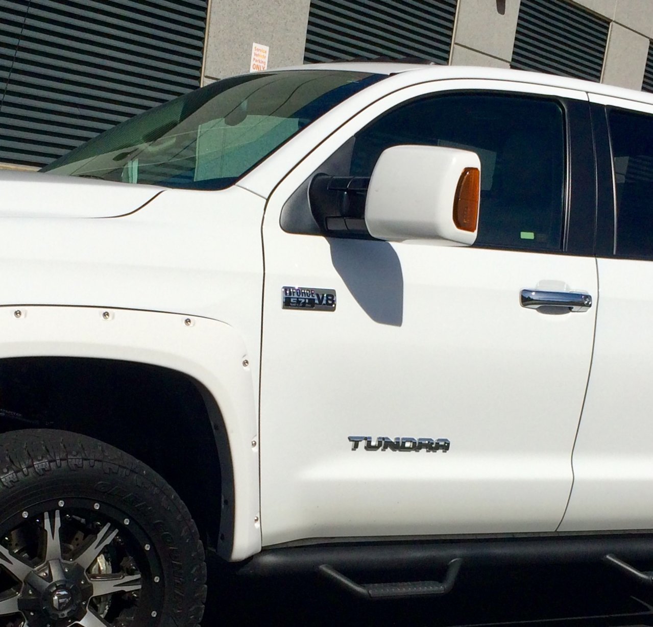

    I may have to be a copycat when my badges arrive.
    I have the tow mirrors but I’ve color matched the large part of the housing.
    How did you tint the turn signal on the mirror? Spray tint?

    The Trail Ridge tow mirrors from 1AAuto come with smoked lenses.

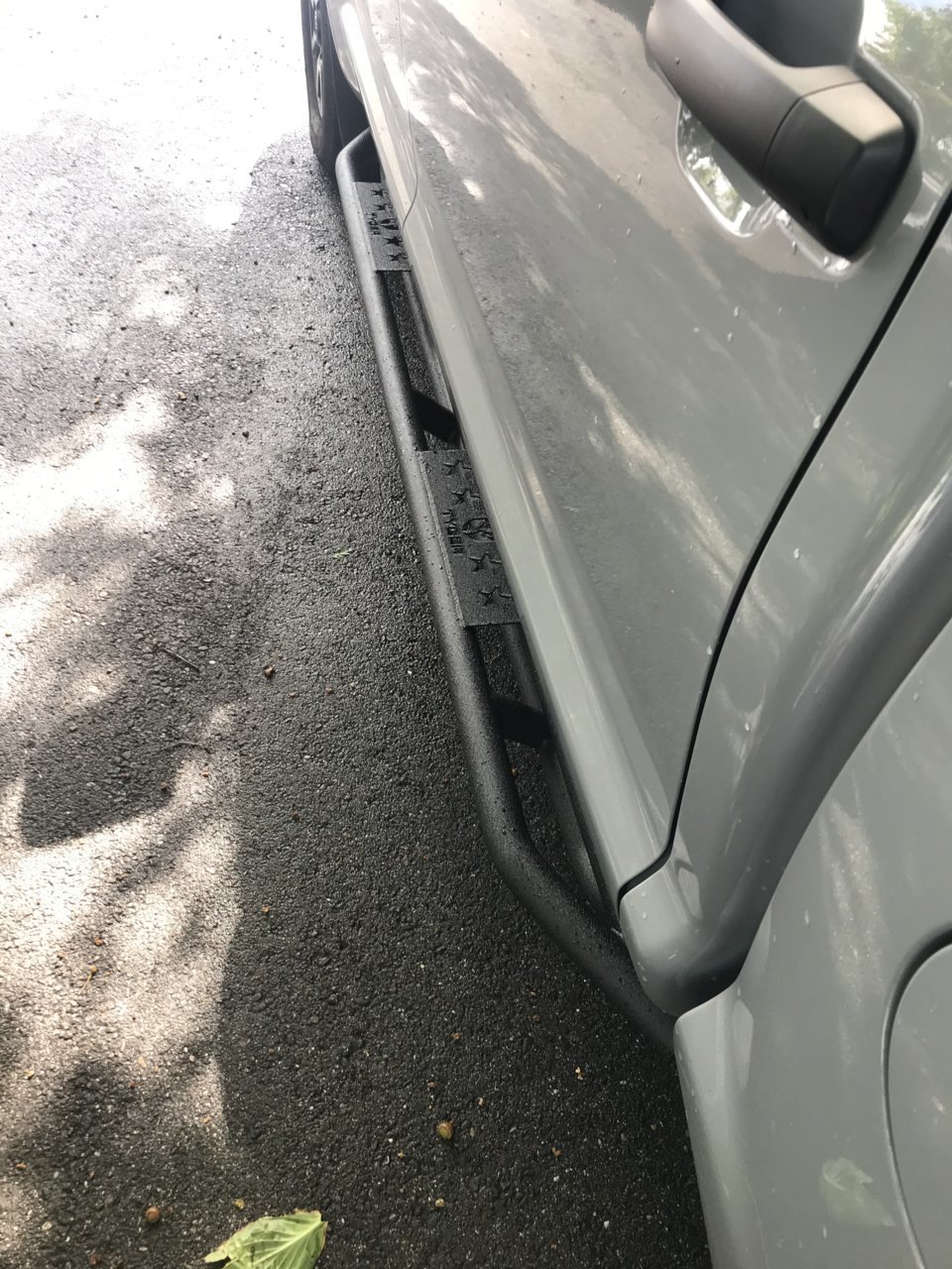

    A31BA4EE-E7D9-4A42-B615-9D4AEEFD9F9E.jpg 5CEE14B2-8E1C-4FAD-B112-7D15DB9D4CAC.jpg
    I had a knock off version of the oem runners; the powder coat started to peel and it was making me OCD so I ended up ordering the Tyger star armors from Amazon yesterday afternoons. They were in the porch by 8am. Just got finished installing them. They look great and feel sturdy as heck. Hopefully the powder coat holds up better on these.

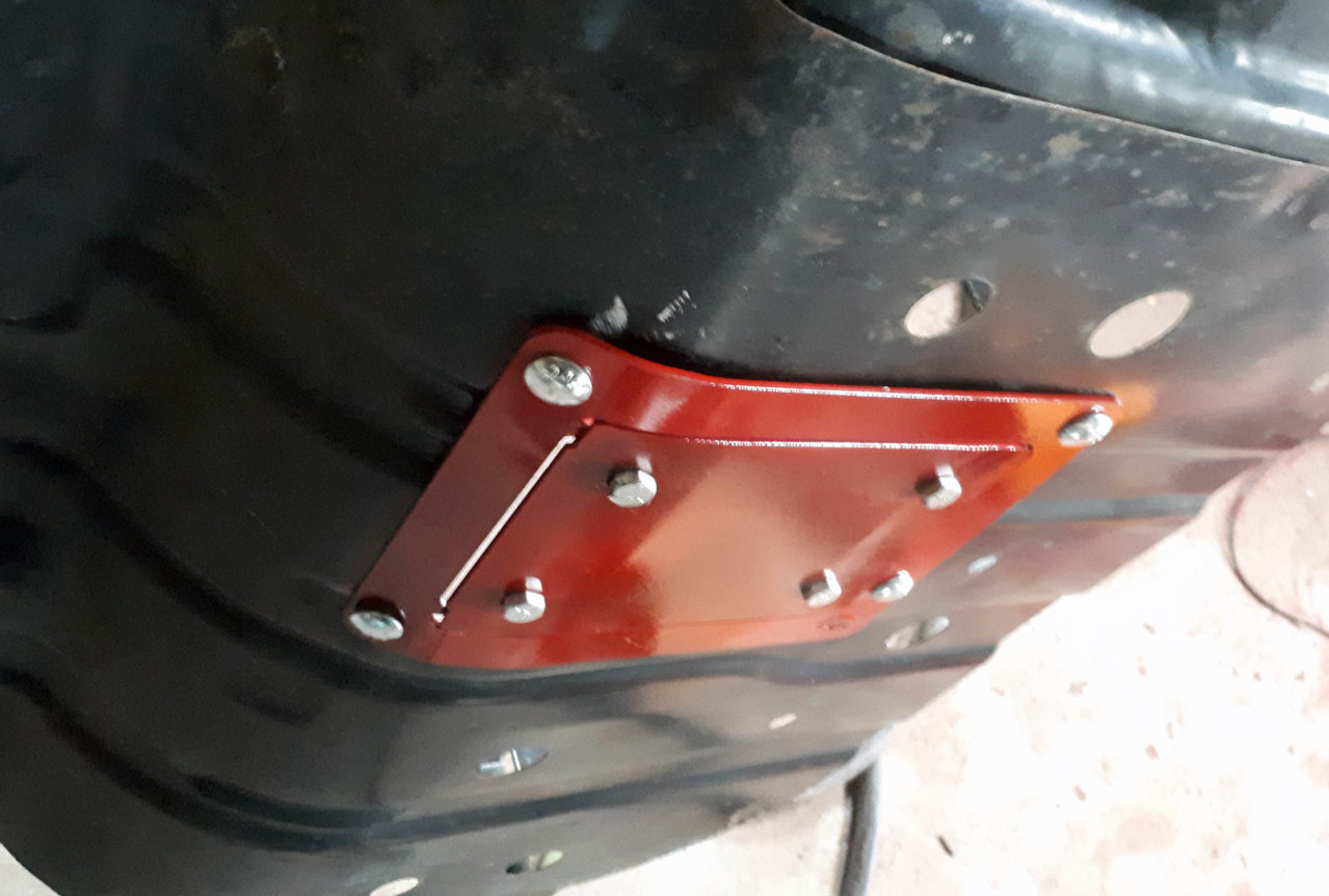

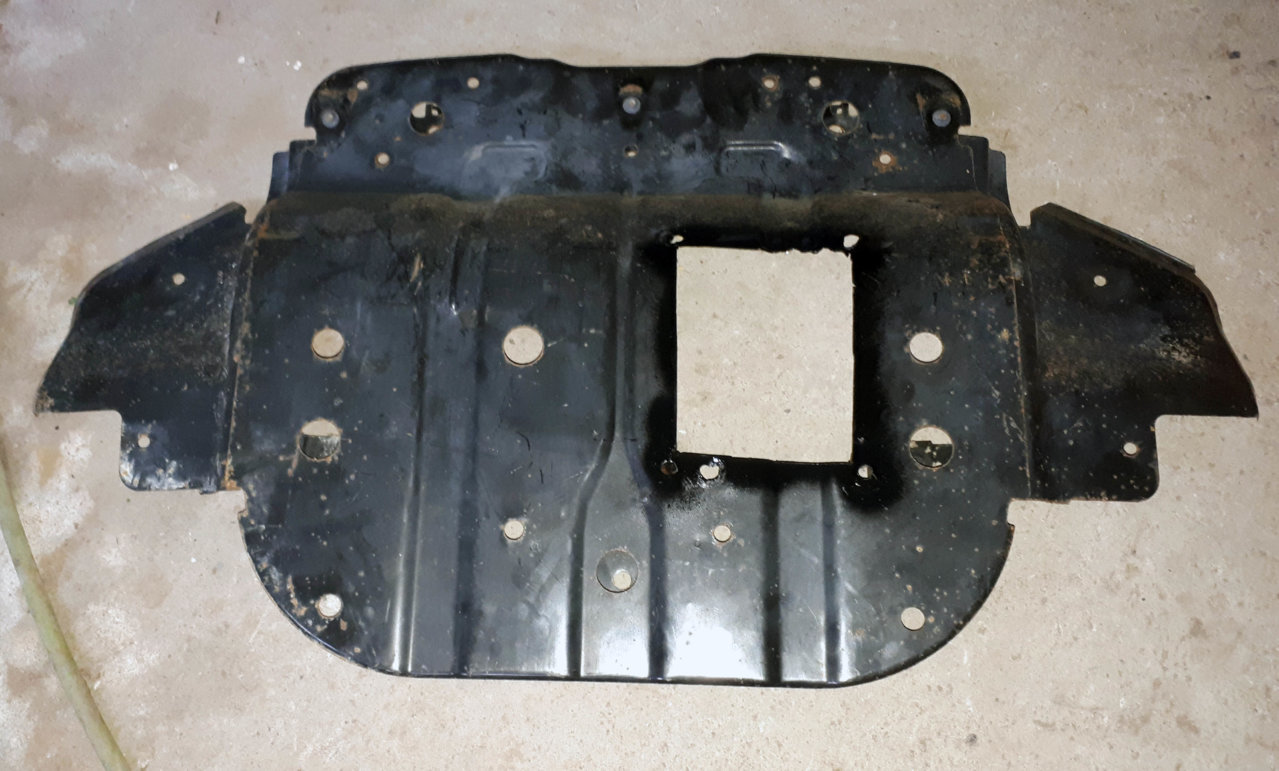

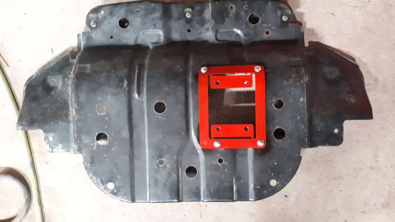

    After years of thinking of doing it (since my 2007 Tundra), I finally put together an access for oil changes in my 2018 Tundra. Just a prototype to try out as I had the plasma table and powder coating oven running for something else. Of course then it started raining before I could put it on...and I didn't the correct (stainless) hardware I will end up using.
    20200829_144325a.jpg 20200829_144339a.jpg 20200829_144750a.jpg 20200829_145015a.jpg 20200829_145028a.jpg

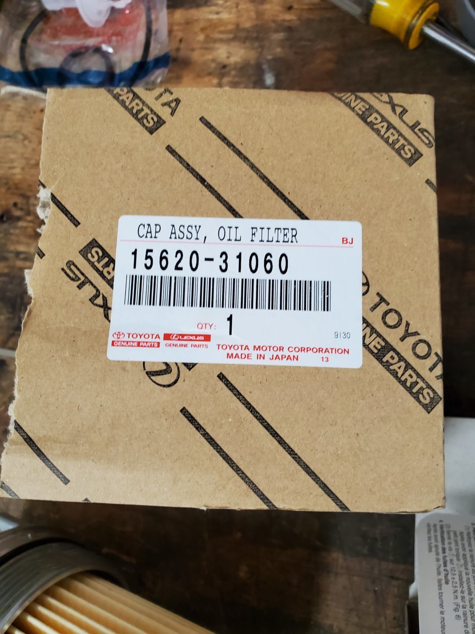

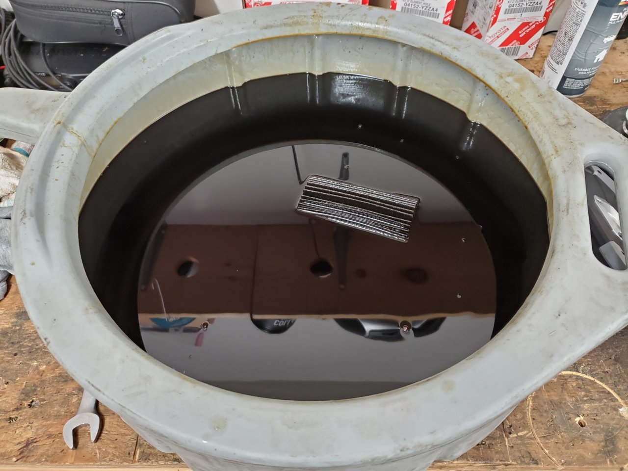

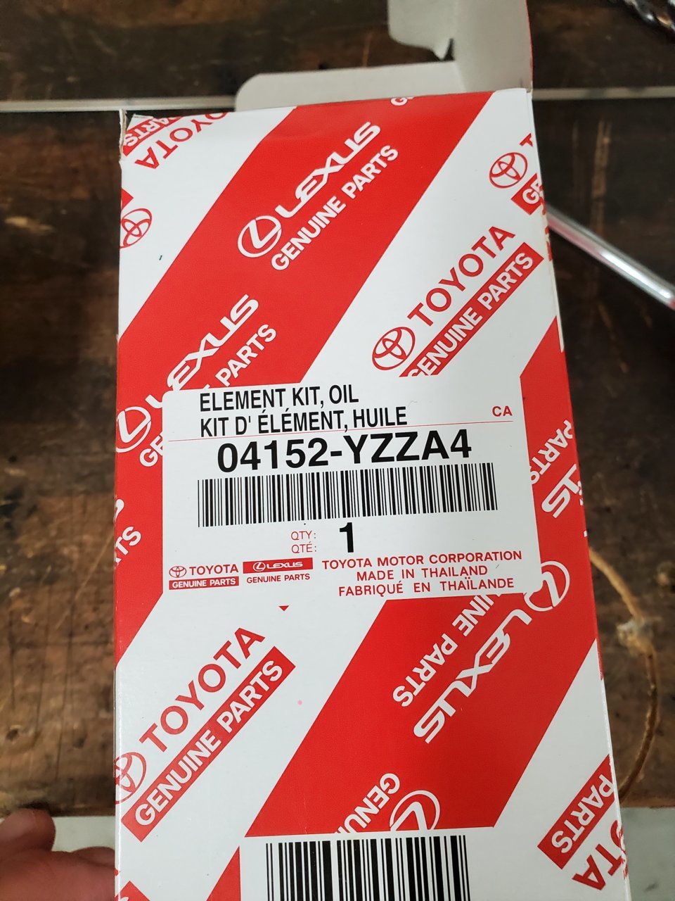

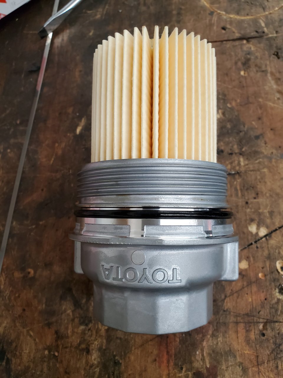

    Did the 1st oil change today at 4292 miles and upgraded to an aluminum filter housing.
    (Love my MAC filter socket.)
    I was surprised how bad/black the oil looked.

    Looks great. I'm planning on doing that pretty soon too. Care you share your dimensions? Or dwg if you have it?
