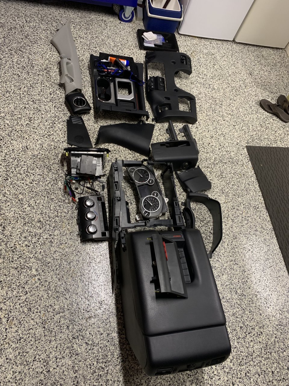

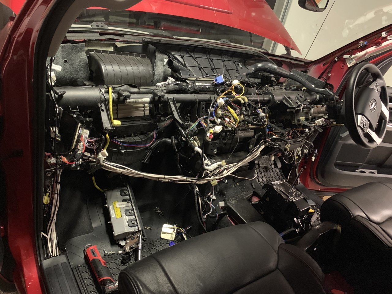

    So my dash could be different as it’s a fiberglass custom mold but here is what I remember from mine - should be close
    Remove the 2 screws by turning steering wheel to left and right and remove covers top and bottom.
    Remove 2 screws top of dash and remove trim around instrument cluster.
    Remove 4 screws from instrument cluster and pull forward.
    Remove 1x Wiring plug from rear
    Work the plastic cover off by pressing clips (About 8 maybe around the outside) and plastic cover will pop off.
    Rings around gauges are a press fit and lift off very easily. I first had these done in black but was too dark so I re did them in the red.
    Needles however were masked and painted black by spray shop who painted all trim for me.

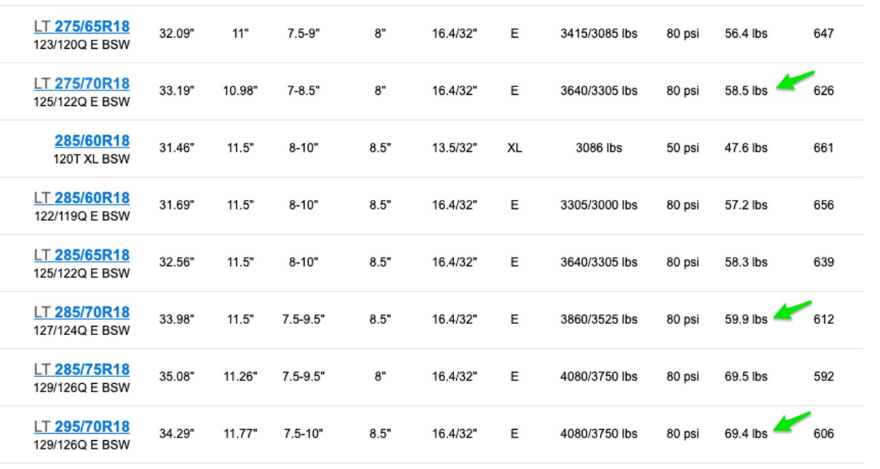

    No lift. Only leveled. 275/70/18s. If I could do it over I would probably pay the extra cost and go with 285/70/18s.

    Why not 295 70 18 out of curiosity....

    Not sure it would fit without lifting the truck, but mainly it is due to weight.

    Thank You for that information sir!

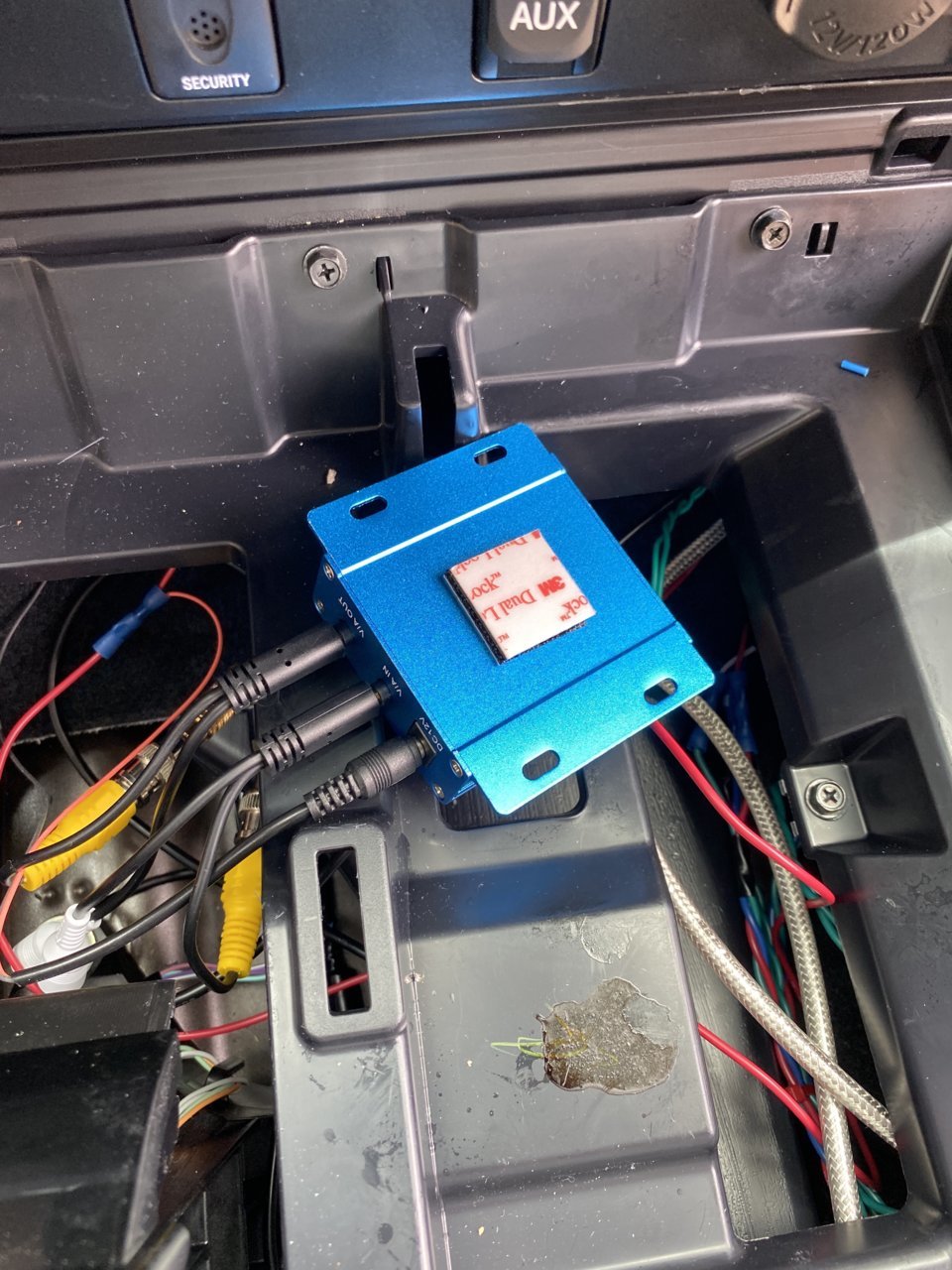

    Finished my FRAC install, need to move the camera out just a bit.

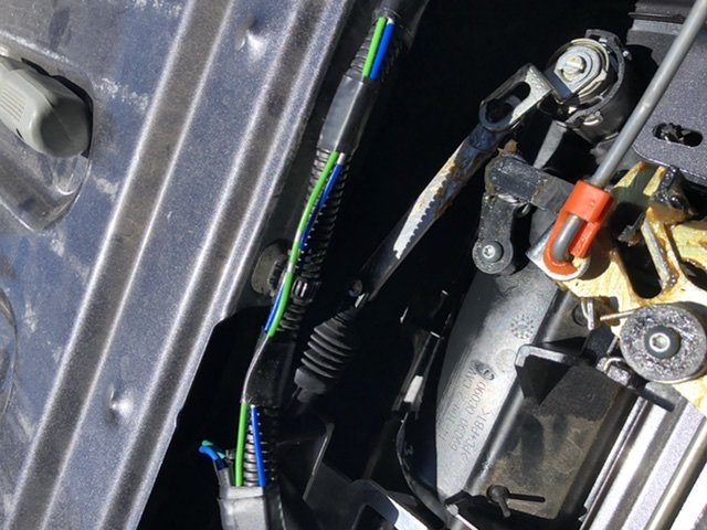

    08445C18-A28B-44C8-833D-F266D732B88C.jpg auto tail gate Lock

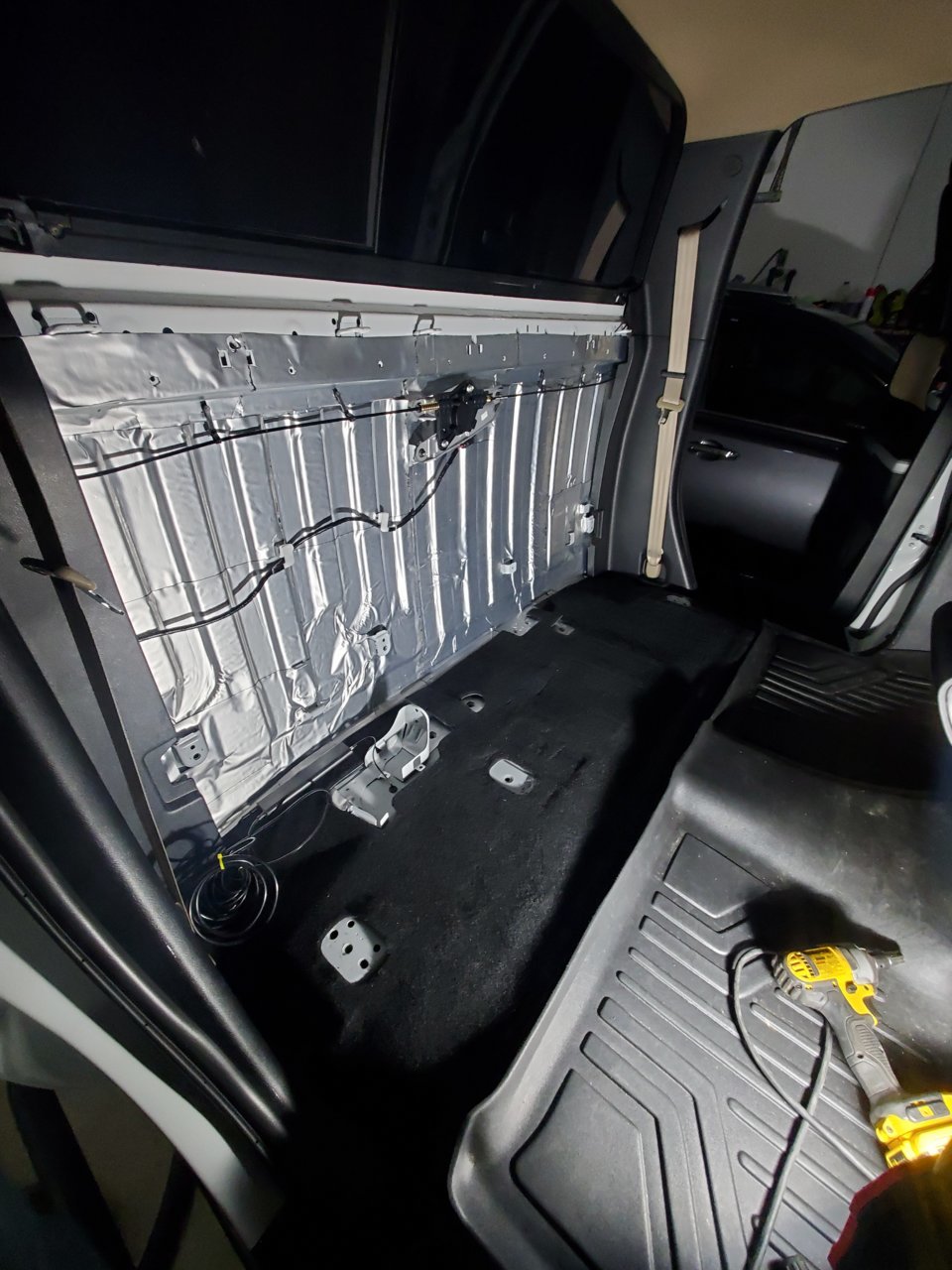

    Fatmat on the cab back wall. We'll see if it makes any difference.

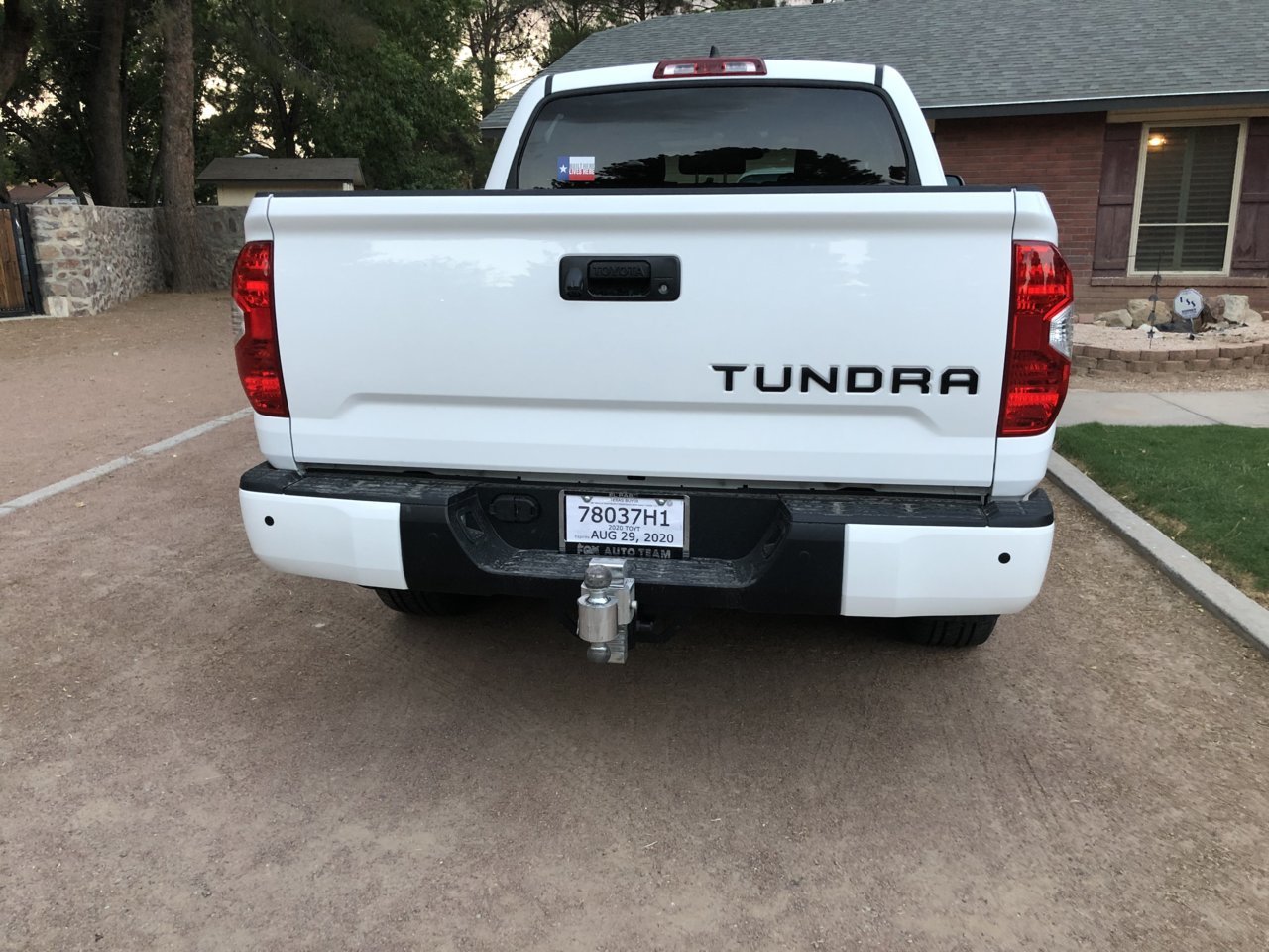

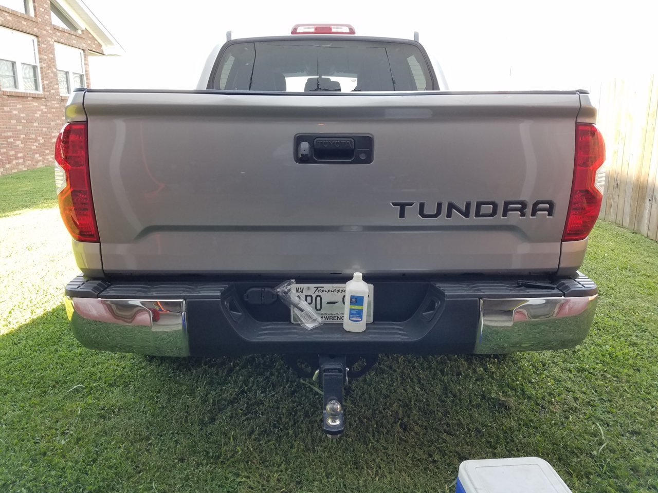

    Let the de-badge and de-chrome begin! FBD57BBC-DBCF-4871-A6AF-C30148FA7037.jpgCD4E7182-D92B-4A0C-AB91-051E1DF763EC.jpg35FD12AD-CAB6-45FA-B3A6-0A00D6933642.jpg
    Also, I’m going to attempt to Plasti dip my TRD wheels. If they don’t turn out well, I need some input on new 18in wheels. Black, gray, or bronze. Want to keep the 18in since I’m running 275 Terras. Thanks!

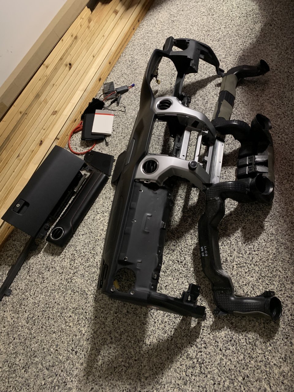

    A LOT... NEVER ENDS
    Makes my anxiety go thru the roof just looking this... totally worth it but DAYUM my eyes twitching
