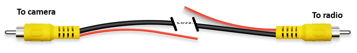

    Thankfully, your camera manufacturer has probably already done the hard work for you. Truth is, virtually all modern backup cameras have an embedded trigger wire bundled in with the video signal wire to help you with that task, it's often red in color, and will probably be a little straggler off the video cable like this, though I'll show you some other variations in a sec:
    That handy-dandy little red wire lead is your ticket to painlessly sending trigger voltage up to your head unit's reverse trigger wire, essentially negating you using an OEM reverse trigger wire as long as you attach the camera's power wire to your reverse light power.
    The reality is, 80-90% of wired backup cameras on the market today include that lead, although there are a few styles, see A/B/C variations below. Whichever of those you have, all you do is wire it up as-shown in each image, and no OEM trigger wire is needed, whatsoever. Granted, some cameras may have extra "loop wires" near the camera that let you change its behavior by cutting the loop, but fundamentally, you only need to connect a couple of wires as-shown to get your basic backup cam functionality working.
    with the B/C options above, it's just like what I showed/said before: As long as you attach the red pigtail to the reverse light power, it's going to auto-trigger your head unit into backup-camp mode once the reverse lights kick on.
    With the A option above, typically (always read the manual!), the power wire on the camera end will be twisted together with the trigger wire then connected to the reverse light power, then you just need to connect the other end of the wire to your radio's reverse trigger input.
    Generally speaking, referencing the above types (A/B/C), install should be as easy as:
    • Attach the red wire(s) at the camera end of things properly (i.e. use a Posi-Tap, because T-taps/Scotchloks/QuickTaps are reserved for absolute fucking assholes) to the positive wire of your reverse lights
    • Give the camera a proper ground, which can also be the ground for your reverse lights if you like (don't be an animal, use a Posi-Tap)
    • Plug the "To radio" yellow RCA end into the "Backup camera" port of your radio
    • Tie the "To radio reverse trigger" red wire to your "Reverse trigger" on your radio
    Literally. That's all there is to get your camera to turn on while in reverse, when it turns on it'll start feeding video over the RCA, and b/c that little red wire is getting 12v at the same time as your camera, it's going to fire off 12v to your radio's reverse trigger wire, telling it to wake the hell up and show that video feed!

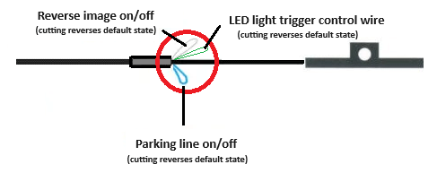

    On my end, @daveeasa's DIR harness made this a snap because it came with a waterproof tee fed off the reverse lights with ground/power leads to turn on the camera when reverse lights are on. I don't know if Dave is still making the DIR harness at the time you're going to be reading this, he may be retired already (what an old fart! :rofl: ), but it's a genius idea, I didn't need to run a wire to my frame for my camera to get a good ground or Positap into my driver's side reverse light to feed it power! The DIR harness also disables the tag lights when reverse is engaged so you don't get extra glare from the nearby tag lights if you go with a license-plate mounted camera.
    Essentially, with my Boyo camera, this was my configuration, with the blue stars being my only crimp points - there was no need to find any special wires or crap, this camera comes with a reverse trigger, and by teeing power/gnd off the reverse lights, simply throwing the vehicle in reverse powers up the camera with the lights, and the camera's reverse trigger tells my head unit to come on + display camera feed:
    Note the three tees (blue / white / green) on the camera diagram above. It's confusing seeing those as a straight line, so I'm embellishing on that a bit in this next image. Every decent camera should have those, essentially tiny 22awg(ish) wire loops as shown here, often with labels. You can cut those loops to change properties of the camera. I would ignore those during your install, but ... say your image is reverse of what you expect after install, you could cut find and cut the "reverse image on/off" (white loop in this example, yours may be diff't) to reverse the image being sent to the head unit. You may or may not actually need to do this, many quality head units have an option to reverse the backup image, but it's worth noting you can change the camera functions by cutting those loops AFTER install, to modify the way the camera functions, from the iR/LED light functions, to the camera image output position, or to turn on/off parking guides, but note: Many head units automatically add parking lines! I don't recommend EVER cutting the parking lines loop wire on your camera unless you're 100% sure your head unit isn't adding lines in first! My Alpine auto-adds lines in.
    I ended up using my Valorbe files (thinking about you, @Professional Hand Model) to notch my license plate frame so I can run this down thru the hole directly behind the plate, along with the tag light harness.

    This is what the end result looked like back there. Obviously, I had a little extra, but I couldn't crop anything because the trying to splice the tiny ass wires in this harness would've taken too long. So it's taped and zipped nearly up into the corner, and I tagged into Dave's power over there. Got sloppy with my taping on that, but I was getting eaten by mosquitos and ready to be done. This specific camera came with a green lead on the camera pigtail which is used to turn on its integrated LEDs (you can see those LEDs on the license plate pic above), and that got crimped in with the camera power, so the camera and LEDs come on at the same time.
    Turned off the bullshit cones, buttoned the dash back up, and admired my work. Not the best picture in the world with the sun blasting at it, but hell if it doesn't work. I'm hoping the camera lead is semi-universal, maybe I can upgrade to something better later. (Troubleshooting info on the other side of this last picture!)
    Some troubleshooting info!
    I can't recommend enough you test the camera BEFORE you fully button everything back up. Let's be real: Most cameras only require making 4-5 connections to function, meaning the tedious part of install isn't so much "how do I wire this", it's "how do I safely get the signal wire up to the dash"?
    In the event things aren't working, where would I start with troubleshooting?
    • Make sure the camera didn't come with a protective sticker over the lens that may be blocking it from seeing anything.
    • Double-check to make sure you plugged your video signal cable into the correct port on your stereo; many cameras these days support multiple cameras, and may have multiple RCA tails you can plug into. Check this first, to make sure you're plugging into the "reverse camera" RCA on the stereo end
    • Verify you correctly hooked up the reverse trigger wire for the camera to the correct reverse trigger wire of the camera (this may require breaking down and RTFM, you know, checking the instructions for your camera?
    • Verify the camera ground is good, this is especially important if you grounded to the body or frame of the truck, and if you did exactly that, make sure you're making bare-metal-to-bare-metal contact, you're not mating a ground wire to painted metal...
    • And finally, verify power to the camera, let's get into that now!
    Power-wise, and this is specifically geared towards folks who are tapping off the reverse lights to get power, I'd check:
    • With the e-brake on, truck off, and shifted into reverse, do the reverse lights turn on? If not, maybe you forgot to remove the negative battery cable before install and managed to blow a fuse?
    • If the reverse lights **DO** turn on, and you're tapping both +/- off the reverse light wiring, is it possible you reversed the +/- wires? A voltmeter/DMM to check for voltage with the e-brake on and truck in reverse may answer that question rapidly....
    • ... Or maybe you tapped into the wrong colored wires? Tail/brake/running/blinker light colors can vary from year to year and cab to cab. Wouldn't it be funny if the camera turned on every time you tapped on the brakes? (Yes, I've seen it before)
    • Or maybe your Posi-tap connection is bad? Did you tug-test your Posi-Tap(s) after installing them, and confirm they're fully twisted down tight, so it pierces into the wire fully?
    • If your camera has dedicated LEDs around the lens, you may be able to check if those are lighting up while the e-brake still on and truck is in reverse.
    • If all else fails, and you're 100% positive the RCA is connected to the correct port on the head unit, you're 100% positive the camera's reverse trigger is connected to the correct colored wire on your head unit, and you happen to have access to a smaller 9v or 12v battery (the kind of 12v you find on motorcycles, electric lawn mowers, in house alarm boxes, and in computer battery backup UPS units) with a confirmed voltage reading, i.e. the battery is 100% good, then ...
      • Try attaching the (+) wire to the battery - which may include the camera's (+) wire and its trigger wire together on the positive side of the battery, then attach the negative (-) last
      • Do you get a picture on the head unit while NOT in reverse?
        • If yes, you probably need to use the powers of logical deduction to understand why it works with external power, but not on the truck's power (hint: It's probably installer error)
        • As an added bit of data, test again with it in reverse. Does it work?
        • If it doesn't work in either above case, do you have an external TV/screen/monitor that accepts the camera's RCA? If yes, try plugging the camera's video RCA into that external TV/monitor to see if any video shows up on it.
        • If it works on an external screen, but not the radio screen, there's a strong chance the issue is either the radio's video input or its reverse triggering or possibly the radio has a setting to turn off the backup camera feature (yes, it's a thing on some radios)
        • If it doesn't work on the head unit nor an external screen, there's a solid chance your camera is DOA.
    Hopefully this helps demystify this process a little bit.
