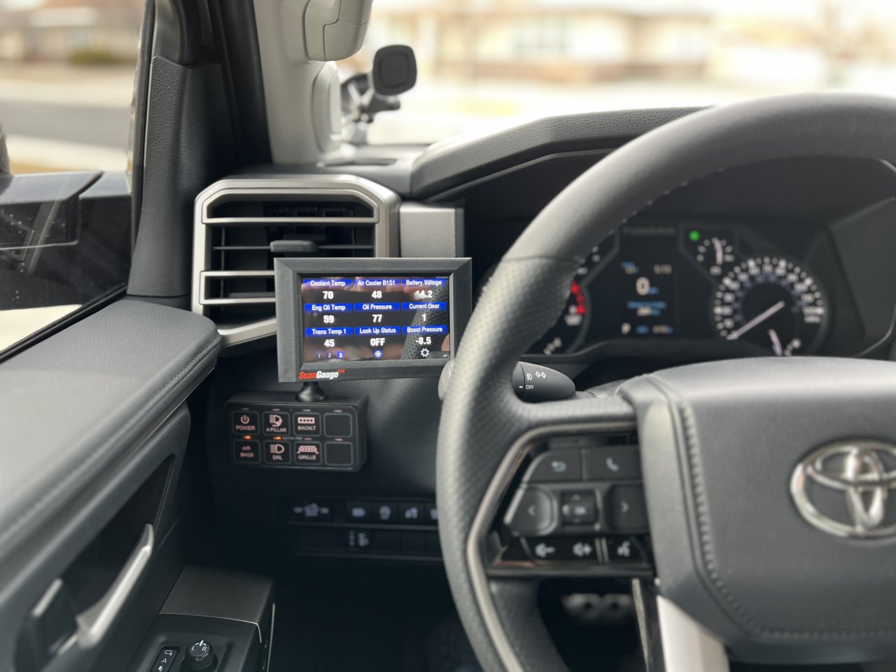

    FWIW I average about 13 PSI oil pressure at idle with the engine operating at temp (~190-210*F oil temp) while cold start temps are much higher at around 50-75 psi depending on just how cold it is outside.
    Now I don't have the digital cluster but with the analog gauge reads just below the 1/4 hatch mark when running at ~13 psi and at, or just above the 3/4 hatch mark during most start up conditions.
    I have a ScanGaugeIII that I use to monitor the different engine and transmission sensors while towing. So far it works really well.

    13 PSI i'd consider low.... But thats my opinion as somone you dont know. LOL As engines age their oil pressure drops too.
    I'm still working on getting my OBDLinkMX+ to read toyota data correctly. I can get temps but not pressure as pressure is a non standard OBD info (according their support)
    Cant say I can recommend this particular bluetooth diagnostic tool as its been lacking current updates. Ugh.
    Anyway, low oil pressure and low viscocity oil (0w20 is recommended) doesnt sound like a long healthy environmwnr for a turbo motor.
    As the oil is used its viscocity can drop. When I did my first oil change at 9xx miles the oil came out like water.
    5w30 synthetic might help a bit with the oil pressure.

    I was a little shocked when I first saw the idle pressure, but it tends to stick around 13-15psi at idle, once warmed. Maybe someone around here has access to a FSM. There would likely be an oil pressure specification for engine idle speed.
