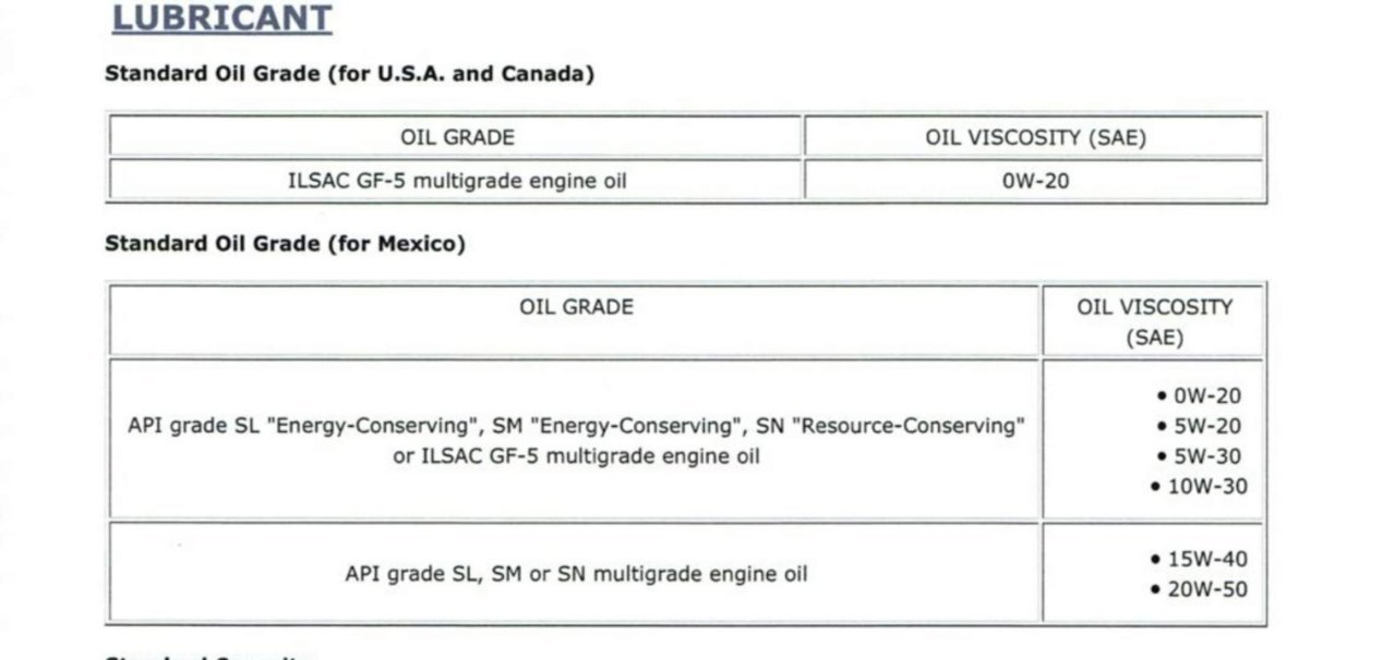

    The shop manual allows for a wide range. Choose what best suits the climate.
