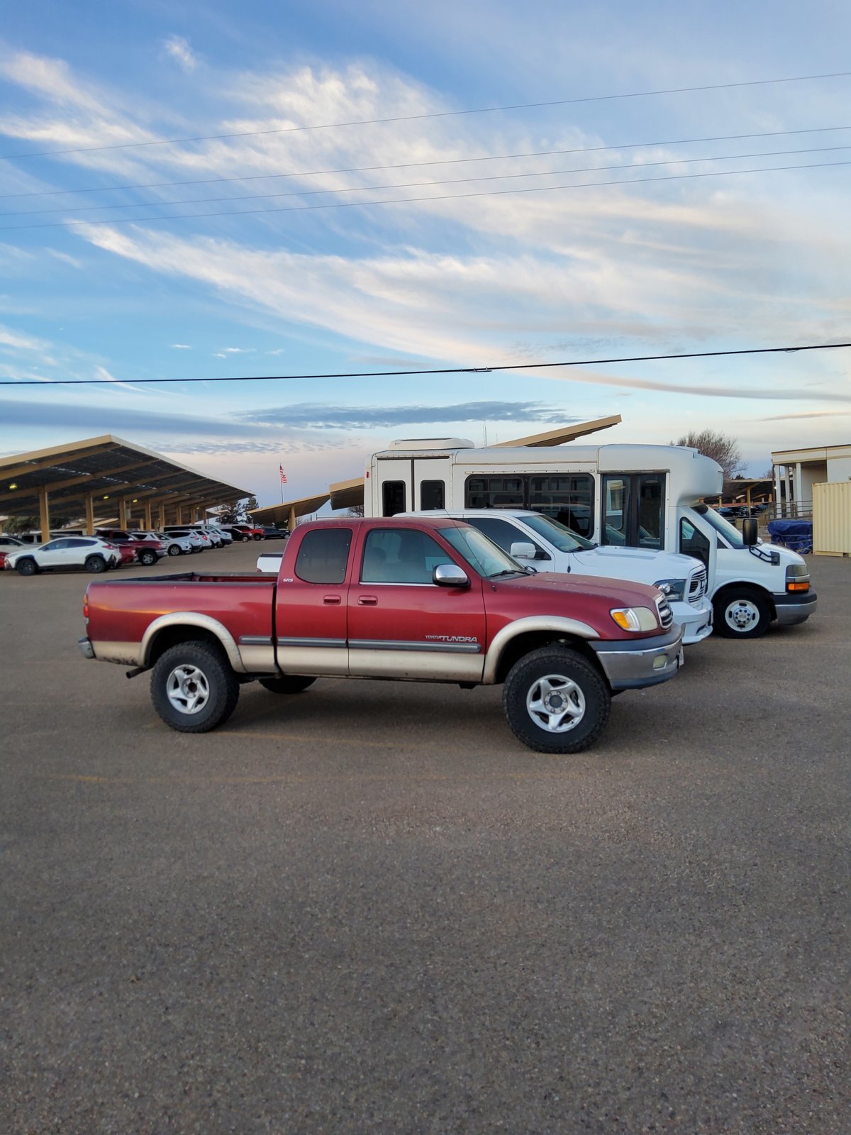

    Regarding you AC, have an 03 AC 4x4 V8 with stock UCAs using front adjustable shocks and stock springs. Have run 33s at 2.5-3" lift (but could choose between 0-3") and kept mud flaps with no spacers running Toyo A/T II and Pathfinder AT.

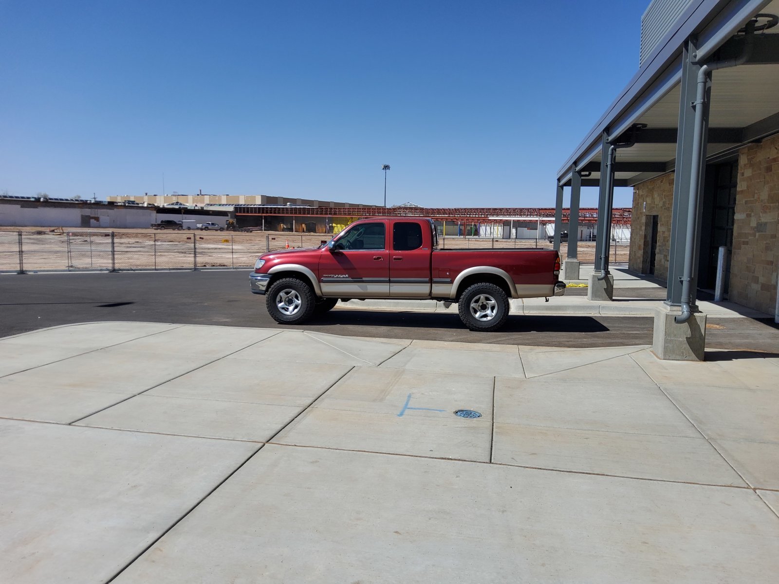

    Full specs:
    Toytec Boss at about 1.5" lift with 650lb springs
    Freedom UCA
    Stock rear
    New EVERYTHING front and rear
    1.25" spacers
    255x85xr16(33x10x16) Cooper st maxx tires
    I rub on the pinch weld on the drivers side on left turns, mainly due to bad alignment. If I'm turning at full stuff it rubs bad, and the pass side will rub slightly. With a good alignment and a touch more lift it wouldn't rub at all.
    Just a side note, it will be higher in the frontfor a while until the new springs settle. This was right after install:

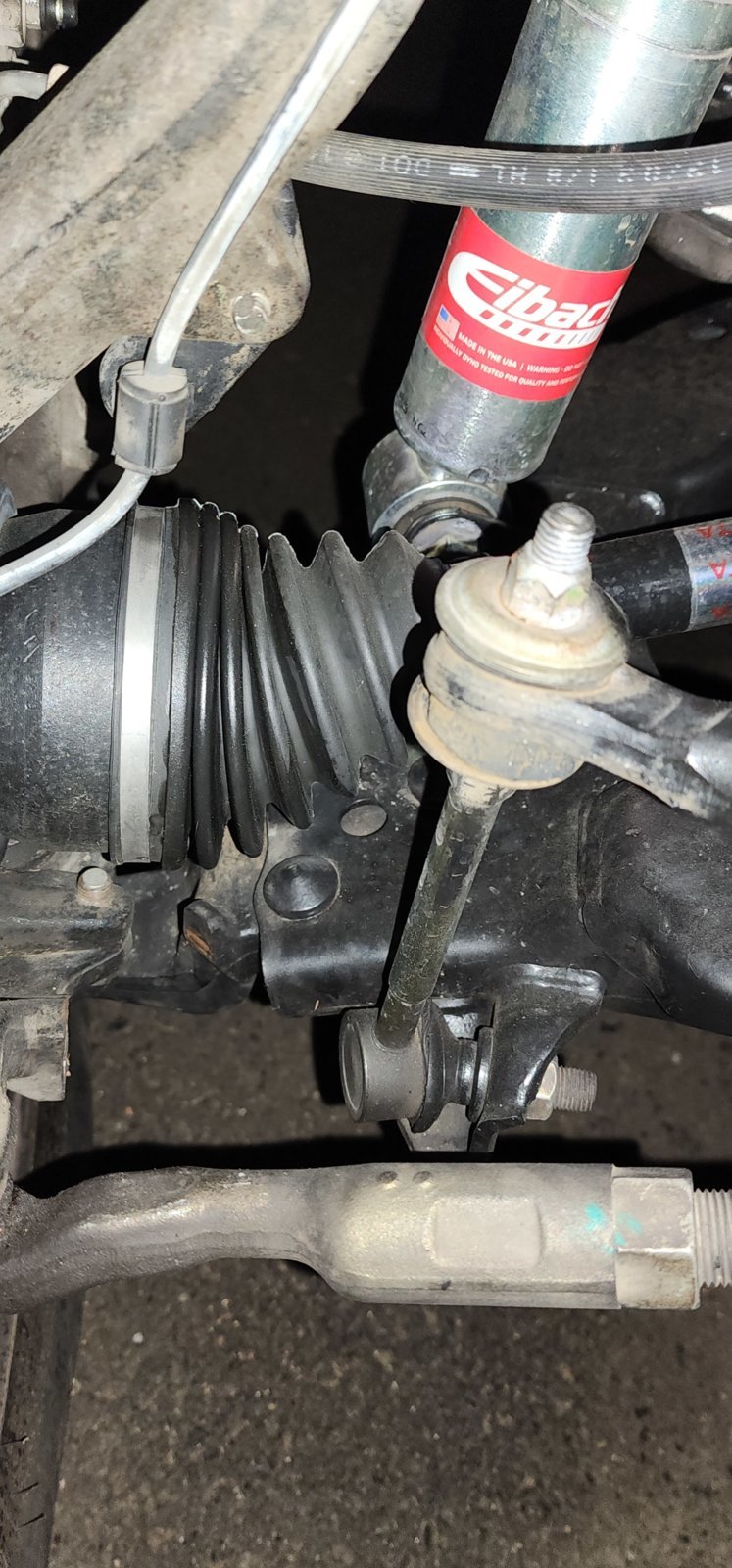

    Regarding sway bar links; in my personal experience you should run extended links even if all you're doing is leveling the front end. My brand new replacements didn't even hold up a few thousand miles. Go with the Suspension Maxx.

    I'm probably going to go ahead and do that, because when I got home today I was taking a look at the underside of my truck and realized my driver's side sway bar link is broken.

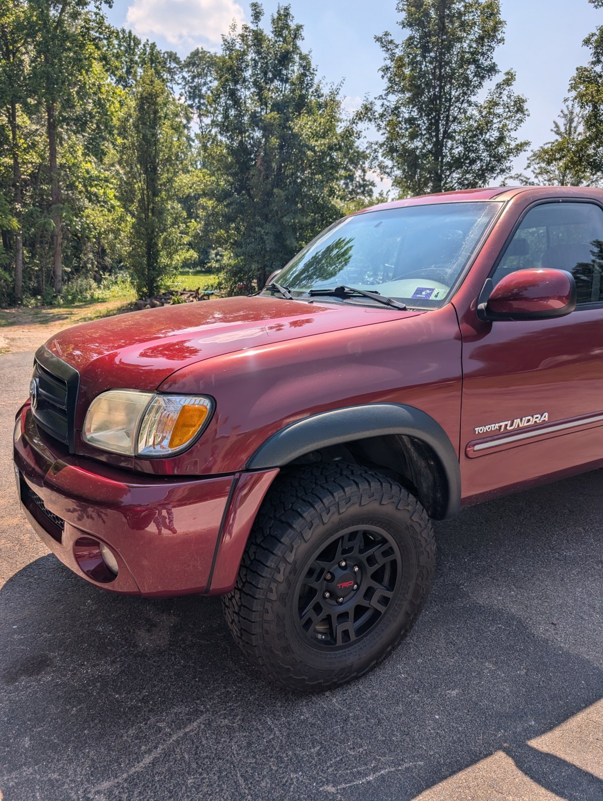

    I ended up going with the Bilstein 5100's and just reused the OEM springs and also did the suspensionMaxx extended sway bar links.
    As far as I can tell so far pretty much no rubbing at all unless I'm at full lock on a turn which isn't very often.

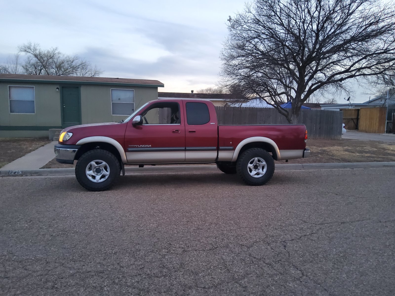

  19. Jul 9, 2024 at 5:26 PM
    #49
    LWC3
    LWC3 [OP] New Member
    May 29, 2024
    #117628
    19
    Lawrence
    Red 03 tundra 4x4
    Interior LED upgrade

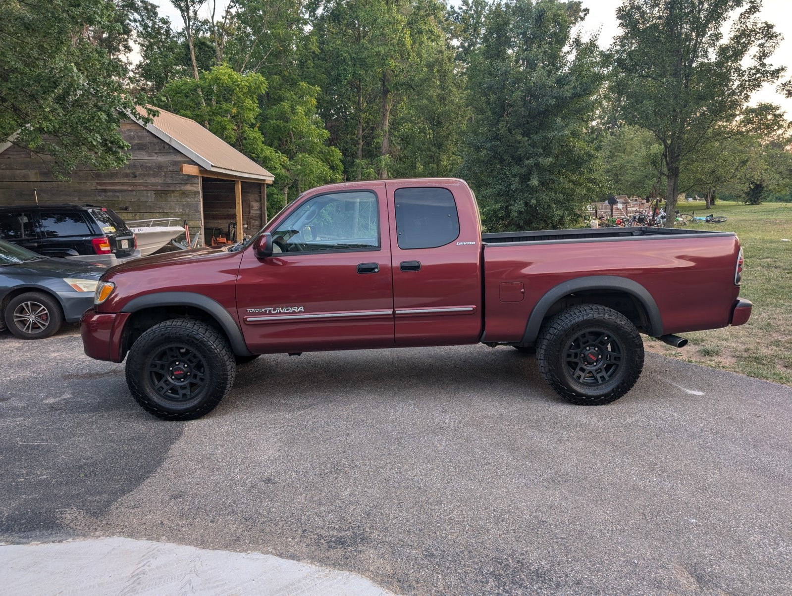

    Here's what I've got.
    Hutcheson and whodatschrome like this.
  20. Jul 9, 2024 at 5:32 PM
    #50
    shifty`
    shifty` I'm having daydreams about night things
    Jun 20, 2020
    #48239
    28,456
    ATL
    '06 AC Limited V8/4WD
    That looks f'n sweet dude. I hope it drives equally nice. We've heard mixed reviews on ride comfort using anything but bottom notch with aftermarket/lifted springs, and above the 2nd or 3rd notch with OEM. I'm super curious how you're feeling about all of this after putting a few hundo miles on it.
    But as it sits, that looks really, really nice.

    I actually have an hour drive back and forth to work everyday and I've been driving my truck with the new setup for the last two weeks. Everything feels really good so far The bigger tires definitely are louder though, but not to a point point where it's anything unbearable.
