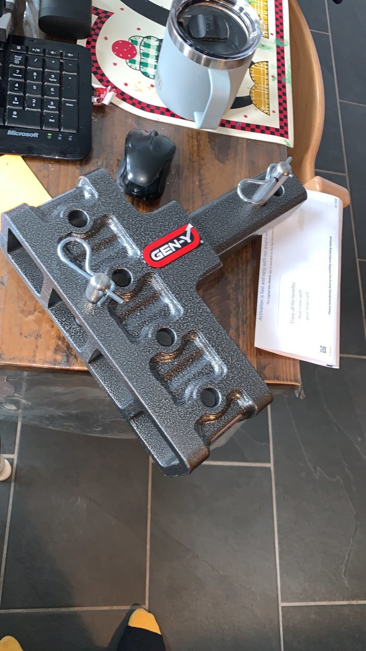

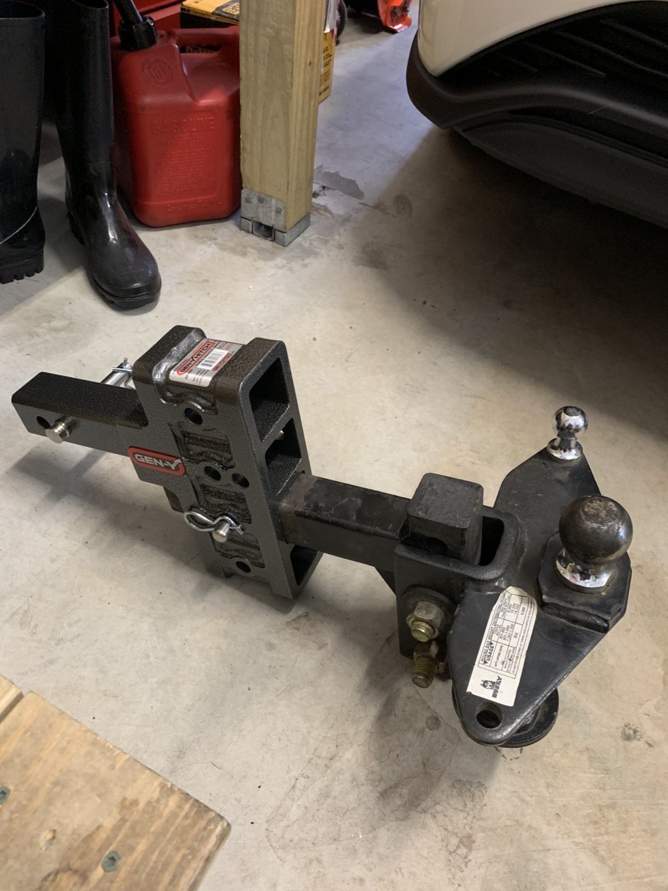

    Here’s mine , not totally leveled , got a gen-y drop hitch, will be testing it soon

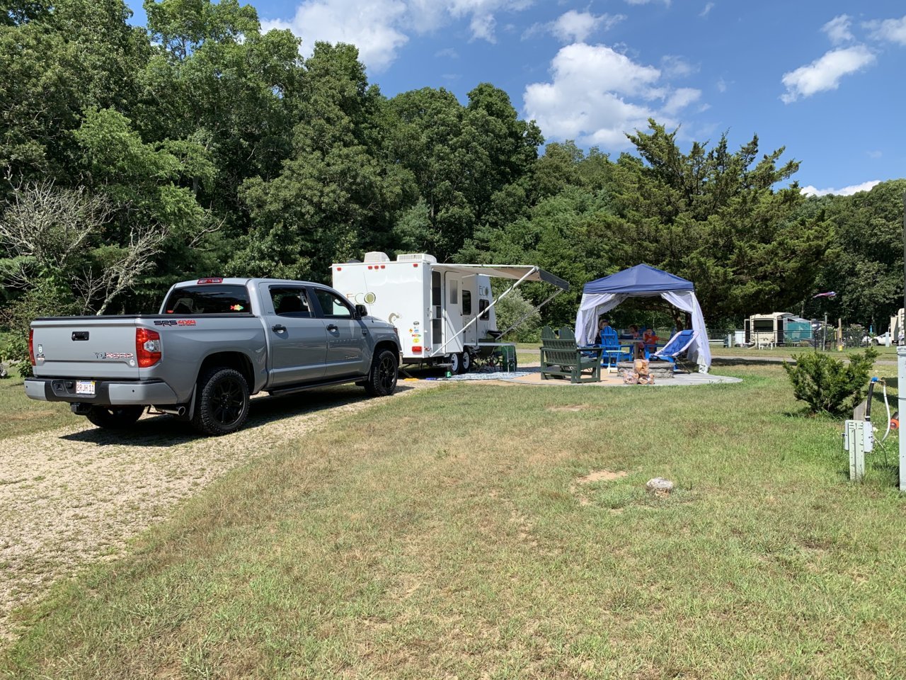

    I kinda want one of those tent canopies. How much time/trouble is it to set up? Can I do it alone?

    These are awesome , takes 5 min with me and the wife to put it together , you can do it alone but it is much easier with 2 persons . I believe I payed 60 for it and an additional 25 for the net , got it form job lot , totally worth it especially on those rainy days

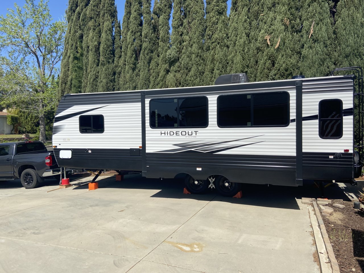

    Well, since I started the derailment... Here's the new one that caused it all... Keystone Hideout 27RLS

    Nice trailer man, how long is it?

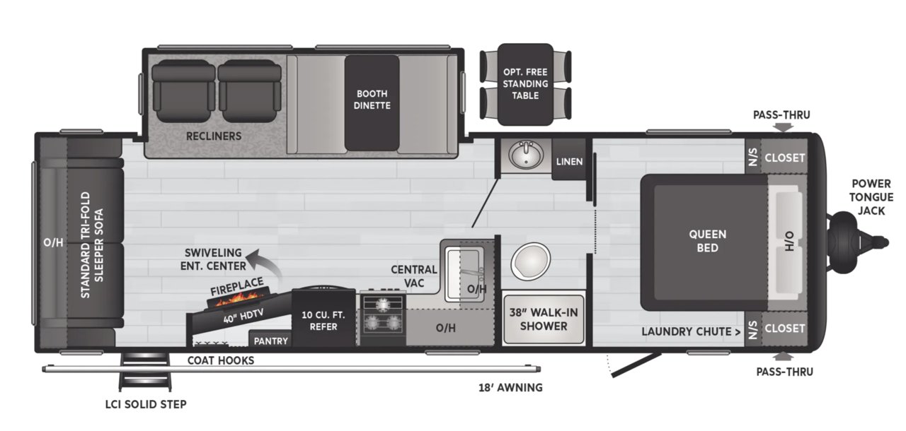

    Thanks! 31' 11" total. It has a killer layout inside. We traded in one with bunk beds because the kiddos never slept in them.

    Just curious of what sleeping arrangements you have for the kids in that layout?

    The sofa turns into a bed, as well as the dinette. There's also plenty of room to put down an air mattress if needed. (or with us of course, they're still little)

    Got the drop hitch , should get the trailer leveled

    stupid question, but wouldn’t it be better to get a hitch shank with more adjustment for the WD hitch as opposed to the separate attachment?

    Yes ,but I got another utility trailer that I will be also using the drop down hitch for , was cheaper for me

    My TT has such a short tongue one of those would be a benefit to get more clearance for the bikes hanging off the back of the truck!

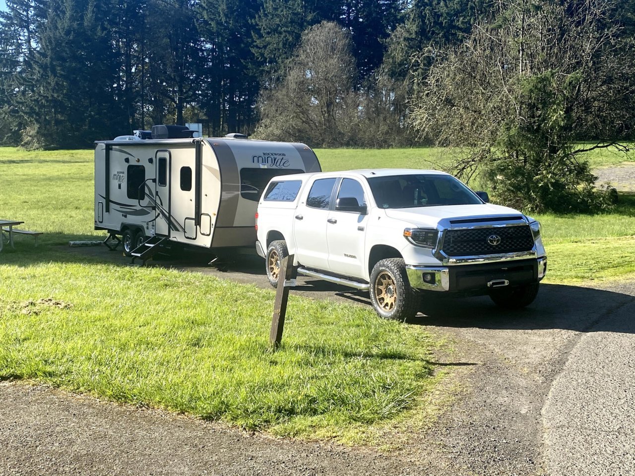

    I just picked up my new Rockwood Mini Lite 2403KS last weekend its specs are 4600lbs dry, 6600lbs max, I had added Firestone airbags and found that I really didn't need them with the included weight distribution hitch she towed like a beauty. Now to load it up with 1900lbs of junk and try again!
