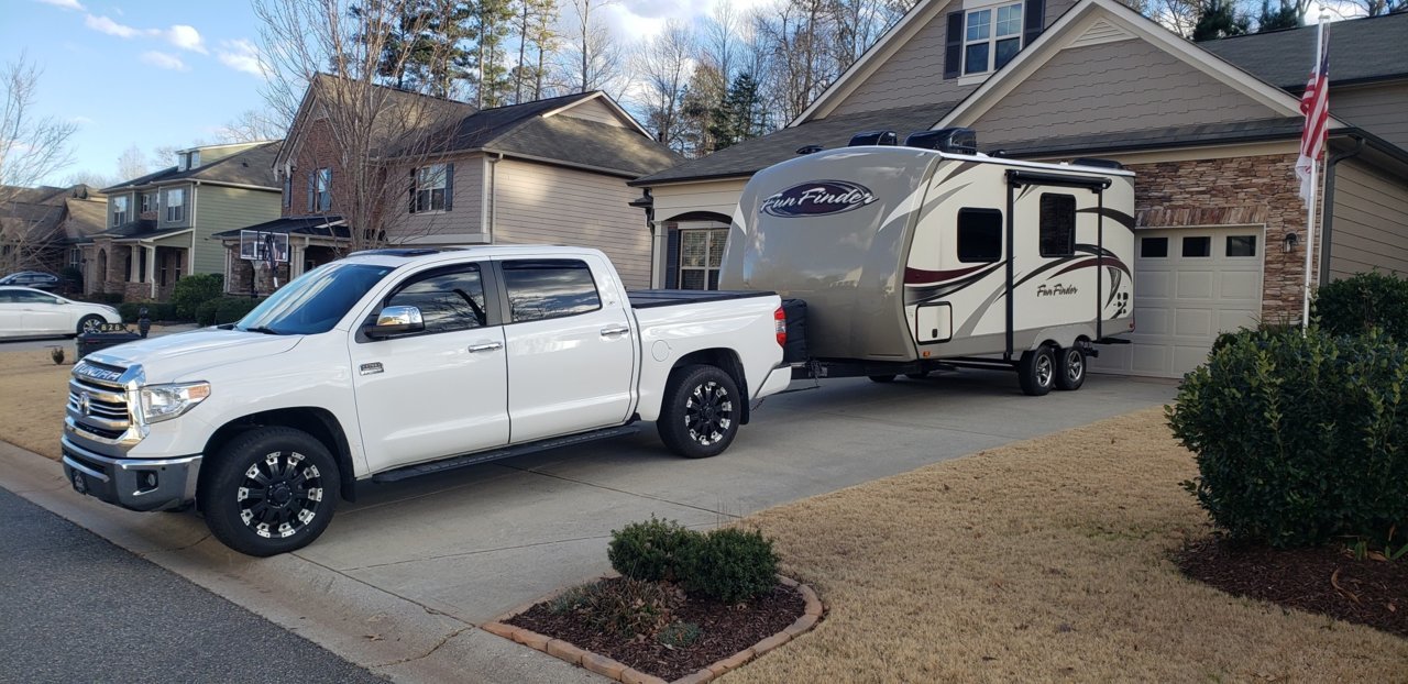

    What leaf did you add? My trailer is only 3,900lbs, and the truck pulls it with ease. I used to pull the trailer with my 2010 Taco 4.0L with tow package. I upgraded to a completely new lift/shocks/springs and had a much better towing experience. Not looking to add any/much height to my Tundra, but I do like the little bit of extra firmness when towing. Thanks!The Duke wTrailer.jpg

    Why did you choose Firestone? Do they eliminate the need for my load distribution set up?
    Bigboitundra and Prostar 190 like this.
  13. Jan 25, 2021 at 6:06 AM
    #2503
    77,066
    I went with Firestone because you don't have to drill the frame to install the bags plus my brothers had them on his 1 ton for 20 years with zero issues. I don't pull a camper but I do pull a 22-ft car trailer and a boat all the time. Which on those you don't need a weight distribution hitch so I can't answer that part.

    You shouldn’t need to be using a weight distributing hitch when towing less than 5,000 lbs.

    Never heard that. Always assumed it was good to use it. That said, I've never owned a truck this big. I had an 86 Toyota p/u, a 2004 Tundra, and a 2010 Taco. Always used load distribution. Using it on my 2017 reduces sag.

    I don’t think I’ve ever seen axles further back on a travel trailer. Have you ever checked the tongue weight? My guess is that it is significantly higher than the standard 10% because so much of that trailer is in front of the axles.
    You can continue to use the WDH but your truck manual will tell you it is not necessary for trailers less than 5k lbs but that assumes your tongue weight is within the 9-11% spec. If your tongue weight is more than 15% of the total weight I’d try to move heavier items to the very back of the trailer for a more balanced towing experience.

    It's not unusual. The box is just under 18'. Most of the weight (slide, kitchen, fresh water tank) sits over the two axles. Mfr recommends not putting too much additional weight up front for obvious reasons. If you compare our size TT to like size TT from mfr such as Winne, Jayco, etc axle(s) in basically the same loc - especially if there's a slide.
