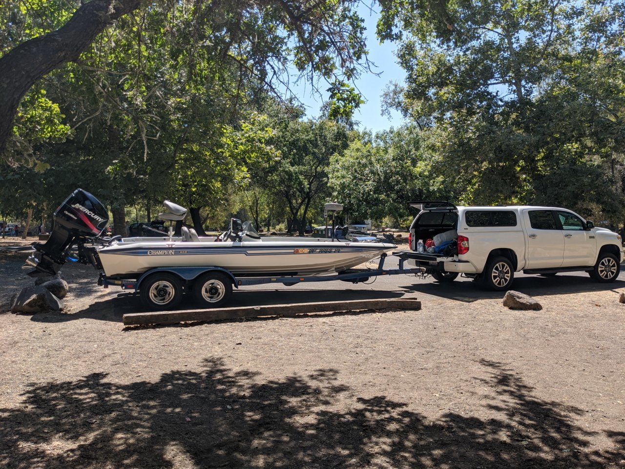

    First camping trip with the tundra towing my boat to Clear Lake. Fishing was awesome.IMG_20200809_143931.jpg
