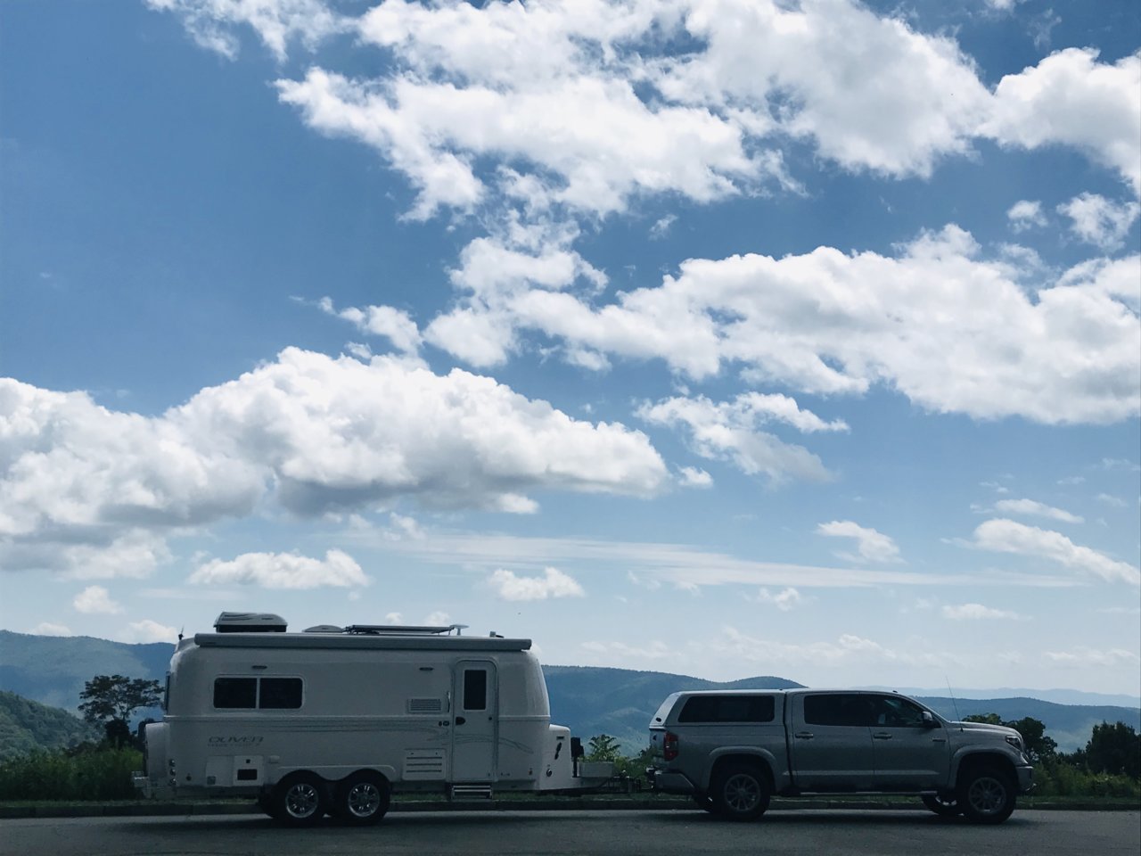

    Blue Ridge Parkway last week-

    Need details on that trailer...looks very cool.

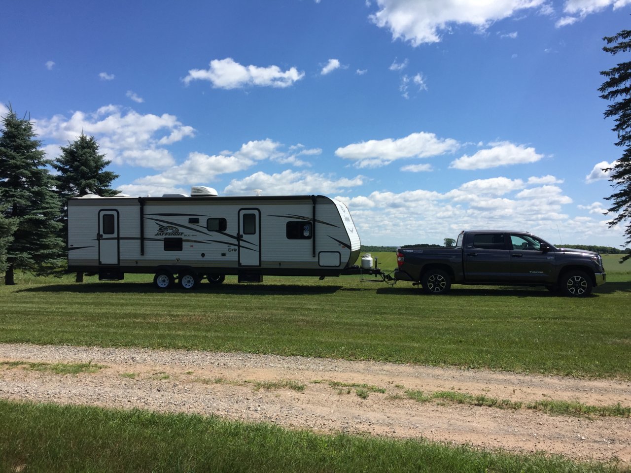

    2021 GMC 3500 SRW Gasser
    This is what we currently tow for camping. It's a 33' long 2018 Jayco SLX 287BHS.
    The truck is stock except for the aftermarket tow mirrors (power, heat, BSM), a BedRug, and 275/70/18 St Maxx's.
    The Tundra pulls the weight just fine but if there is a significant cross-wind (20-25 mph and gusty) it can get sporty.
    I weighed the above load out at our local garbage dump, which has a weigh in-weigh out setup. A tent, chairs, clothes, food/drink, and general kitchen supplies were in the trailer with all water tanks empty. There were also 2 full 20# propane tanks on the front. In the rear seat area of the truck I had tools and grilling equipment. In the bed were 6 bikes (3 adult and 3 kiddie), Weber charcoal grill, firewood for 2 days, and 10 12" long 4x6 cedar blocks that I use to put under the jack stands. I was alone in the truck with a full tank of gas.
    When I pulled the whole thing onto the scales the combined weight was 13,360.
    I then pulled forward until just the trailer wheels were on the scale and that was 6060.
    Next, I disconnected and weighed the truck separately with the 1000# Curt WD hitch and bars still attached...6540.
    13,360-6540 gives me a trailer weight of 6820.
    6820-6060=760 on the hitch.
    760/6820 = 11% tongue weight.
    My Tundra's max weight is 7200 and it weighed 6540 giving me an available payload of 660. Since there was 760 on the tongue, that put me 100#'s over payload. That could've been remedied by moving the cedar blocks into the trailer as they were pretty close to 100#'s, but I didnt bother because they had a bunch of crickets and earwigs on them from sitting in the grass.
    With tow mode on and driving in S4, it did great, handles the weight just fine, but like I said if it's windy it starts to push me around pretty good. A couple of years ago I pulled a 4k# BobCat on a 2500# trailer with no problems and it was very stable since it was just a hunk of metal back there with no sail action. I am going to order the TRD rear sway bar soon to help stiffen it up some.
    The Tundra is maxed out with our current camping load-out and no one else can ride with me but our solution is having Mamma Bear follow in the Sienna with the 4 boys.
    Even though I'm technically pulling 3k below the max tow rating, you can see that I'm pretty much maxed out. I could gain some by moving stuff from the truck to the trailer (7500# rating) but the interior is still in great condition and I dont want to ding it up with bikes and grilling gear.
    Any increase in TT size/weight is going to mean trading the Tundra in for a 2500/3500 gasser but I cant bring myself to do it...yet. The other issue is being able to put all 6 of us in one vehicle. When I first got the Tundra I didnt think it would be that big of a deal but it's starting to become a PITA. We'd like to do some real cross-country trips but aren't going to do that with 2 vehicles.

    2020 Oliver Legacy Elite ll. There is a YouTube video that will give you lots of details.

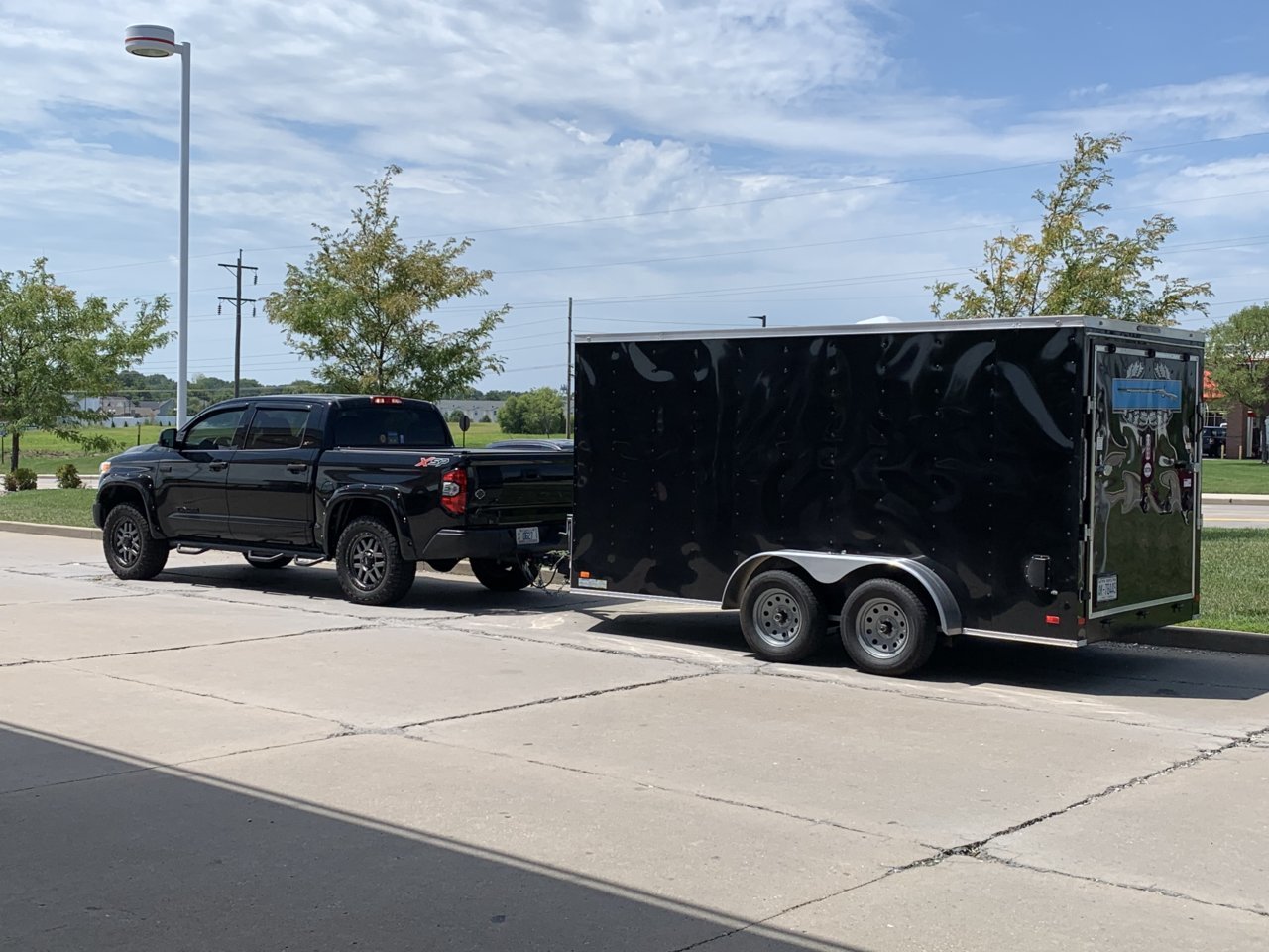

    My 7’x14” motorcycle trailer on our way to Colorado EF60AA06-2953-44CB-858C-1BA19B6D0EA5.jpg
