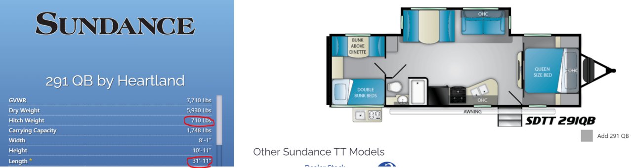

    What about the trailer listed right above your post? Dry weight is 5900lbs

    Dry weight is seldom the problem. You run out of hitch weight well before you hit the GVWR for the Tundra in 99% of the cases because of gear in the truck and adding the batteries and propane. If you add another 115 as suggested by Tracy, you are at a wopping 825 lb hitch weight with nothing but batteries and propane on this trailer.
    Also keep in mind that TT length almost never included the hitch or bumper, so you are going to be 3-5 feet longer than what it states. That is a huge wind sail and a lot of sway.
