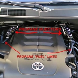

    Here are three "after" pics with a bit of info...
    pic # 1
    ... now my engine runs on either gas or propane by using the appropriate injectors

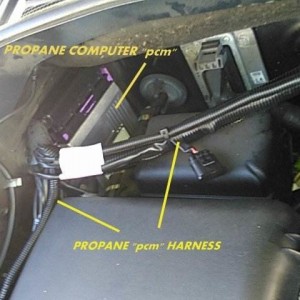

    pic #2
    .... the propane system runs on it's own computer, btw I coined it as 'pcm'.
    The interesting thing is this management system seamlessly communicates with the Toyota ecm ergo the system does not throw a code and the "accessory meter" is fully functional while using propane. Quite the bonus if you ask me.

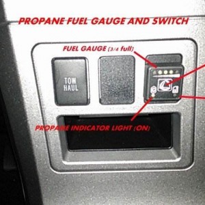

    Is there an indicator for propane level? Tied to fuel gauge?

    The stand alone propane gauge/switch is mounted on the far right blank beside the "tow/haul" switch, and as stated in my last posting it seems to be tied to the on board computer.

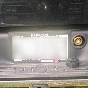

    Jack Burton... interesting choice in 'nicname' btw... the fill point is mounted on the right side of the rear license plate.

    Why are my pics cropped???
    The following pics are not adequate, this site cropped them...
    The top line on the right is the "Fuel Selector Switch" it's function is obvious.
    The bottom line on the right is the "Gasoline Indicator Light" which is on when propane either runs out or I have pressed the switch to run on gas.
    The engine always starts on gasoline then switches to propane after it settles at optimum idle, unless I have selected to run on gas.

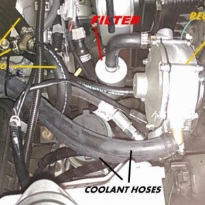

    The three yellow lines on the left are pointing out the propane lines running to the injectors... yes it is one line from the "Regulator" that splits into two, the both hold the same amount pressure and feed the 8 propane injectors without issue.
    The "Filter" is propane coming from the "Regulator" to the injectors to remove any particulates from the regulator etc, this should ideally be changed out after the first 10,000 kms or 6200 miles and every 60,000kms or 37,000 miles.

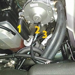

    The "Regulator" is that large silver object at the right of the picture. This is where the propane is converted from it's liquid form to a vapor and is released to the injectors. This is facilitated by use of heat coming from the two heater hoses as pointed out in the lower part of the pic.
    Edited to add this photo...
    A better view of the regulator and heater hoses as well as...
    1 - propane line out with filter to injectors
    2 - propane line in (from tank) to regulator
    3 - electrical/computer harness
    I still need to take pics of the filler position... tomorrow.

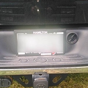

    This install is very clean... it's all in the details, like the filler.....
    I will be make one modification to the filler cap, I'm going to attach it to the truck so it doesn't go missing. I'll get pics of it too.
    ... hhmm... if you look close you can see the reflection of my old truck in the tail gate ...

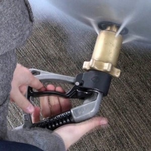

    Jack... refilling is different type of "gun" that are used screw on (see the last pic I posted) and it may mean that the attendant fills rather than you, safety reasons... propane is pressurized. But no vents or other special procedures, open the cap, screw the nozzle on and fill.
    Also... Jack... do some research in the areas that you travel and find the propane filling stations. you can either drop in or call them to find out the pricing, typically it's 50% less than gas.

    From your pic of the fill fitting it looked like a standard Acme type fitting, but I couldn't tell for certain. Ya, I buy propane for my home grill, camping grill, camp trailer, portable fire pit and external camping shower water heater now and it's way lower than gasoline for sure.

    Closer to 5800 (taxes etc).... and you need to make sure the filling stations are equipped to fill cars/trucks.
    Yes it's an acme fitting.
    ... edited to add pic...
    This is the typical filling nozzle... and what it does prior to removal... those jets are a 1 second compressed prop release.

    Okay, cool. So the nozzle does the venting rather than having to open one on the tank. Thanks for all the info and pics, very informative thread! :thumbsup:
