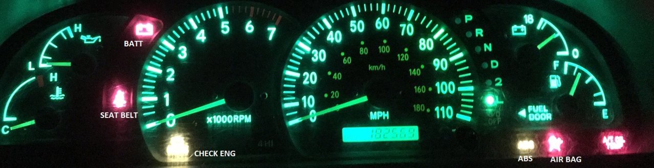

    I'll also add to what @Aerindel added....on my 2004, the second I turn the key to IGN ON, all the below lights are lit.....after 3 beeps?, the ABS goes out and after 5 beeps?, the AIR BAG goes out. The SEAT BELT simply continues flashing and BATT, A/T OIL TEMP, CHECK ENG stay on steady !
    TX-TRD1stGEN likes this.
