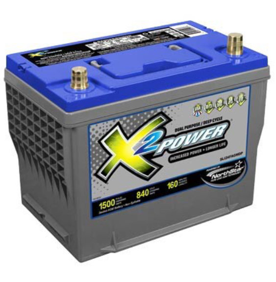

    Yeah I used to run all Optima Yellow tops but, my battery guy Charlie recommended the X2. Optima is made in Mexico and has issues now and the Tundra has battery terminals on different sides. I’ve had mine the past 35,000 miles or two years no issues. They are marine rated and offer 840 CCAs. It’s AGM and should easily allow you to run a decent wattage system. I do like XS but, they swell up under the hood and the terminals were an issue. I’ve seem people compete with Northstar.
