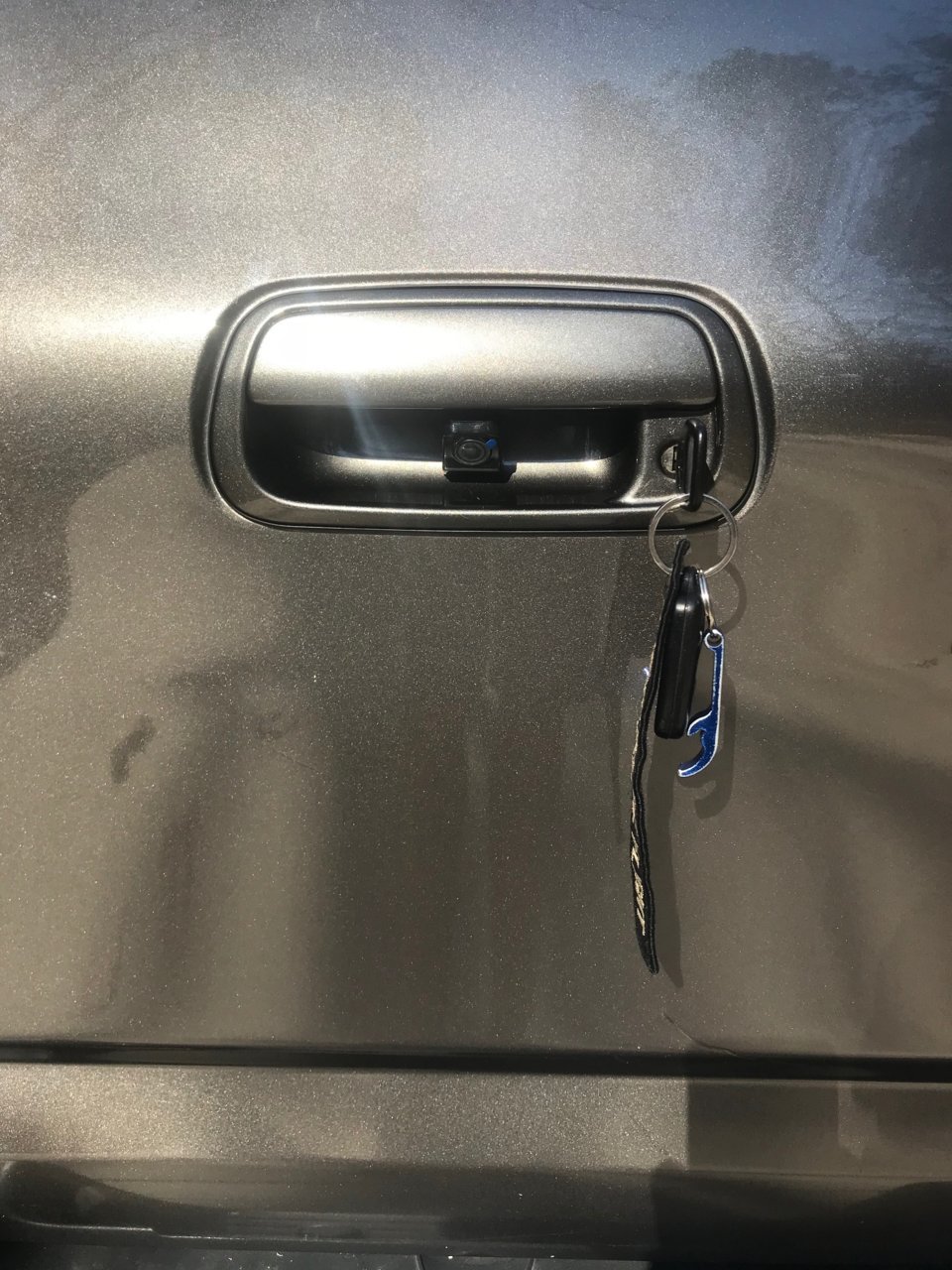

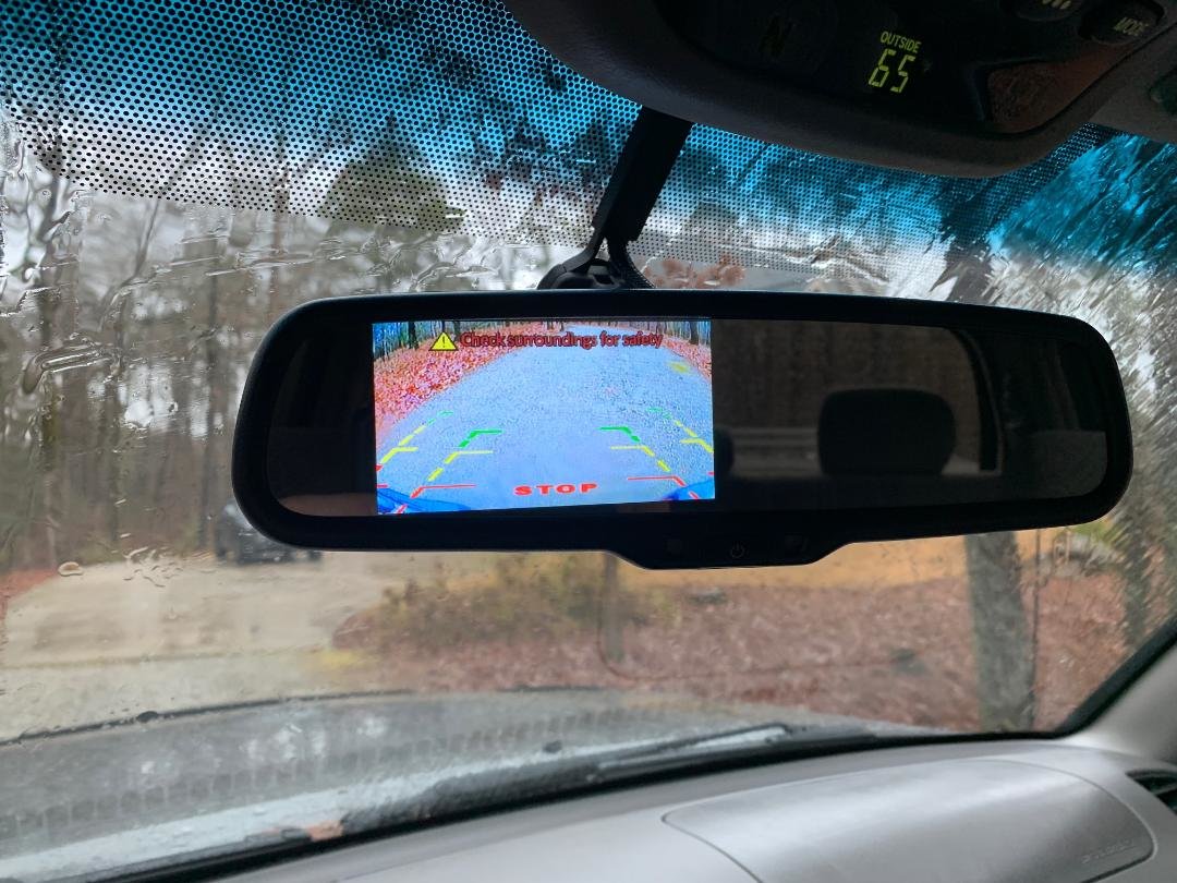

    I haven't done much to mine other than maintenance and a few small things here and there; but this is one of my favorites -

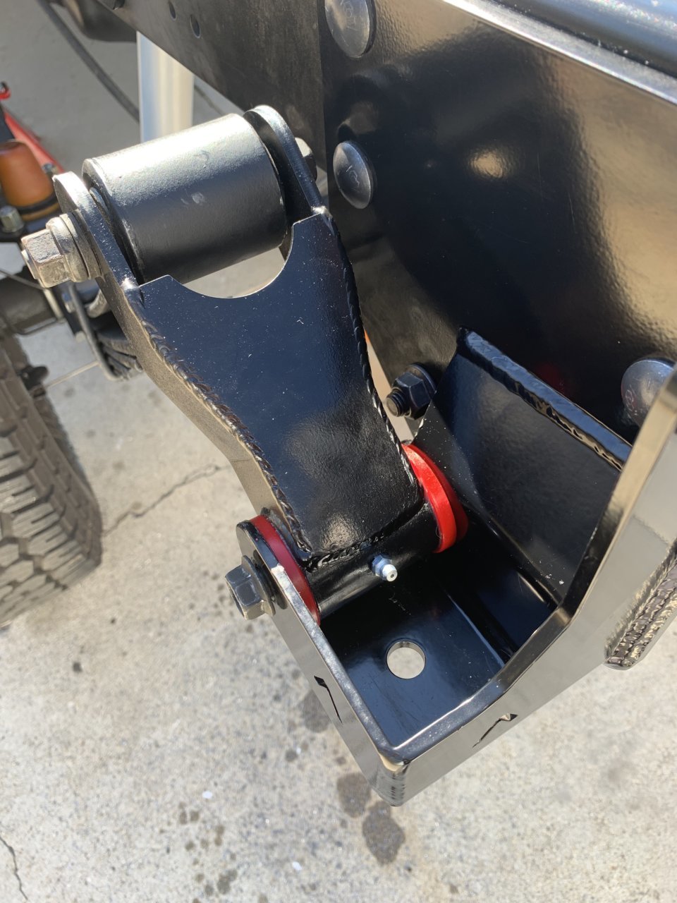

    It's confusing to me as well. Longer shackles don't raise our trucks. My shackles are longer and they actually lower it. I can't see in my head why it works like that, I just l know that's what happens. (Edit) I didn't explain the next part right, even looking at a picture. :anonymous:

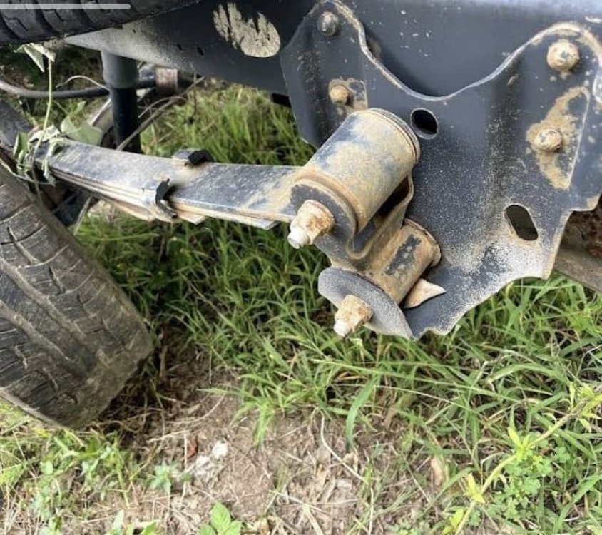

    The rear leaf spring eye is A fixed distance from the ground. The shackle on these trucks attaches to the frame at the bottom of the shackle. So essentially the truck is hanging from the shackle. A longer shackle makes the distance from the top of the leaf attachment farther away, hence hanging lower to the ground.

    Yes @KNABORES !

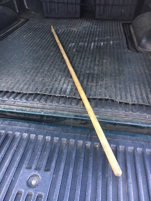

    Here's the mod that in terms of usefulness vs dollars spent, I challenge anyone to beat! A broom or brush handle with a lag hook screwed into the end allows you to effortlessly pull/push items out of/into the depths of the bed.upload_2022-1-6_11-51-47.jpg upload_2022-1-6_11-52-1.jpg

    Hah! Very smart. I use my shovel to accomplish this sometimes but a hook would be much better.

    I can't take credit for it. A friend of mine was using his one day in his truck and I thought, "Brilliant!"
    My bed is covered with a cap (which I never lock) but even if it wasn't, you don't need to be concerned about leaving it back there. Who's going to steal a broom stick? :rofl:

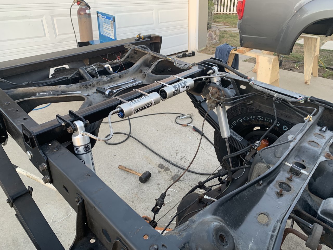

    I really like all of my springs, King and Archive/Shackelton
    (King 2.5 OEM-extended Coilovers, And rear medium duty leaf spring from Archive Garage)

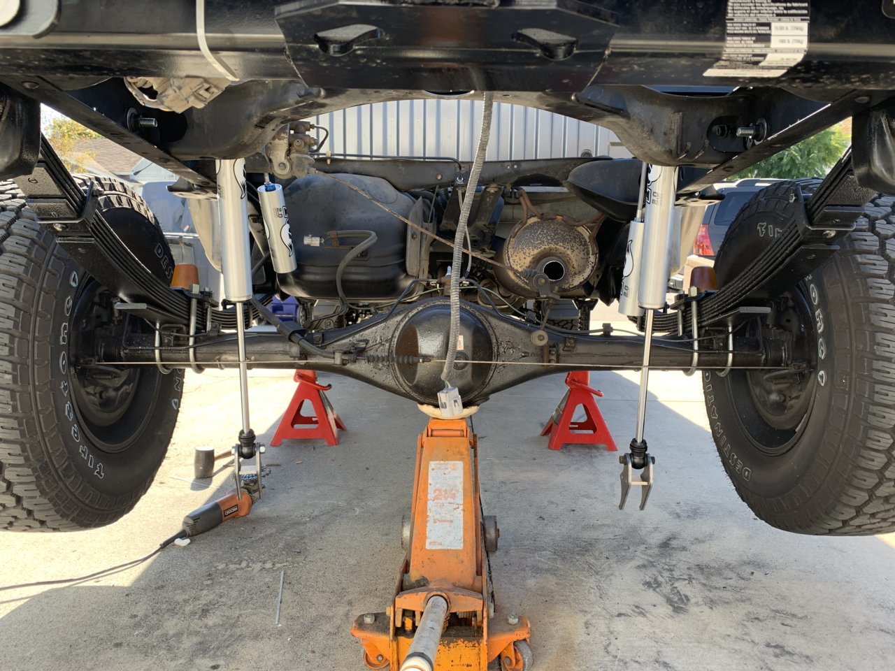

    Everything from Archive Garage is very good.
    (I have the u-bolt flip kit, the hammer hangers, and the shock relocation kit)

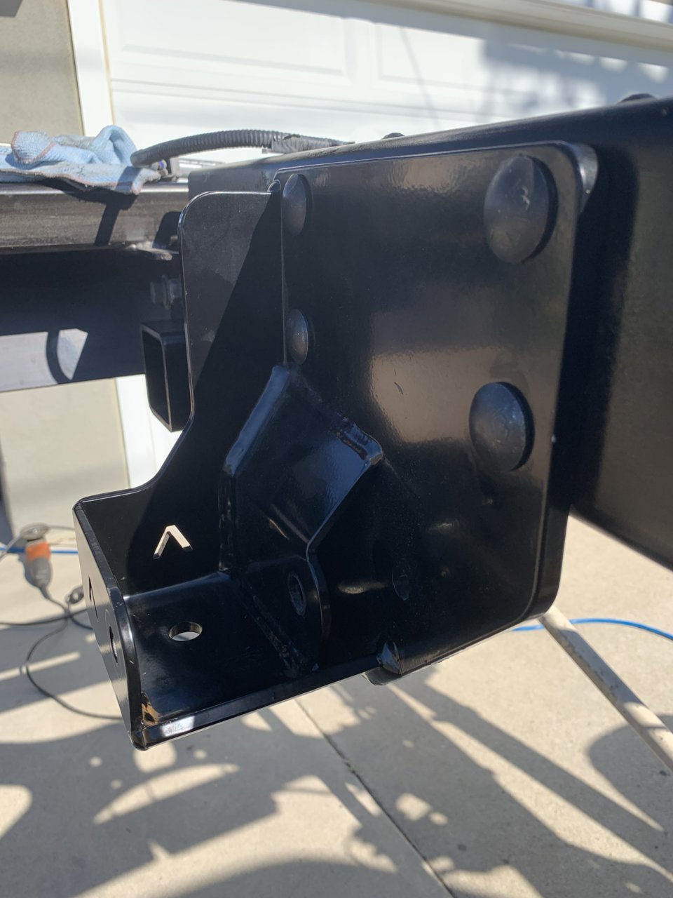

    @alb1k could you expand on the shock relocation, u-bolt flip and hangers? Now that I have an idea of how the shackle length changes ground clearance thanks to @KNABORES help. Trying to learn step by step, starting from zero hurts :)

    I read some of it and didn't fully absorb the differences / reasons why (for example) flipping a U bolt adds value

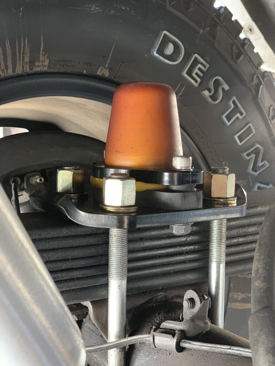

    The U-bolt flip kit doesn't add a lot besides clearance. The stock U-bolts have the plates on the bottom of the axle, with bolt heads and such more exposed to things on the ground. Obviously more useful off road than on. The other benefit is what's mentioned above and shown in alb1k's forth picture. The bump stop can be removed without removing the U-bolts. I also have this kit (as well as the Hammer Hangers) and it's very well made. As mentioned, all of Archive's stuff is stout. I want to get that shock relocation kit too!

    Yeah, the ubolt flip is the least value. Now that my shock mounts are lower, even more so. I probably wouldn't do it now, but it's nice at least.

    What I'm not clear on with U bolts is whether or not I want them, since I'm swapping to a deaver custom leaf pack which came with U bolts. Also not clear on shock relocation and whether or not it'd be compatible with the fox shocks I don't even have yet :) That's where it stays confusing to me.

    If you flip the bolts you need a radius end to go around the axle. If you keep the bolt ends pointed down, squared bolts to go around the leafs.
    Mine are Fox 2.0 12" I and very borderline bottom out even with lower shock mounts quite low and 1/2" bump stop spacers. It's one of the things I have to chase down to see if I'm "go-no-go" 10-11" is probably clear all day (I think an 11" is out there. I also believe the AC has a bit more room than the DC. Not sure where 2wd/4wd come into play. Less droop is the take back with a shorter shock.
