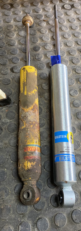

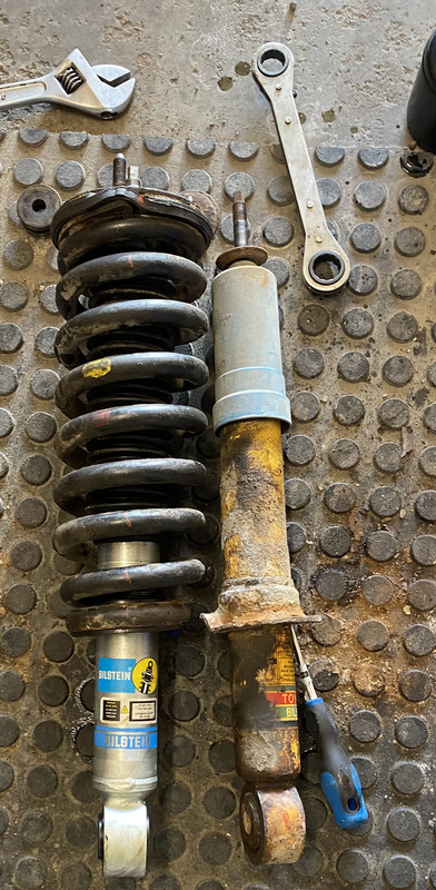

    Did you end up replacing your suspension? I went with 5100’s all the way around. Install was not bad, a few seized nuts that I had to cut off. Truck rides much better now and is level with the second notch on the front struts.
