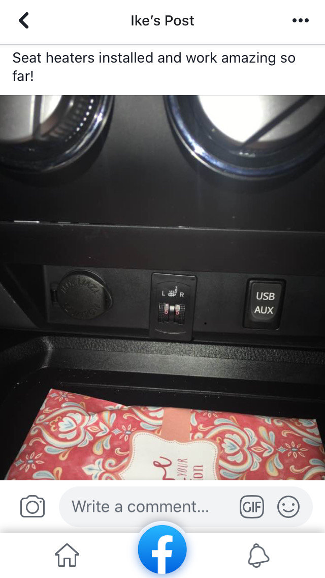

    9E84AB82-50DD-47FE-A3AD-4CE62B6DD3BE.jpg I installed a 5 position switch that had two dials, driver and passenger. The switch replaced the square dummy plug under the radio to the left of the USB port. It cost me $75. That being said I installed clazzio seat covers and didn’t have to remove factory upholstery, that is the true battle.
