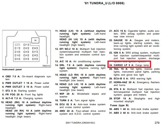

    I see it as #24 for the 2001 Pass Side fuse box.

    2001 Owners Manual says 24 but known to be wrong.

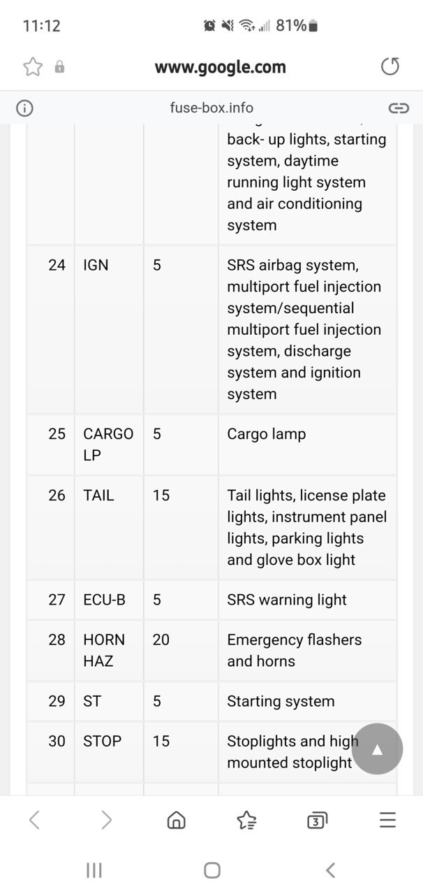

    This is what I saw when I looked it up on the link posted. Looks like #25
    Was in the number 24 spot on mine. Pulled it and light is off now. Thanks!
