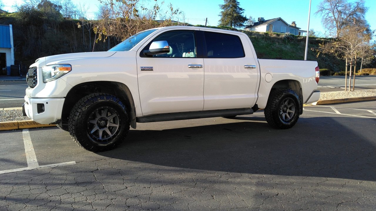

    KIMG0107.jpgthis is it at this point, I've been way to busy at work. In fact I've only put 4K miles on the truck in 9 months of ownership

    And this is strictly JUST the 5100’s all around and the front on middle setting?

    Yes, I was on the fence about going to the top setting I am glad I didn't. 275*70*18 with 25mm offset no rubbing
