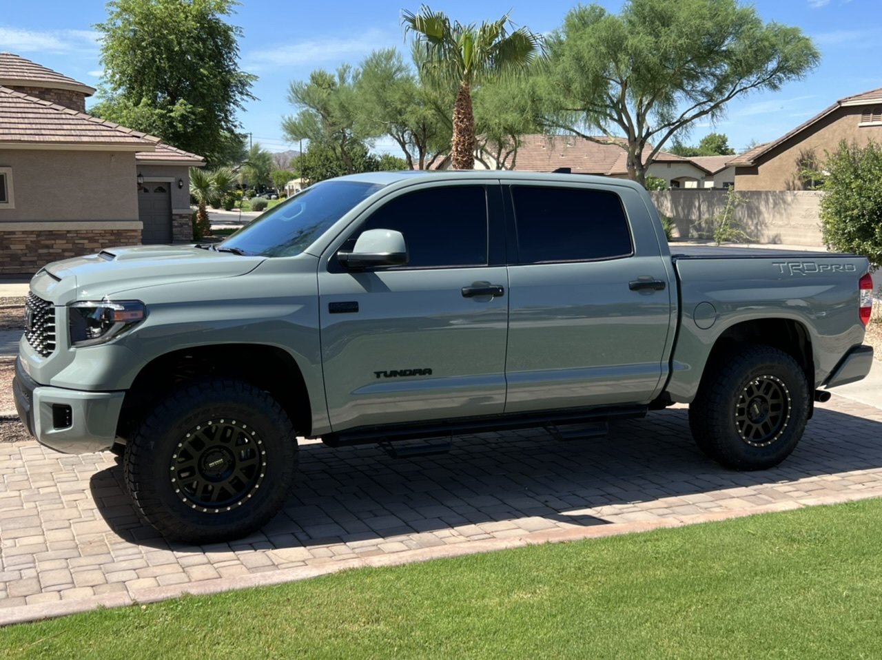

    I see you’re on TRD pro coilovers. What’s your total lifted height after collars? And tire size?
    AZTundra[QUOTED] likes this.
  4. Mar 23, 2022 at 1:15 PM
    #34
    AZTundra
    Feb 13, 2018
    #12894
    4,454
    Paul
    Phoenix, AZ
    I can measure the hub to fender if that would be helpful. I should be in the ballpark of +3.5" in the front (2" from the coilovers, 1" from coachbuilder shims, and 0.5" form the collar). I'm running the Cooper Discoverer AT3 XLT's in 295/70/18. Also using some Camburg UCA's.

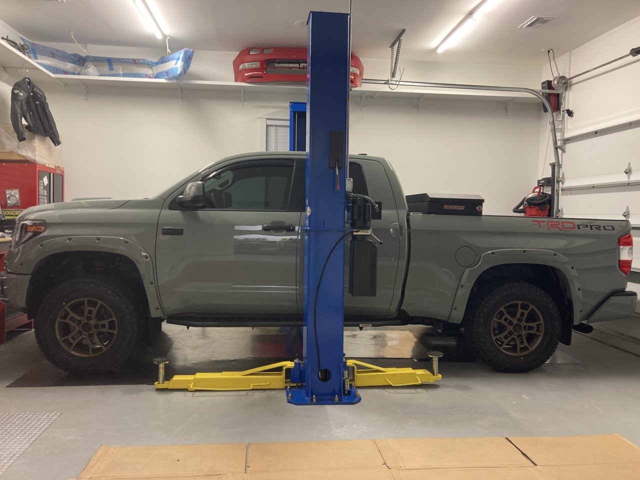

    would you be able to measure ground to top of cab?? I need to see if this would still fit in my garage after adding the kit
  8. Aug 22, 2022 at 2:47 PM
    #38
    VTYOTER
    VTYOTER Rock
    Jun 7, 2021
    #63993
    456
    Torrey
    Vermont
    2021 TRD Pro LR
    35" KO2, METHOD 701, WESTCOTT COLLAR, CB+3, BUMPER SHIMS, CALIRAISED ROCK SLIDERS STEP EDITION, DIAMONDBACK HD
    I can measure later but if you have a 7’ garage door you’ll be fine. I added a prinsu on top of this and still have 1-2” clearance in the garage

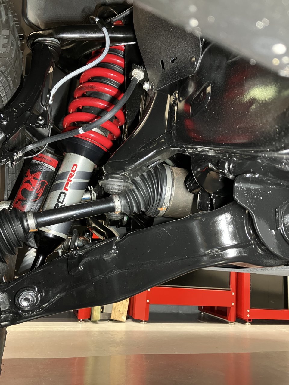

    Are you guys installing a front differential drop kit from CoachBuilder after the front westcott lift? It’s only 1.5-2” lift but is it needed to correct any bad angles ?
  12. Sep 12, 2022 at 8:55 AM
    #42
    AZTundra
    Feb 13, 2018
    #12894
    4,454
    Paul
    Phoenix, AZ
    I didn't add the front dif drop and haven't had any issues w/o it. Westcott kit was installed 2 1/2 years ago and maybe 27K miles on it so far.

    Another question, does the PRO come lifted or leveled 1-1.5” from the factory over standard SR5, Off-road tundras? If so, adding the westcott front lift is like adding 3-3.5” lift over a standard tundra?
    I end up getting 2” from the front westcott lift. Take a look at those angles, can u guys say that it’s normal? Thanks
  14. Oct 14, 2022 at 3:41 PM
    #44
    TRDFerguson
    Oct 18, 2018
    #20730
    10,817
    Jake
    Southeast Greater Basin, AZ
    2018 MGM CrüeMax
    That looks way nose high, or did you not do anything to the rear yet? Back to your question, yes, the Pro shocks give a 2" lift over stock height, but the westcott kit is supposed to be more like an additional 1.5", not a full 2". It's possible it'll settle after driving and getting an alignment done, but keep an eye on those CV angles.

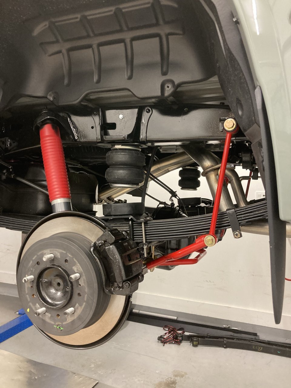

    I put a few miles on it and drove it back home, I have the full icon RXT leaf pack optioned 3 installed just last weekend, that leaf pack put me up “unloaded” 5 inches higher in the rear! I’m planning to carry a lot of weight in the back for work “Double Pro Work Truck” build coming soon.
    measurements are from the ground to the edge of the fender flares
    before westcott lift and icon leaf pack
    driver front 39-1/8” Passenger front 39-1/4”
    driver rear 39-1/2”. Passenger rear 39-1/2”
    after lift
    driver 41-1/8”. Passenger 41-1/4”
    Rear 44-3/8”. Passenger 44-1/2”
    tires size 275/70/18 Falken wild peaks AT3W
