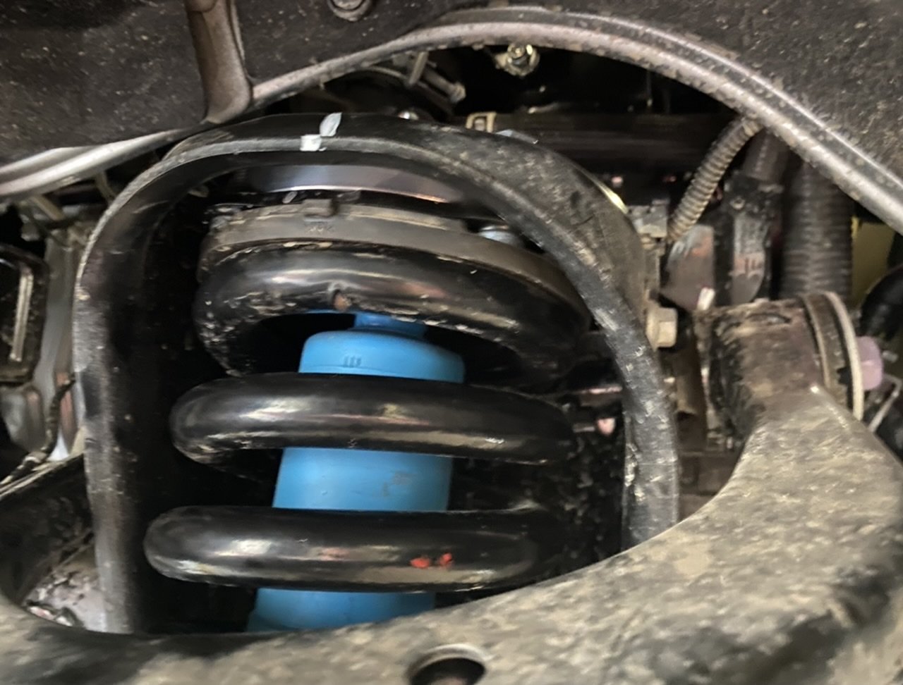

    I installed the RC spacer kit couple weeks ago. The stock tophat studs are really long and have a bullet nose at the end. After I trimmed the studs, there's still plenty of room to go back to stock. Rotating the shock with the top hat on and getting the lower shock mount to line up correctly sounded like more of a pain to me than cutting the studs, and I also didn't want a full 2" in front. $160 is pretty expensive but I think it's a cool kit. And it rides like stock.IMG_3374.jpg

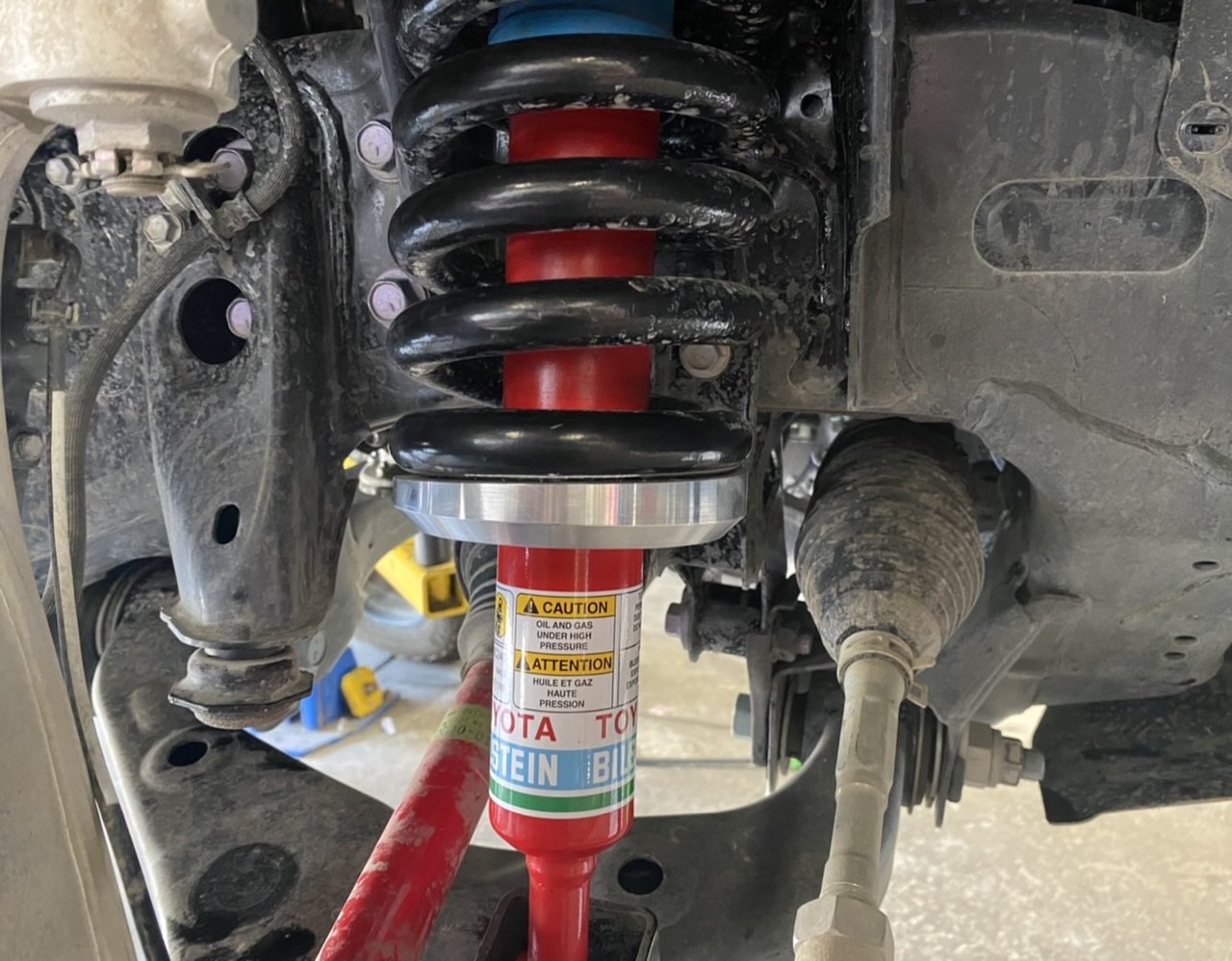

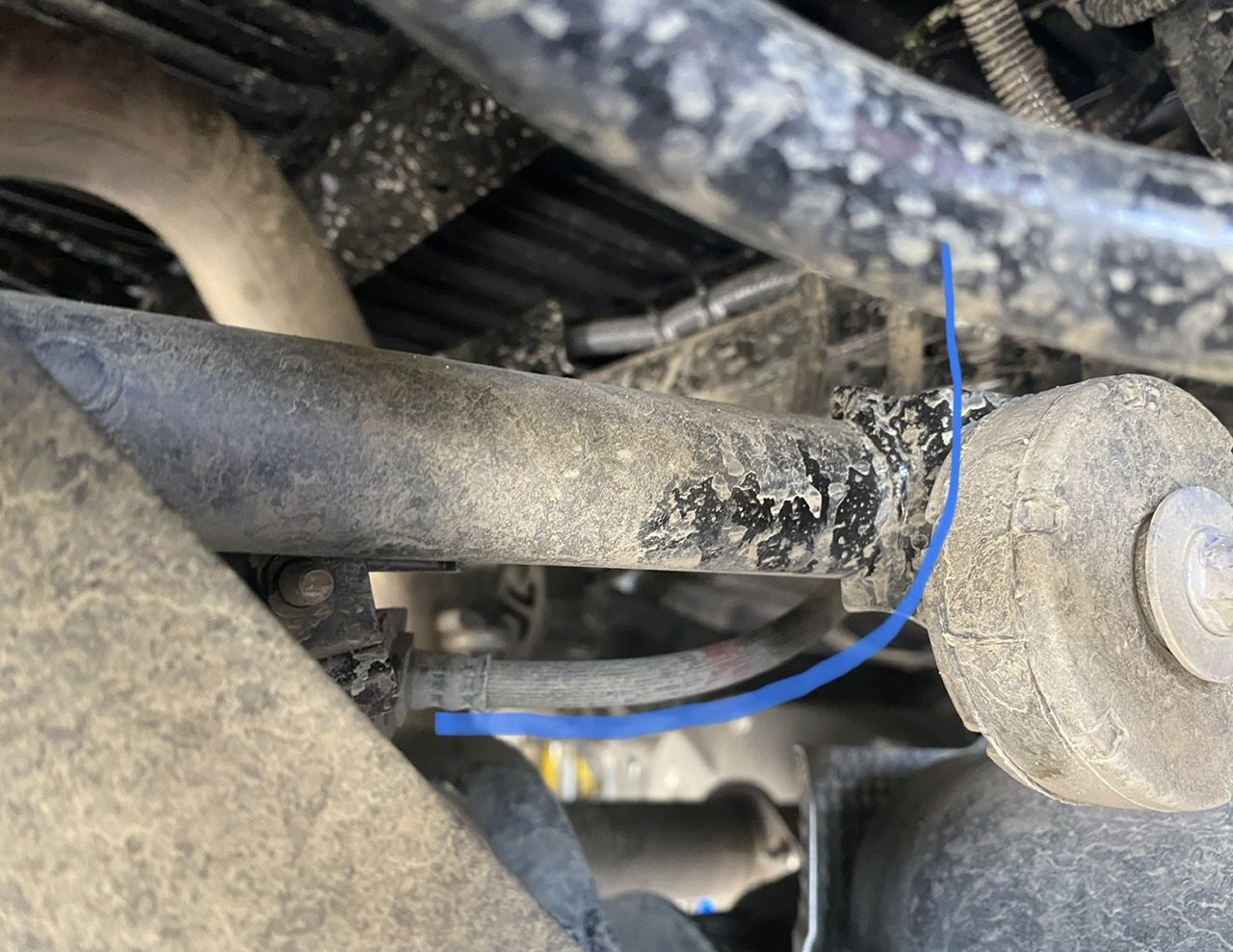

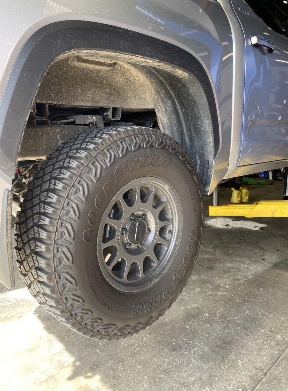

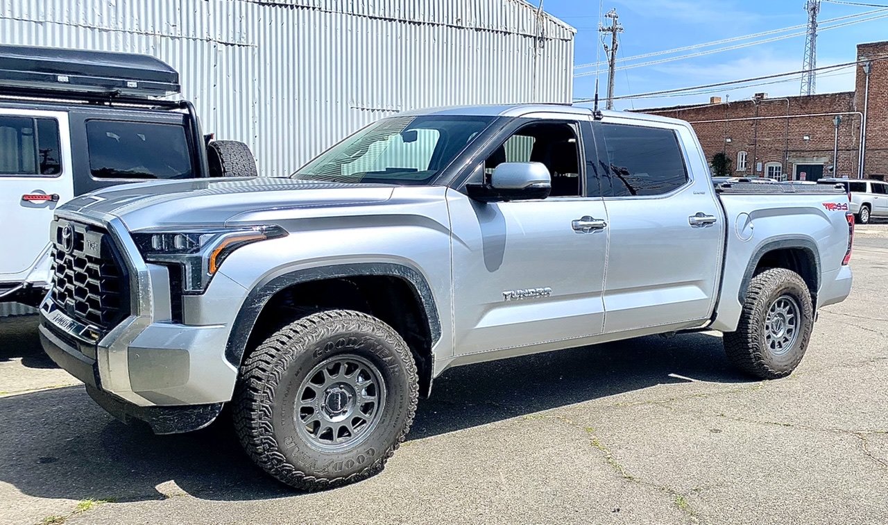

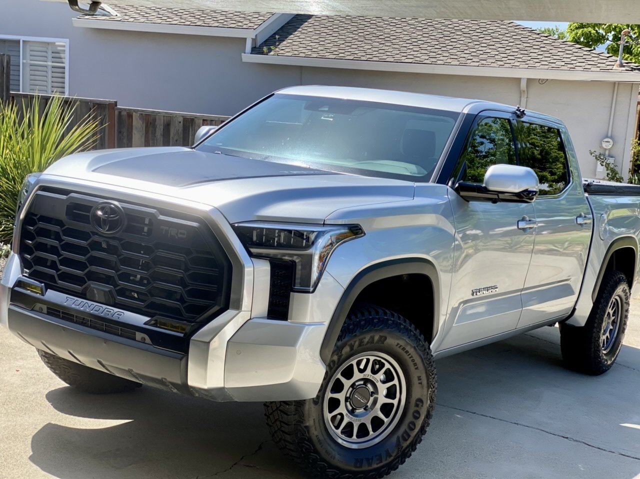

    I installed my Westcott 3/2 lift a little while back and it’s stiffer than stock but fine. Nothing beats a real lift with great shocks, it’s hard to know till you know! The good news is that even with 2” in the rear you don’t need extended brake lines, which is also not great news because as configured these trucks just don’t have much droop. But it sounds like Total Chaos is working on fixing that with their kit and it’s extended travel. 9ED8C5E9-EEC3-45CD-8026-A68DEE23AAF3.jpg 413330AD-8B47-48C4-8BC7-C8706C783034.jpg EC35D3DC-846B-4C4F-8AA3-56625AD9BACA.jpg 9A825237-E406-4376-B59A-0E7C9E5BF058.jpg8429C74E-A696-46C9-972C-50C55A97304A.jpg B0C2AD98-053A-46C9-B95A-046A1BEFFB6C.jpg AA2384E1-55E2-4EE4-B76E-2B6BEA6CB5D5.jpg

    Looks great!
    Side note: You're now the second or third person I've seen post about a Westcott 3"/2" lift. I'm not sure if it's a misprint or if some of you have custom ordered, but Westcott only lists 3"/1" (unless AVS then it's 2"/1"ish) on their website. Did you get a custom ordered 2" lift for the rear, as their standard Limited non-AVS lift gives 1" in the rear only?

    They made a few rear 2” spacers to test so I asked for one pair for my Tundra. Took a little bit but they helped me out. But I have no idea if they are still doing that

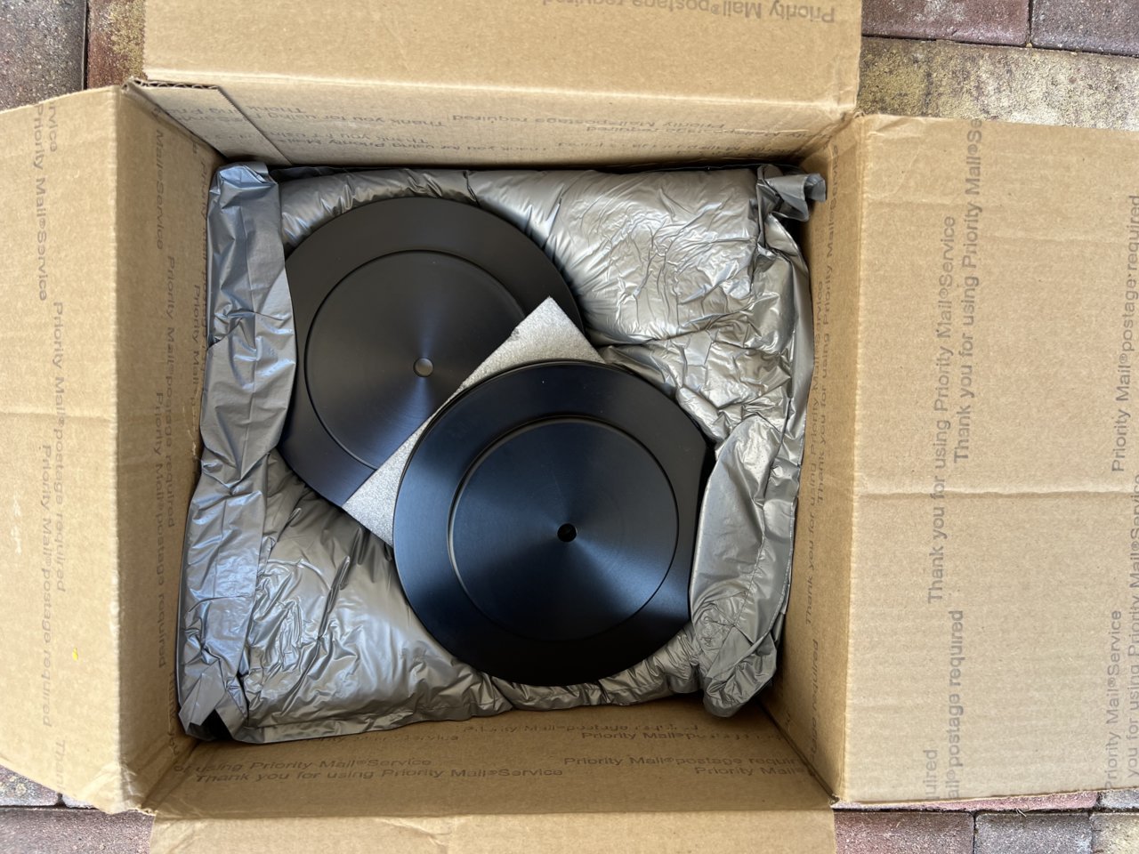

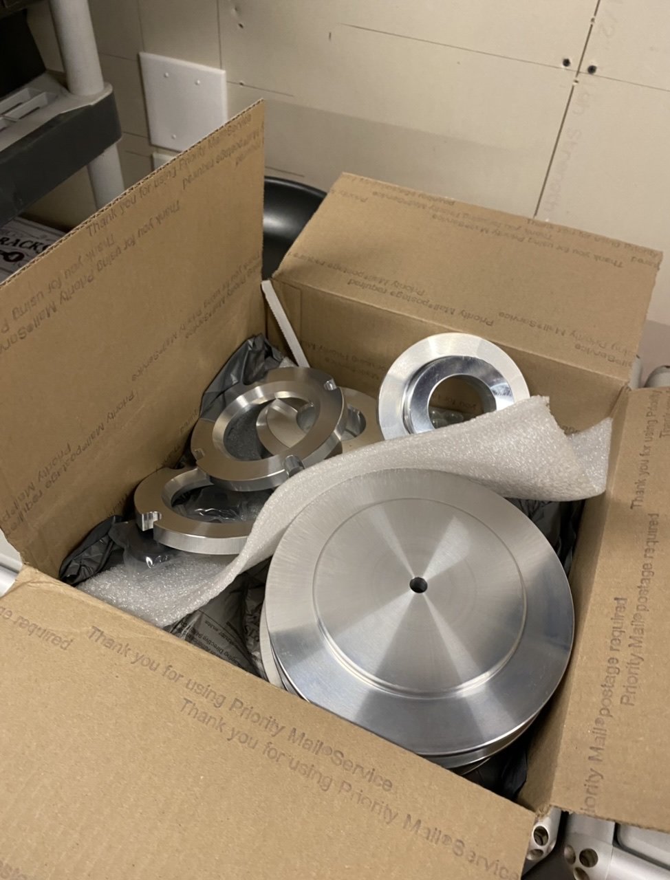

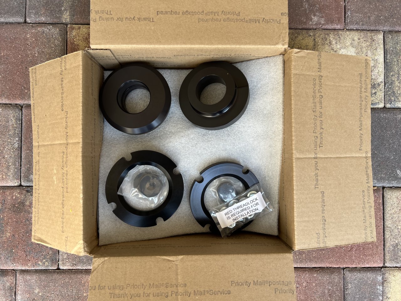

    Don't have enough posts to place in the marketplace here are some pictures of my kit just got it. Changed my mind selling. PM 10% off + shipping

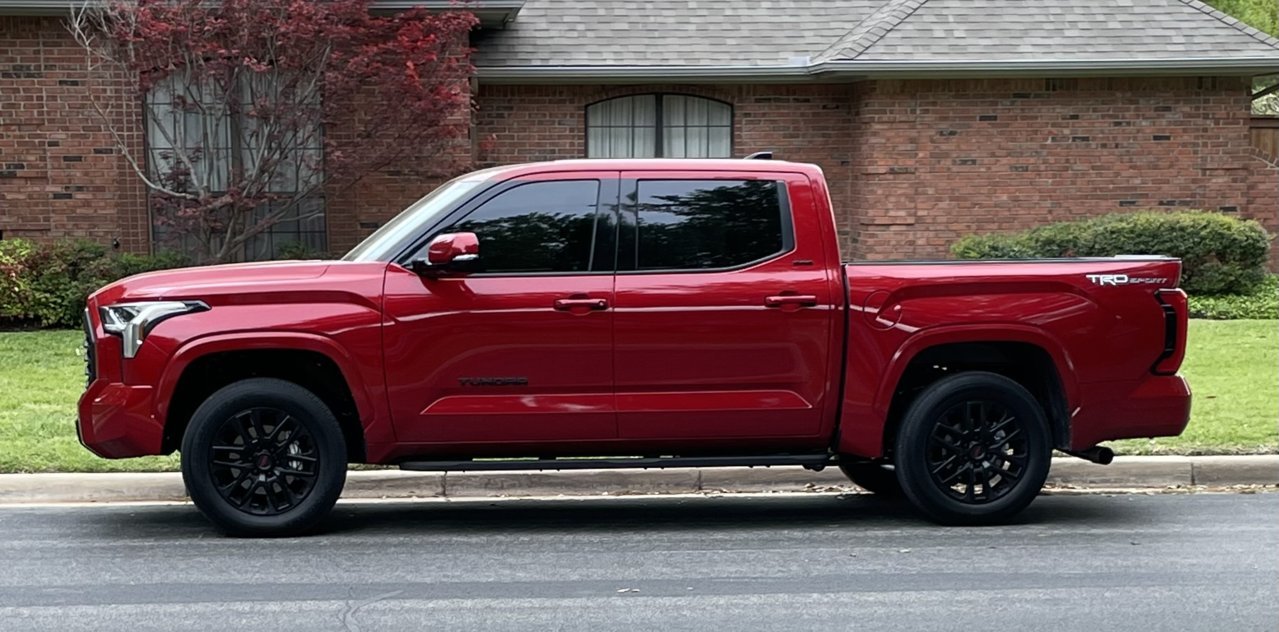

    I think the same thing any time I see a lifted or leveled Tundra, that's why I'd like to get a 1" spacer lift. My measurements show the front is in fact 1 3/4" higher than the rear but something about how it looks makes it look like the front end is now higher than the rear.
