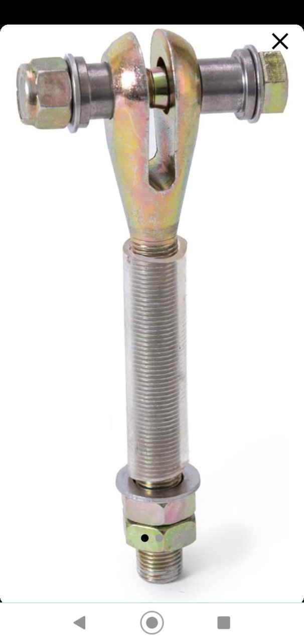

    ThisScreenshot_20210716-155118.jpg is the strap clevis, mounts need to be fabbed still, straps will be ordered after I know the length or distance between the mounts at full droop minus about 1.5" to allow for the stretch and to prevent full extension. This is all going to take time as it is not my biggest priority. Family and chores before play basically.
    You can search Amazon for this or other sites. They also have weld on mounts, I will be fabricating my own mounts though.
