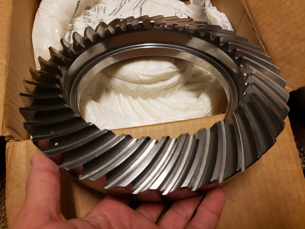

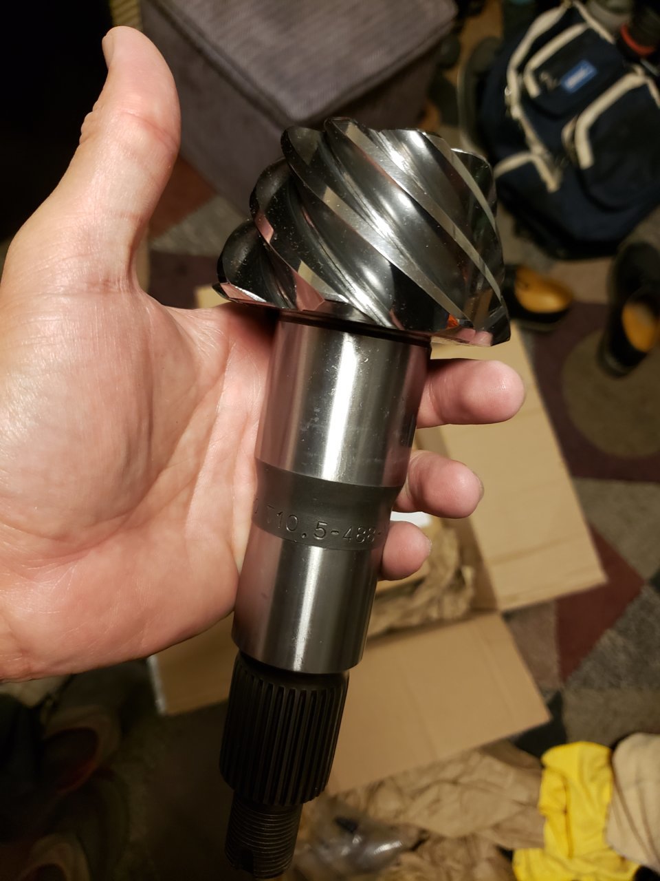

    osidepunker
    osidepunker OsidePunker
    Oct 19, 2016
    #4918
    3,000
    Alex
    SoCal
    2013 Tundra DC 4x4
    Full LT, full armor, fully self contained Speed Glamper
    eccracer104 and Challenger1 like this.

    So not to sound like a total NOOB but when asking the shop...
    Should i just ask for the additional REM job...
    Sounded funny out loud..lmao

    always ask for rem job. always

    Usually you order them that way. The shop more than likely can't do it. I couldn't even find a place near me that could do a REM polish. I know SDHQ sells the gears already polished.

    The gears are Nitro gears. I'll see if they can get it REM'ed first..
    If not i guess i just need to "break" them in.
