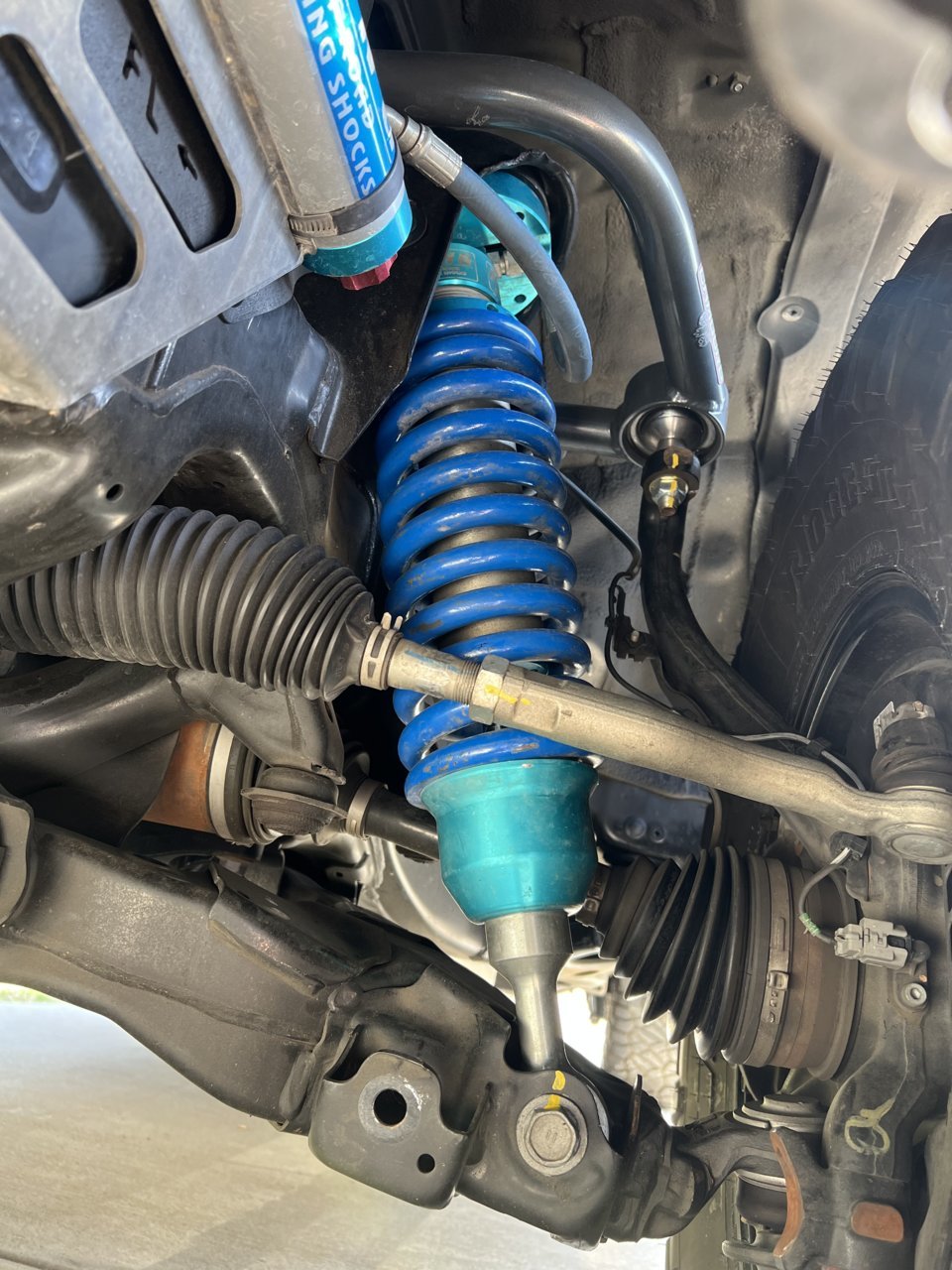

    Ok so after I got my kings installed I had my bmc done. I asked my fab guy if he could adjust my coilovers to get more lift on the front but he said I should get a bigger spring. I’m not exactly sure what spring came on it. It’s the 2.5 kings with adjusters. Currently the rear is higher than the front. On the rear I also have kings with stock leafs. Recommendation for a good setup for the rear? I was thinking icon rtx. I don’t tow much but I want the ability to tow if need be.

    Can you send a picture of how your coilovers are set up currently?
    It’s unlikely you need a longer spring - unless somehow the wrong length is installed.

    The length and spring rate and diameter are usually visibly printed on spring.....but you knew that.

    I’m going to try and get a better picture. But on the spring it read KING 3.16.600B J47

    From the ground

    So, 3" dia. 600lb rate 16" length
    Lots of folks, especially LT trucks, run 700lb.
    Regardless, I think 600 is a little soft. Looks to me like you still have room for more preload w/o sacrificing too much comfort

    Gotcha. Make sense. If I plan on getting sliders m, a roof rack, and maybe a bumper down the line should I just go with a 16” 700? Is the preload adjustment pretty easy?

    Id start with adjusting the collar to add a little more preload, if that doesn’t do it for you then go up to 700# spring rate. The new coils would be 3x16x700.

    Though not entirely necessary, this tool is highly recommended for for adjusting preload:
    https://www.polyperformance.com/kin...t4KSLpnoEyyst7Tr6aC7ju-L8JC5xN38aAkYPEALw_wcB
    Jack the wheel off the ground, loosen the bolt on the collar and turn the collar.....clockwise I think? Be sure to count the revolutions. Often people add a little more to the passenger side to compensate for the Tundra lean.
