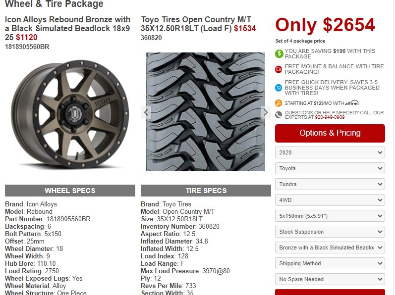

    88Rotors suggested doing 18x9 +18. I wanted to go with 17's originally. What are the pros and cons of 17's and 18's? TIA

    If you off-road, 17’s are ideal = more runner tire : wheel ratio ——> when you air down you’ll still have a good pad of rubber.
    Plus... off-road junkies start thinking 17’s look sexier. :cool:

    Sexy is not a bad thing. Will 17x9 +25 work?

    The two pros for 17s IMO is more rubber and more tire options. I want the toyo at3 285/75r17 in C load range.
    and I think it looks better.

    This was the setup I was going to order, but now I am going back 17's thanks to you guys here.

    I have 17x8.5” with 0mm offset. After some cutting, welding, and bumper moving I don’t rub at all with 35” on 1.75”-2.00” lift in the front.
    +25mm offset is considered the “sweet spot” because it’s easier to clear larger tires with less rubbing. This offset keeps the wheel and tire under the fender instead of sticking out from the fender like 0mm offset.
    The lower the offset the further the wheel sits out from the wheel well. On the flip side the higher positive offset pulls the wheel in towards the frame. Stock offset is +60mm I believe. Every 25mm equates to about 1”
    (That’s the simple version, I can go into more depth if desired)
    17” wheels work, but the weights need to be right up against the back of the spokes to clear the calipers.

    This actually changes my plan for me. I thought that the higher the offset the more the wheel/tire will stick out.
    My original plan was 17x8.5 +25 with 35 Toyos. I am on TRD Pro suspension and I was planning on doing BMC and shackle lift in the rear. Your thoughts?
