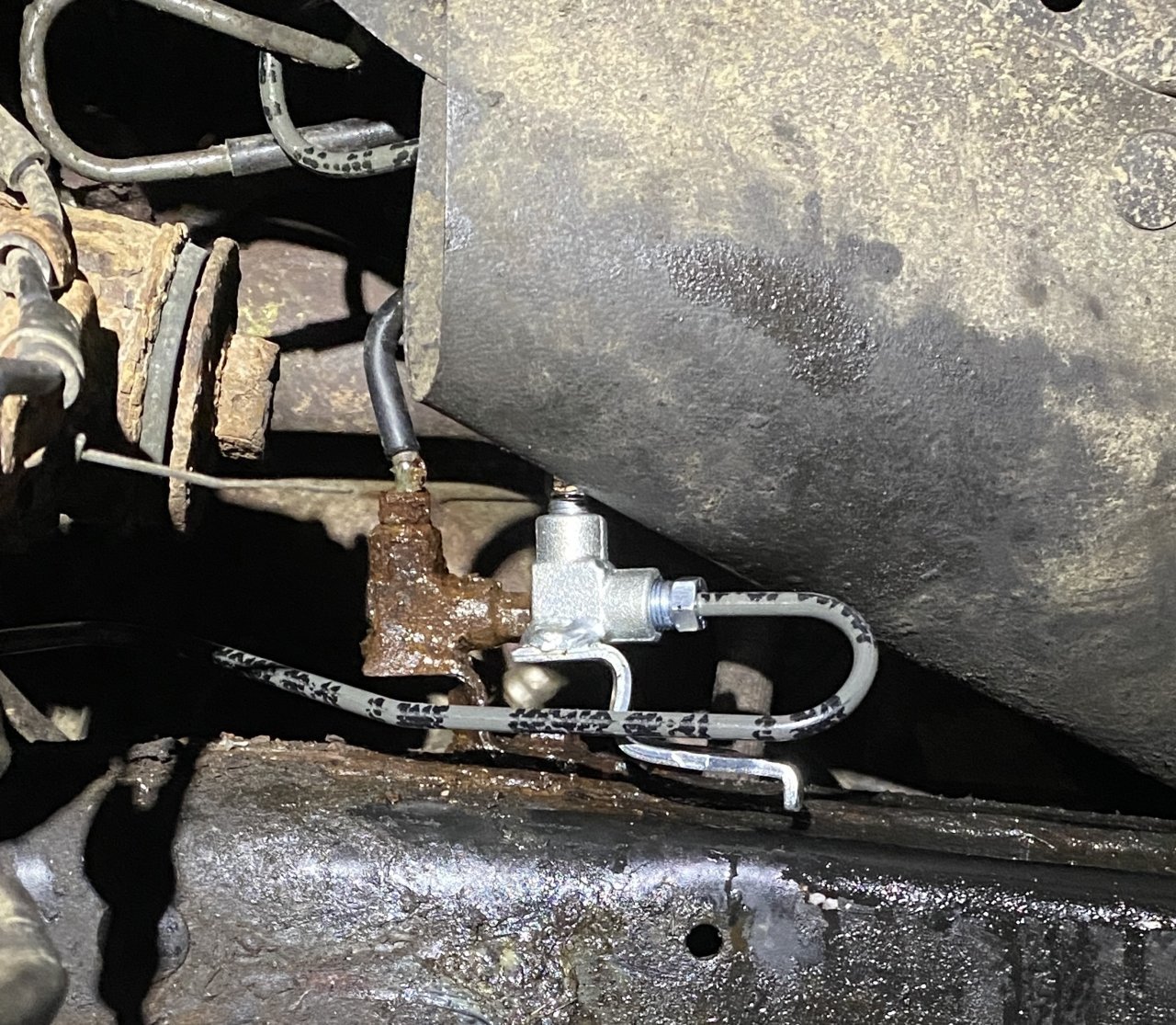

    So... what else can I check on while I'm in here and waiting for the shop to get bearing pressed in? Upper ball joint is getting replaced at the shop while the spindle is out. Lower Ball Joint is in the mail, so those are taken care of.
    I think that my CV axle was clicking when making tight turns, but maybe it was the wheel bearing the whole time. Can I do something to check that while it is free that I wouldn't be able to do when it is all buttoned up?

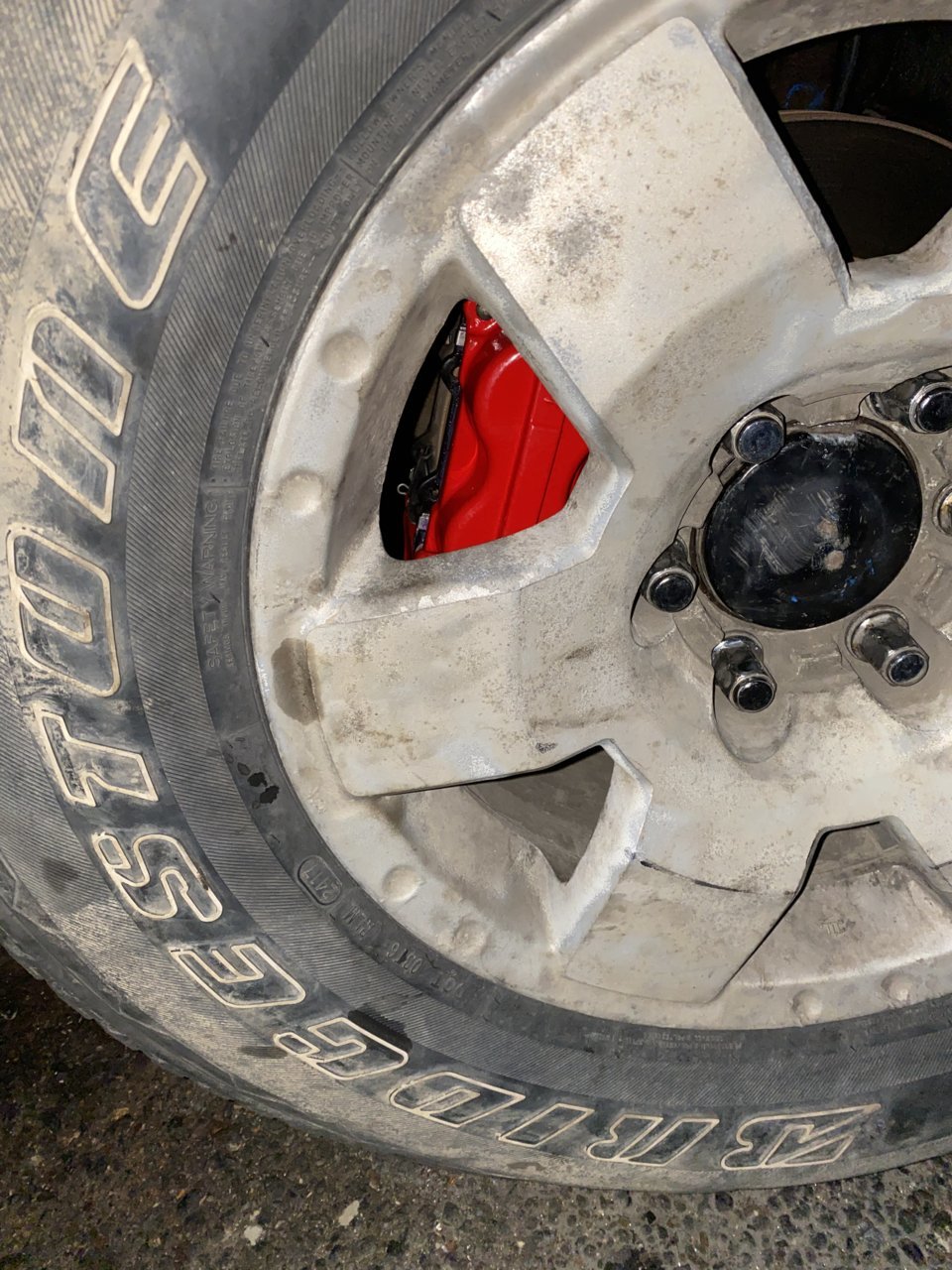

    Well, that escalated quickly
    Because I suspect that the failed bearing may have something to do with a sticky caliper and/or collapsed flex hose, and I ain’t dealing with rusty brake line fittings.

    Damn, I bet that cost about what @Tundra2 paid for his entire truck :bananadance:

    Shiiiiit @HAL69000 what are you into just for that one picture?????

    I'm gonna guess ballpark $1,600-1,700 if that's all Stoptech, on the very conservative side. Most of the kits I looked at were north of $2k.

    No way! They calipers are just Power Stop 13WL. Bunch of brake lines from Toyota and stainless flex hoses. No more than $500.
    If I had $1500 for brakes I'd have just bought a better truck to begin with!
