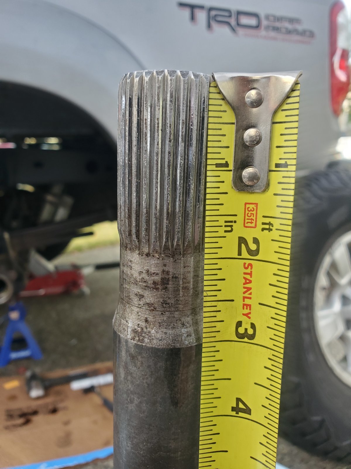

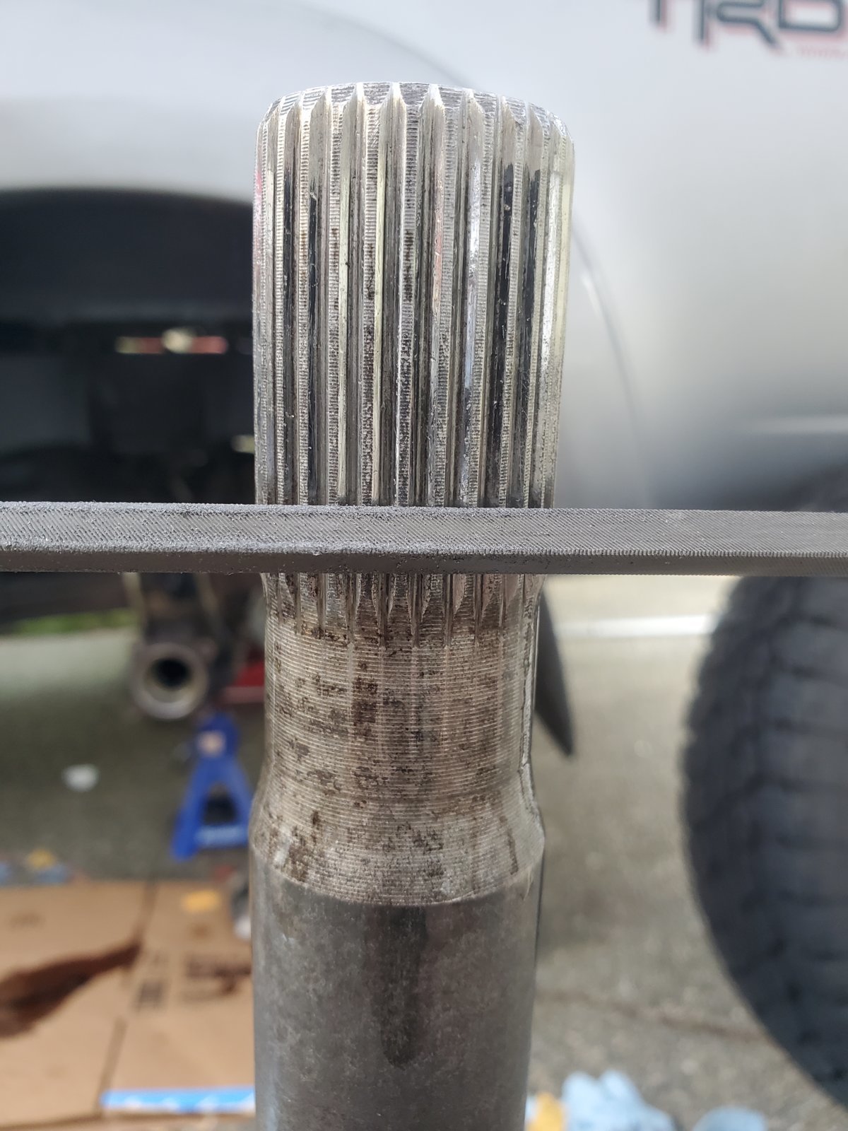

    Does anyone know how far the splines are supposed to engage? I've read a general rule of thumb is axle diameter=depth of engagement. I filed them for about an hour and the shaft slides in easy now with gear lube on the tip but still won't go the rest of the way, about 1/2in proud. I hit it a bit with a deadblow and I'm reluctant to hit it more as I've broken some things by doing that in the past.

    If you have over an inch of engagement and the bearing/axle end is flush with the housing, you're good to go.
    They typically only engage 70-80%.
