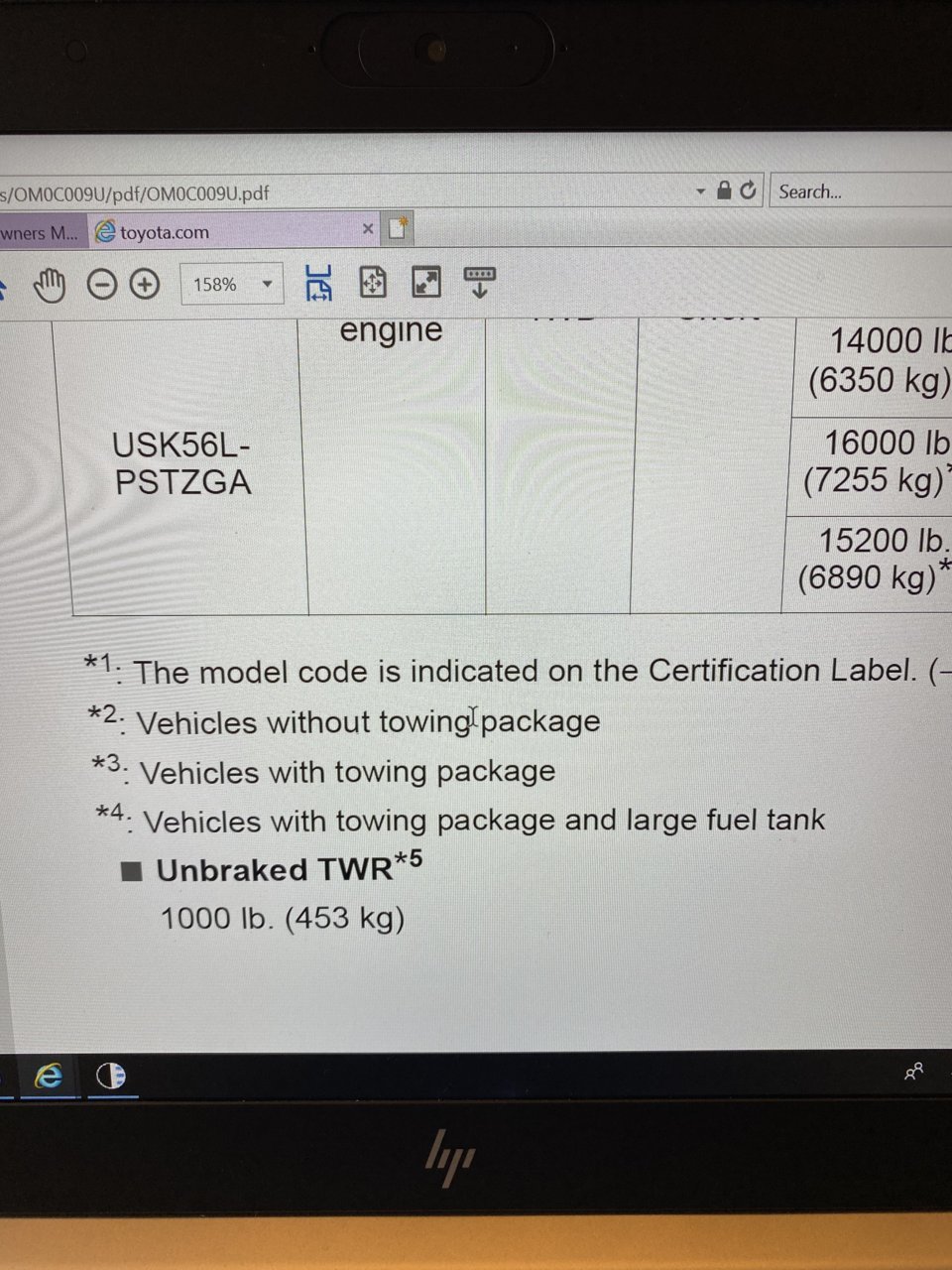

    I knew I read it someplace. On a 2018 Tundra, the max tongue weight is 1000 lbs. So actually pretty good and a step up from my old Tundra. F1A6482E-3218-410C-9F60-D8FA866AC369.jpg

    That is UNbraked trailer weight. His trailer has brakes. That is saying youshould not tow a trailer heaveier than a thousand pounds without brakes.
    Thats also for the model with a large gas tank.

    Here are the manual pages.

    page 183 shows that tongue weight needs to be 9-11 percent of trailer weight not to exceed value of stated TWR per specific model. THere's no one size fits all tongue weight. Its dictated by the packaage on vehicle, factory modifications, weight, and hitch type.
