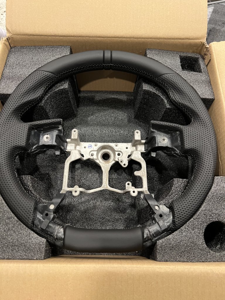

    Came in tonight.

    Don't force the old one off. Use a puller if it doesn't come off easily

    Simple install. Few bumps from the back with my hands and a good swift jerk and the old one came off. See if it’s straight when I head out tonight.

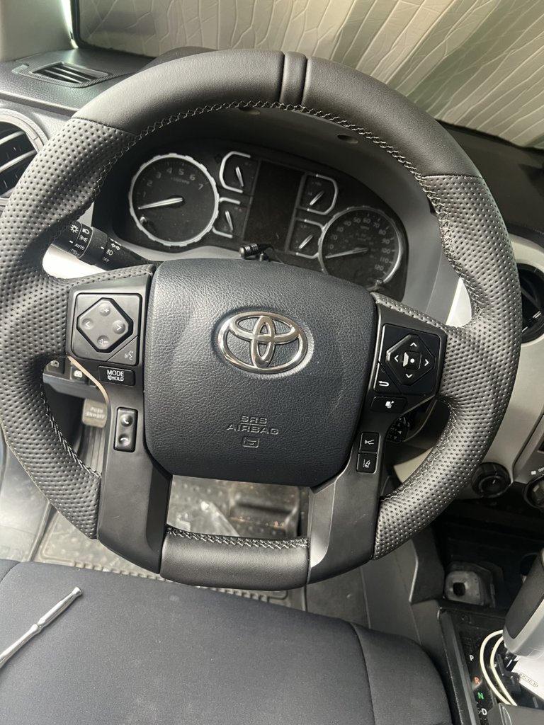

    So I installed the new steering wheel and now my auto headlight warning is on, the tow haul mode says it has an issue, the LDS system says it ain't working....I tried adjusting the clock spring by going all the way to the left then all the way to the right, counted 6.5 turns. When I go back 3.25 turns the clock spring isn't in the middle on the top, it is about at 10:00. Does it matter if I just put it at 12:00, it's only adding .25 to one of the directions. Would that cause all of the warning light issues? The horn works, the turn signals work, the auto lights come on/off....
