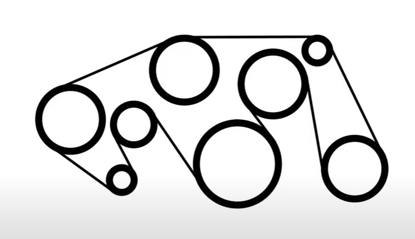

    FYI for those who need to know how the Belt is routed for the 5.7L engine.. here it is
