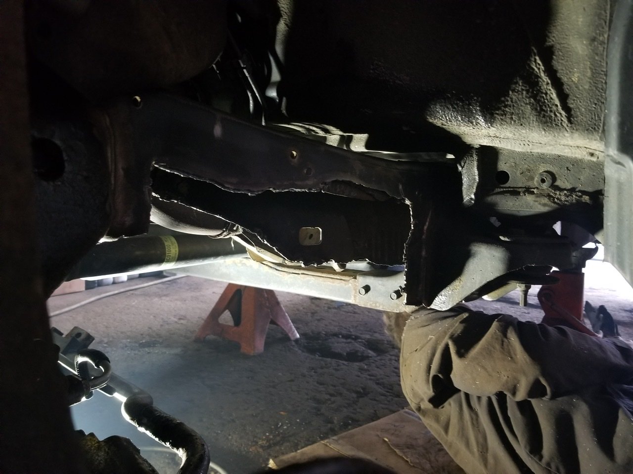

    I just picked up a 2004 Tundra 4.7L xtra cab at an auction. The body looks great, clean interior, no dash lights. I usually have decent luck but am thinking this was a mistake. I totally didn't see this until after the auction. From the sides the frame looks great when looking under the truck. Can anyone tell me if Toyota is still doing anything about these horrible frames and if so how do I go about addressing this issue if it's not too late?

    You're likely SOL. Sell it if you can.

    I figured as much. I was hopping for good new but don't expect to get it. I can't believe how clean the rest of the truck is. This is insane. I happen to know a great welder that can fix this but it'll be out of commission until he can find the time to do it. I won't sell it to someone else like this and have them stuck with the same problem.

    Your your VIN through the Toyota website but I would go see your local dealer first, (ask around for the most liked one!) to see if they may be able to help.

    Sorry man, that sucks. That is some bad cancer right there...

    That frame looks oddly clean everywhere except the rotted area. you could TRY to get toyota to do something. but seeing it was bought at auction you probably wont get anywhere.
    you could likely sell it full disclosure. theres people like me that'd buy a new frame and toss it under there.

    Its was clearly painted over, and rusted through from the inside.
    Crap. Thats bad. Sorry man. Best of luck. Sometimes you get the bear, sometimes the bear gets you.

    yea looking at it on the computer its been "covered up" phone it looked cleaner.
    sadly i see this alot when i have to tell someone who brought their "new" used truck in isnt safe to lift.

    This is the reason I spray PB Penetration all up inside that box frame about 2-3 times a year. The penetrant works its way all in those seams.
    Those frame laps trap moisture/salts/etc.
    The metals within the frames, the weld seam, and road salt themselves causes dielectric corrosion due to poor milling on these frames.
