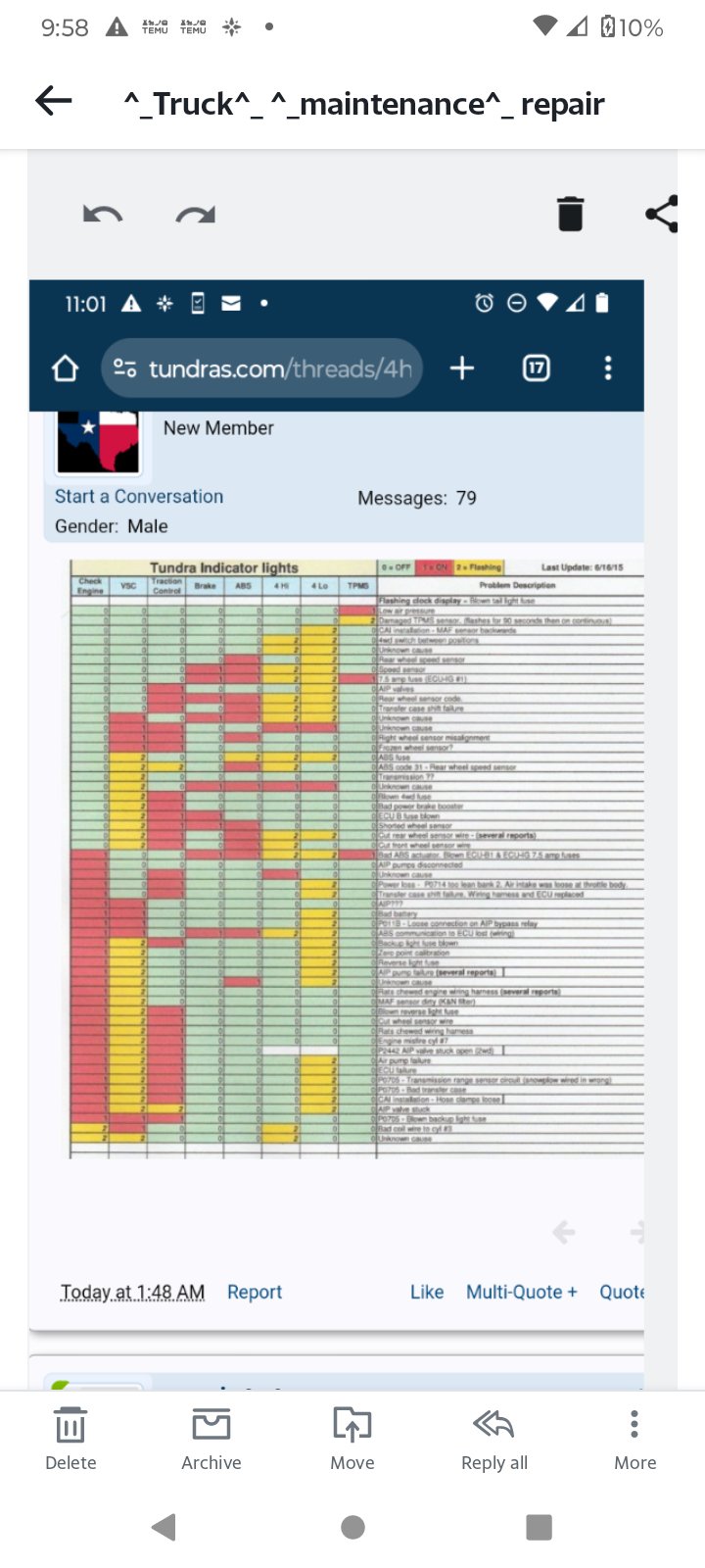

    I'm going to drop it off at a shop tomorrow that is close to my home, they only work on toyota and Lexus vehicles. When I left there yesterday to check on their services, a CEL finally came on, code P0500, vehicle speed sensor a malfunction. So they charge $ 165 for diagnostics to be run and then once I fing out what is the problem I can either fix it myself or have them do it, depends on cost. But they are reputable and the $165 would go towards the repair bill if I have them fix the truck. I did notice the speedometer didn't work until I started to brake for a stop and then the speedometer would work and stop again after I started driving again.

    Google search for this chart, maybe "Tundra warning light chart" or similar.

    Thank you for sharing. Also yesterday, when I would pull up to stop completely, the speedometer would come back on and the battery gauge would drop.back to normal and all of the warning lights that were on would turn off. Once I would start driv8ng again, the warning lights come back on and the battery light would come on and gauge goes to 19 volts high side. But when I would stop completely after driving, the truck goes right back to normal operation. I will update once I have an awnser, just hoping it's either something related to the speed sensors on the wheels or the one on the transmission, but the transmission shifts like it should. I don't want the cluster to be bad as I have found on some searches and YouTube and I don't want the alternator to be bad.
