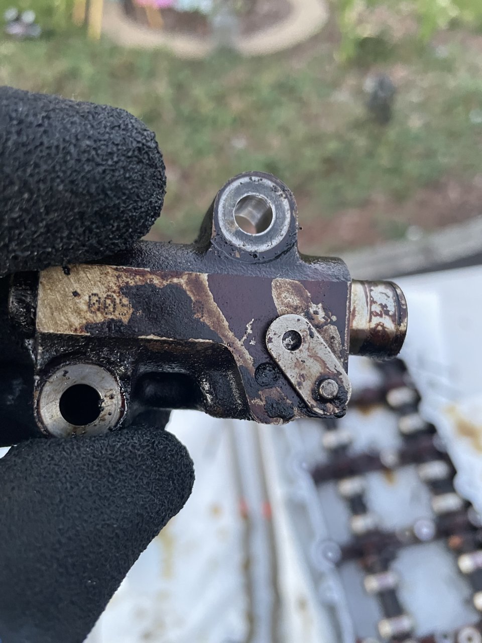

    Anyone have any ideas on mine? I have the same drivers side rattle that most of y’all have but it is only when warmed up, almost never cold.

    Best bet would be to take it in to Toyota - usually an experienced tech will be able to tell you what it is quite quickly. Might cost an hour of their time or so, but then you’d know what it is and be able to move forward.

    Good news! I already did that so I’m certain it is the drivers side tensioner. Thought maybe some 0w-20 and seafoam would might help

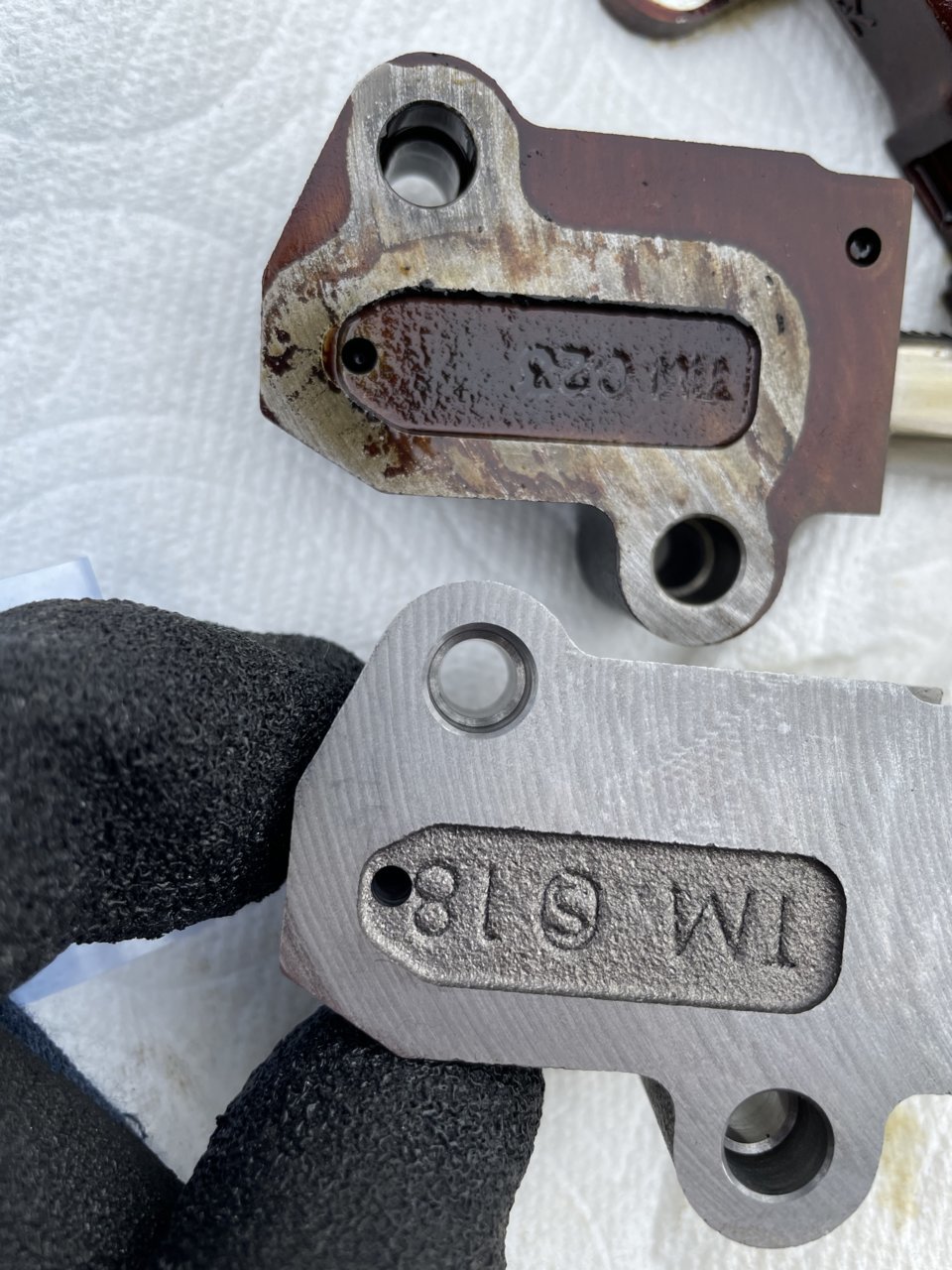

    My friend is a Toyota mechanic and I was just talking with him yesterday. If that’s the case he says that you should be replacing the tensioner. Over time the hard plastic the chain runs along will also wear out and then you’ll have a very loose chain which could jump teeth and then your timing is off. Could cause some serious damage in the engine like bent rods, etc..

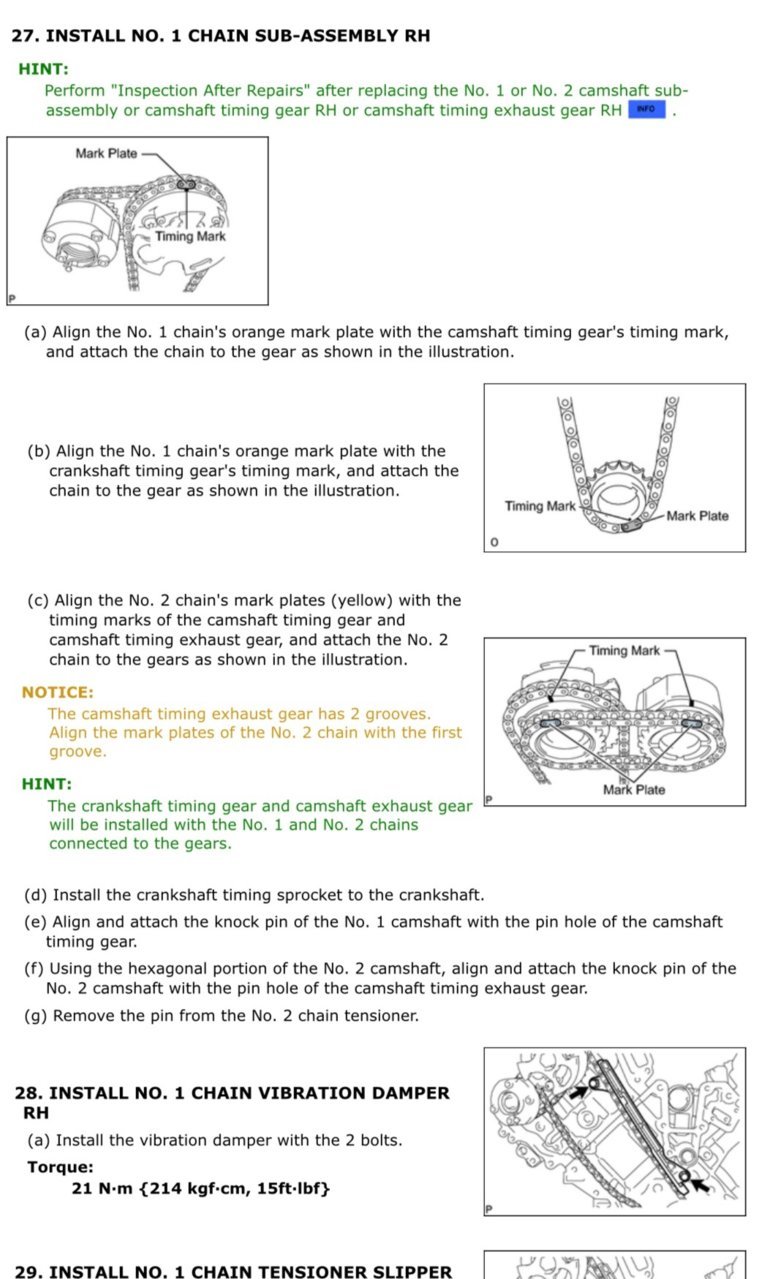

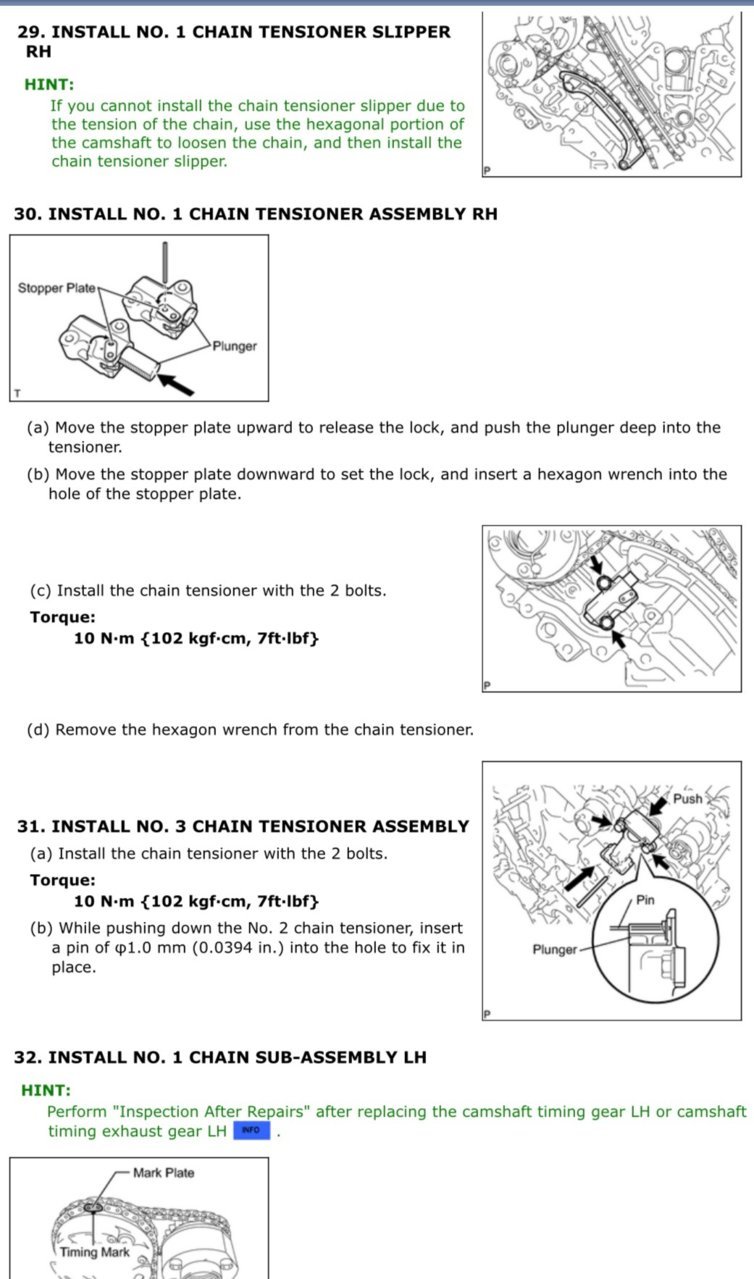

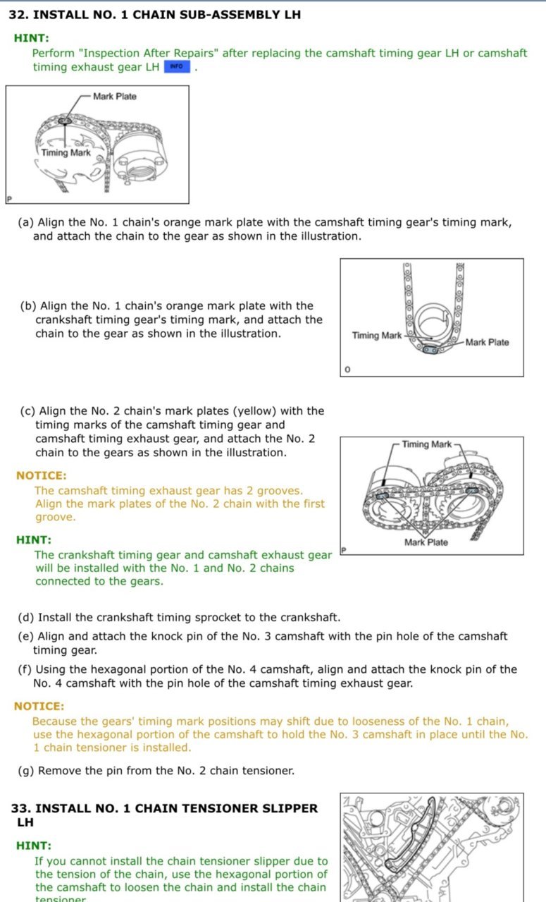

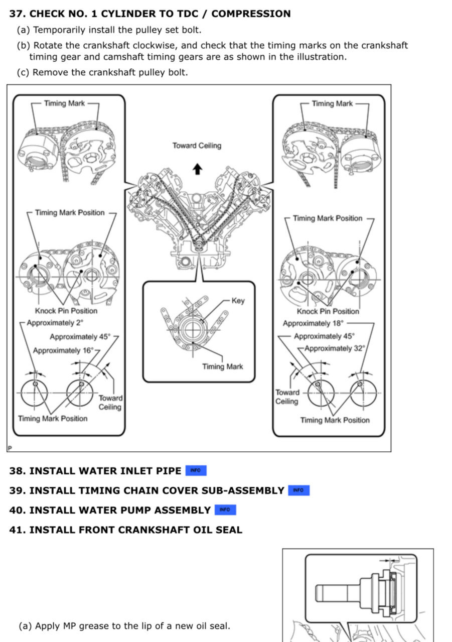

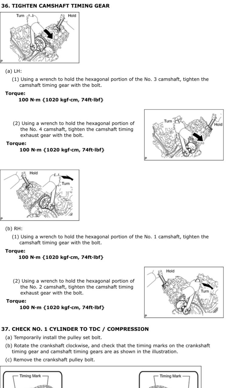

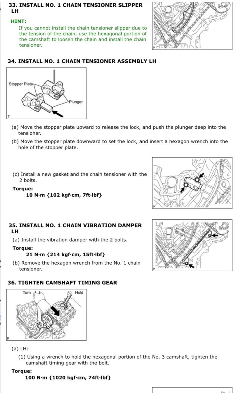

    It’s a pretty big job but it is doable. I’ve got mine all apart using hand tools only from one of those mastercraft kits. Only needed to borrow a 17mm wrench and made a tool up to break torque on the crankshaft pulley bolt (221lb/ft) I have a PDF I will post up direct from Toyota that gives the exact specs on installing new chains and tensioners and the proper cam angles, marker positions, etc.

    Doubt that Seafoam is going to help a lot due to distance in small orifices' that it would have to flow to reach the tensioner. First picture shows size of orifice. The oil has to flow through the small tubes in the valve cover before making its way to the tensioner. Second shows my sludged up and frozen tensioner. 140,000 miles on odometer. The "sludge" doesn't just wipe off either. New part has larger orofice.
