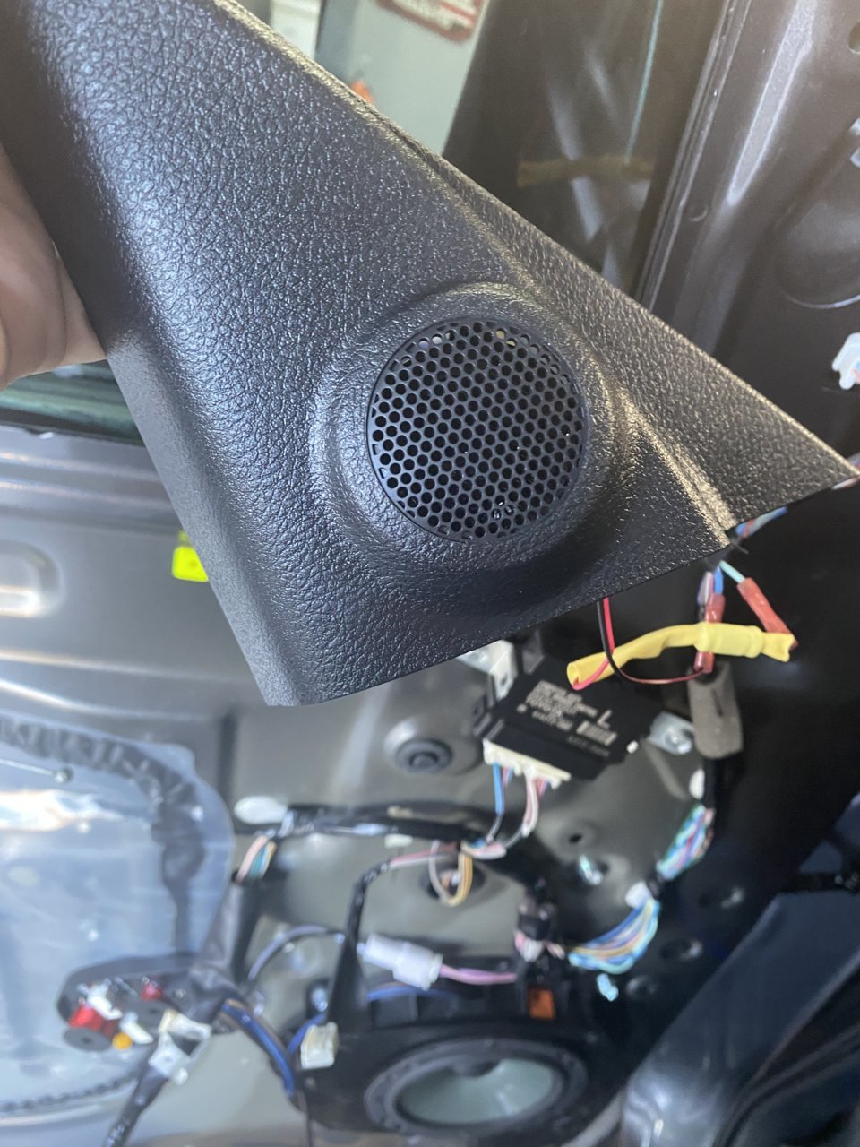

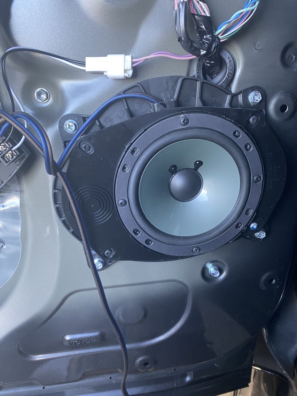

    UPDATE**
    So we ended up not replacing the head unit because we found this is not the issue. Upon removing one of the tweeters from the door it turns out it is aftermarket along with separate wiring. Looking through the driver door the original 6x9 JBL was also replaced telling me that there was an aftermarket amplifier installed and removed via the previous owner. With that said, I will be taking the truck apart this weekend to see if I can’t wire everything to the factory amplifier and see if it fixes my overall problem.
    If I can find where all the wiring is running to and how everything is currently setup, I might benefit from just purchasing an aftermarket amp and hooking everything up to it.
    Fortunately, I was able to track down information on the previous owner and will be reaching out to see if the factory parts are available to retrieve… swap for swap If possible. More to come on this whole thing.
    I’ll also be contacting the dealership I purchased from to see if they can make it right because I purchased the vehicle thinking it was the original JBL system and not a modified system.

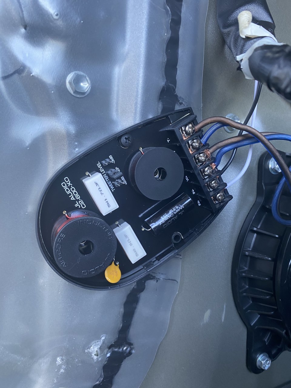

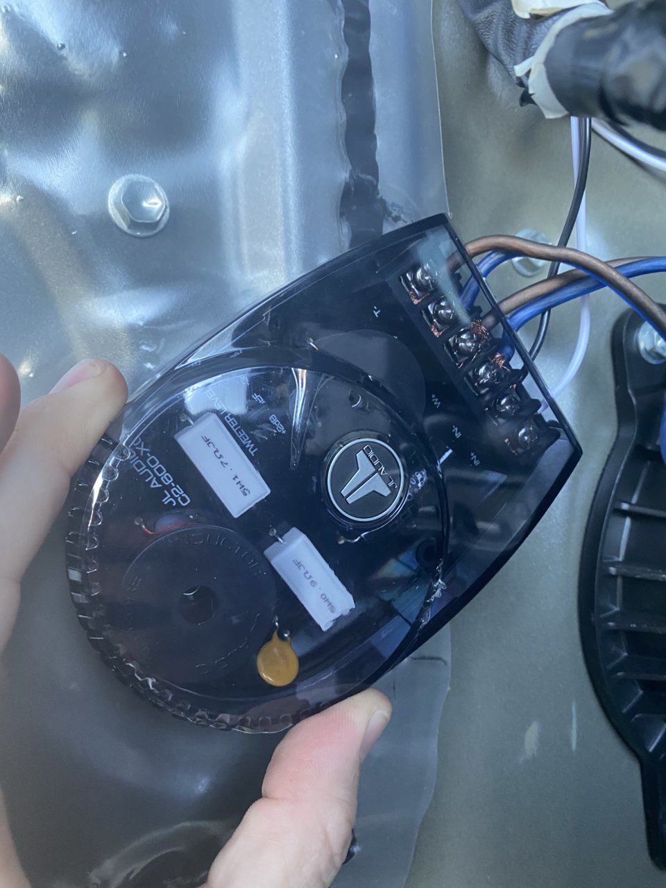

    NSV Lightbar, center console wireless phone charger, Ultra Flex bed cover. Smoked tail lights and third brake light. Many mods in the near future.
    So this is left behind, JL crossover with JL door speaker and tweeter. There is evidence of an amp swap from the copper shavings left from stripping cable near the factory amplifier.. seems these were ran along the factory wiring so this is probably why there is hardly any sound if they’re currently running off the stock JBL amp. looks like I can just get the aftermarket amp that would coincide with these and run it. I’d honestly prefer having it stock and upgrading myself but I might be able to work from this…

    Those at least look like nice components. Getting an amp and correct line out converter in place should help.
