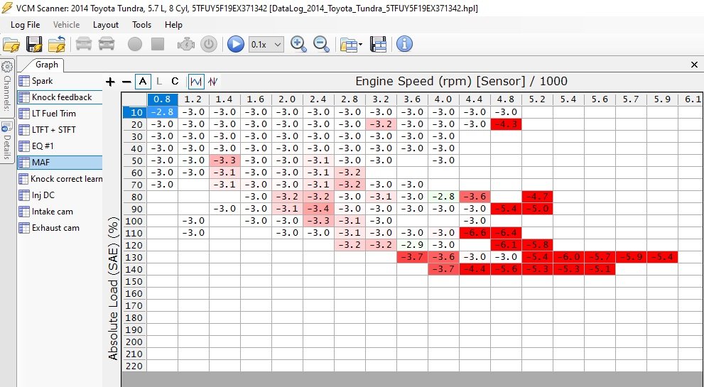

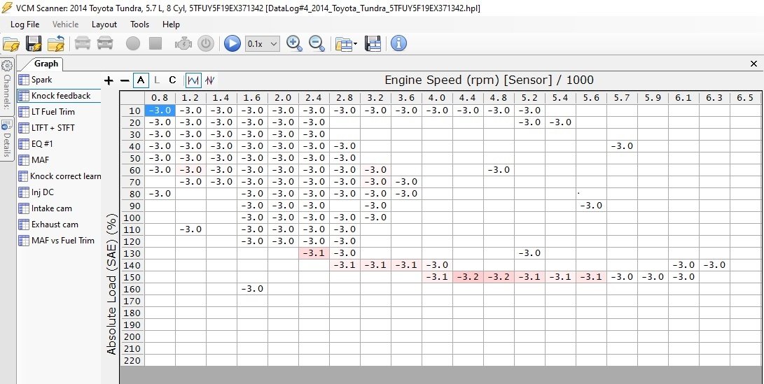

    Here is another example of the difference between the canned Magnuson tune and the custom remote tune on a 2014 non-flex fuel Magnuson supercharged Tundra.
    The graphs show how much ignition timing is being pulled in response to engine knock.
    The first one is of the stock Magnuson supplied HPTuners RTD tune, the second one is the custom tune after a few revisions.
    -3.0 degrees is baseline (no ignition retard due to knock), anything more negative than that means the knock sensors are picking up pinging.
    You can visually see the difference (red is bad, white/green is good).
