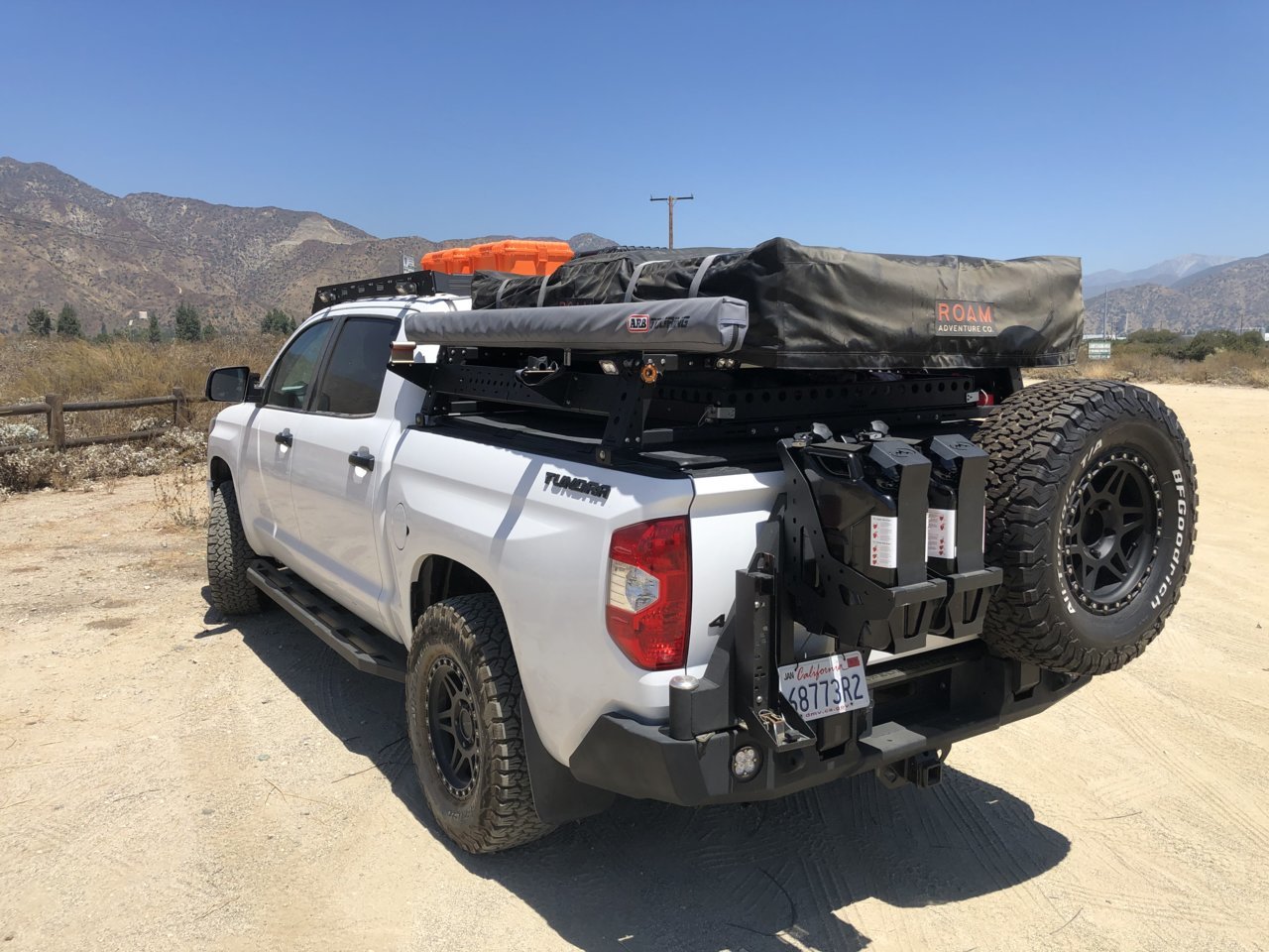

    Glad you’re done... Maybe you should’ve never got started since you don’t have balls to drill a hole on a $50K truck; in my case I’m more like $65 rig. Stupid me I did 95% DIY install on this truck. Hope it doesn’t fall apart on me because I don’t know how to use a drill bit. One day I will learn how to use a damn electric tape to stop bits. Sorry buddy if I hit a nerve.
    PS Heavy suspension and electrical work not pictured.

    That RTT tho-! :wave:

    Are u an RTT dealer :boink:

    The best purchase I ever made... even the wife loves it. Will always be thankful @Sunnier.
    Always been wanting to join you guys but I’m still working on my rock crawling skills.
